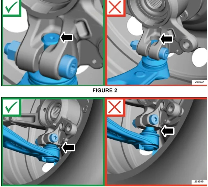

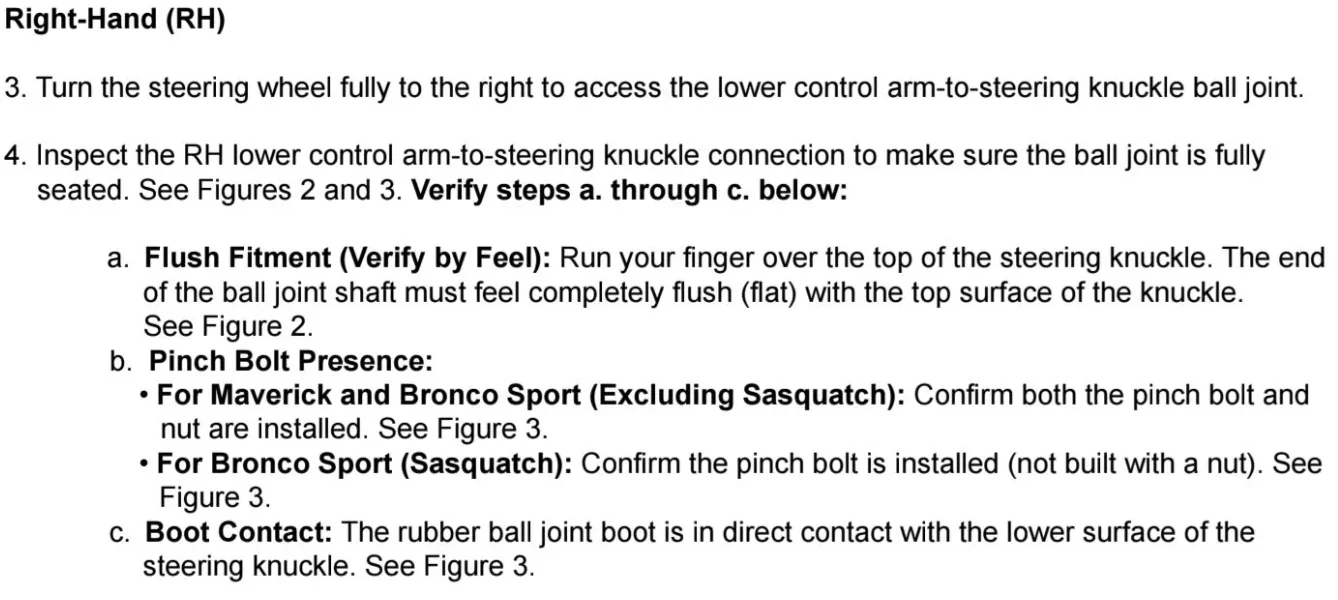

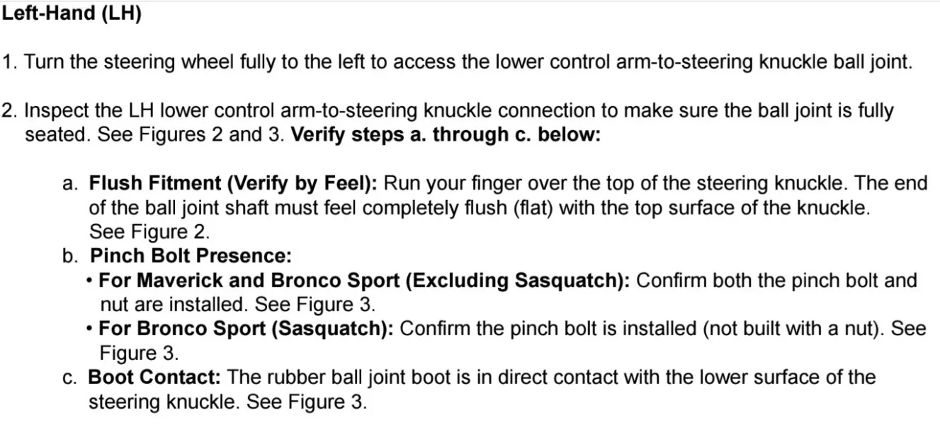

A Ford Tech on Reddit posted exactly what needs to be examined and what the issue is. Credit for these images goes to Reddit user "Executioner7447"

I just got under my Bronc, at lunch, and looked at this. I am good. Thanks for the photos!
