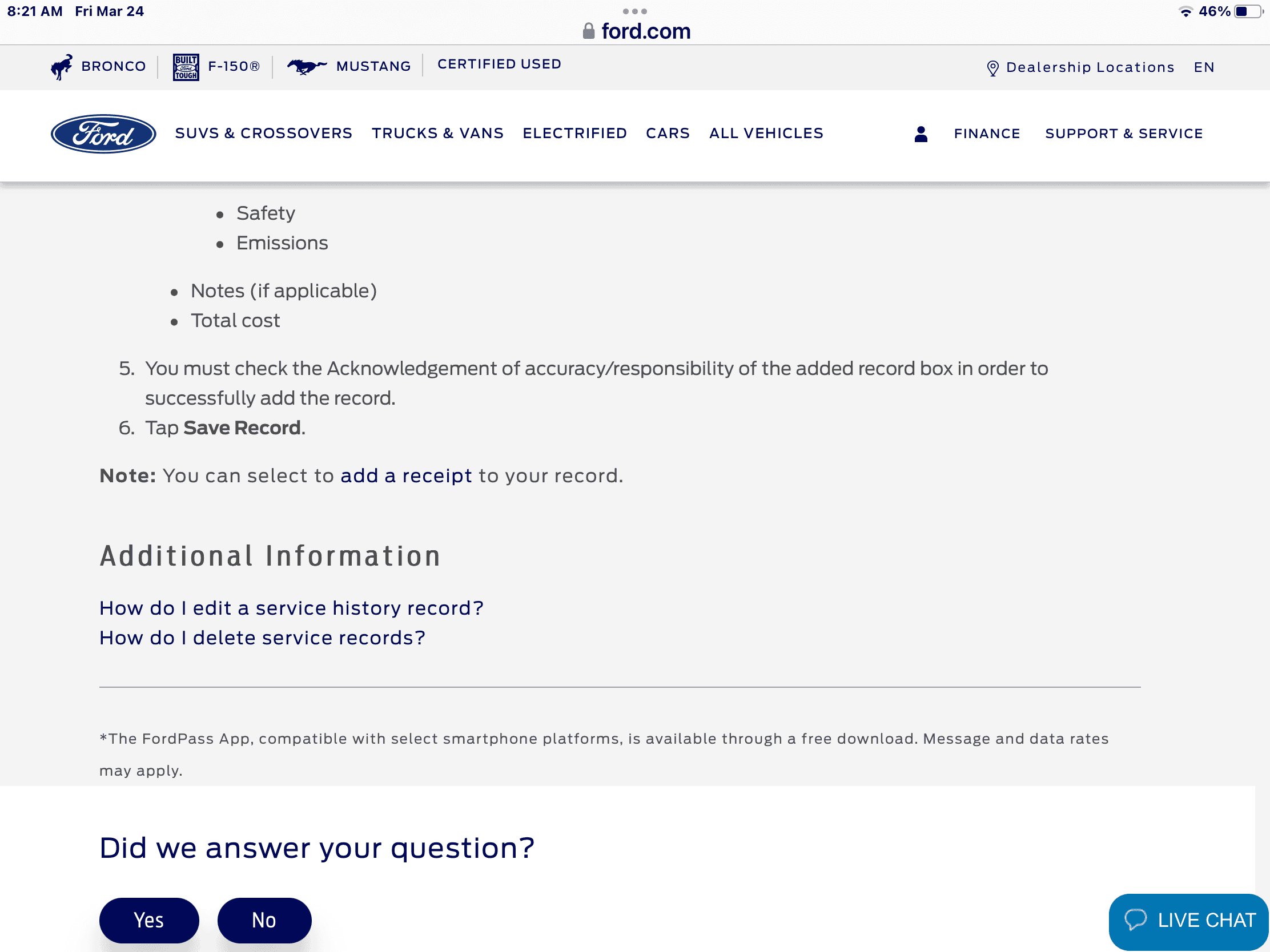

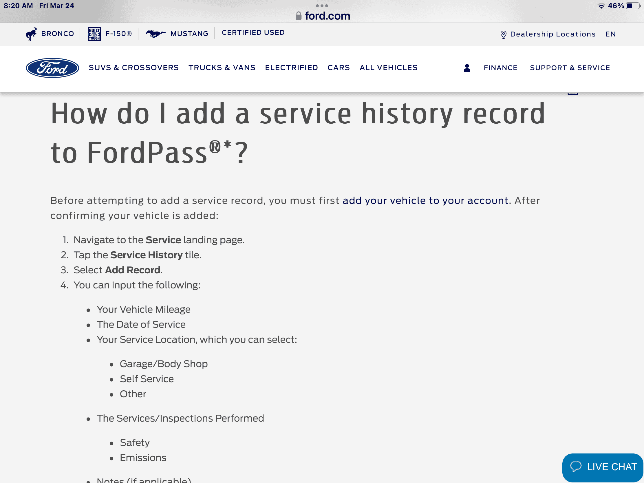

I found this .
Ford Bronco Sport Ford Bronco Sport Badlands  How To Change The Oil Video 32BB50A3-542E-42B7-AC81-FC19AB7819F6
Ford Bronco Sport Ford Bronco Sport Badlands  How To Change The Oil Video 54691C9D-7540-4EBC-B21E-F9EFCB051D1B
Ford Bronco Sport Ford Bronco Sport Badlands  How To Change The Oil Video B9BFAD76-C30E-4543-8A47-2C854E93B252

I found this .
Thanks Jrl.

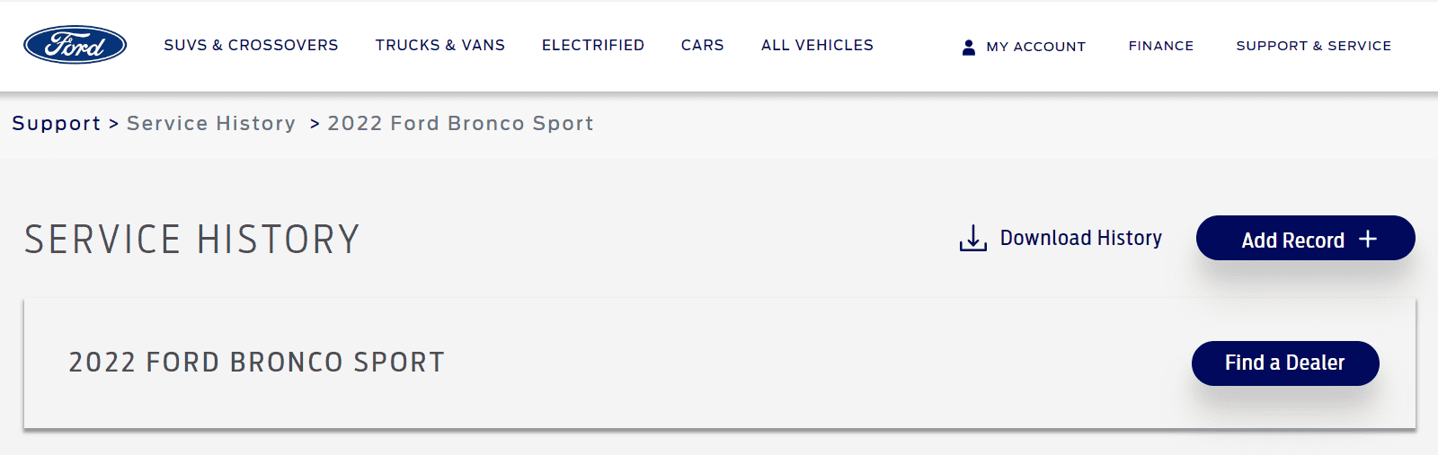

That's essentially what I did:
"Support>Service History >2022 Ford Bronco Sport"
Then my VIN was auto-filled and the screen looks like this:
Ford Bronco Sport Ford Bronco Sport Badlands  How To Change The Oil Video 1679688524141

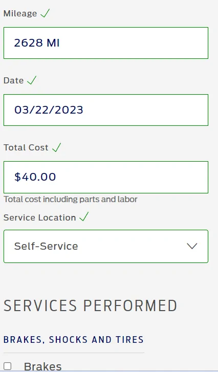

I clicked on "Add Record +" and saw this (partial image):
Ford Bronco Sport Ford Bronco Sport Badlands  How To Change The Oil Video 1679688831426
There's not much more to it, except clicking "oil change" under "scheduled services"; your notes (I listed oil and filter used); and the box that indicates you agree that Ford is not responsible for anything, ever.
Then click submit. I just did that and got the same error message:
"Oops! Something went wrong adding your entry. Please refresh and try again later."
I'm surprised they don't say: "Give up and go to your local Ford dealer."

More info on service record entry.
According to this thread, the "adding a service record" feature has been discontinued:
https://www.bronco6g.com/forum/threads/fordpass-app-removes-adding-a-service-record-option.60950/
There is not 100% agreement that's the case, but the OP said 2 different CSRs told him the same thing.
<Later> I just used the FordPass app on my phone and it worked. Now though, I cannot see the complete record (on the phone) -- only a page that has 2 options: edit record, or delete. I clicked on edit and the rest of the entry came up, but there is no record of the VIN anywhere, which seems strange.
Now I see that what I entered using FordPass on my phone is showing up on the webpage:
https://www.ford.com/support/service-history/
I tried to add to the notes using my laptop (I hate typing on a phone so I cut them short). At first it looked like I was going to be able to but when I clicked "Submit" I git the dreaded error message.
Other than that, the record is complete, although for oil I just wrote "Mobil 1 5W30 API-SP" (and Motorcraft FL-910S for the filter).
