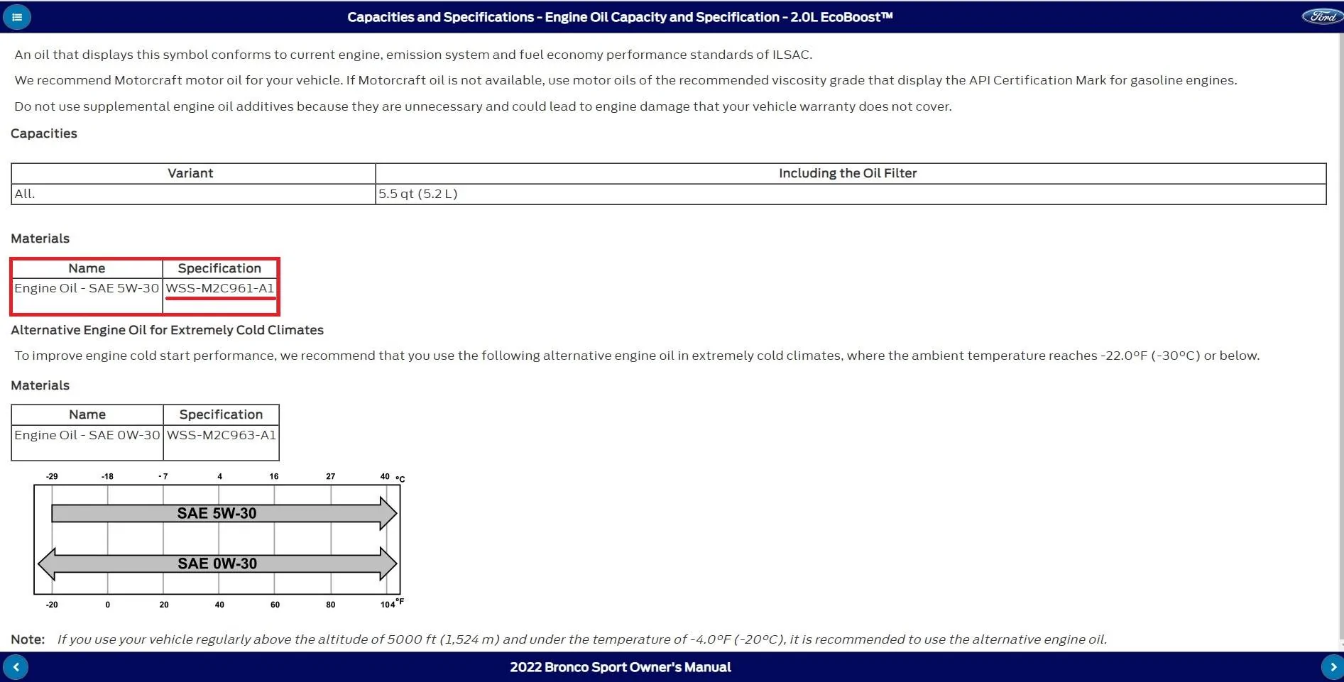

Sorry to say but Mobil 1 does not technically satisfy Ford's requirements. If I were you I would double check the specs on your Mobil 1 if you purchased it from Costco but even Mobil's own website will not recommend Mobil 1 for anything other than the 1.5L engine. Ford updated their oil spec requirements to help abate low speed preignition issues as well as to help with timing chain guide wear and many oils out there currently do not meet these specs. This is something people should keep in mind when doing their own oil changes.

Thanks for the heads up -- I'll check it out.
<Later> I'm confused because this 5W30 Mobil 1 meets API-SP but the Ford approval # does not match what is in my owner's manual:
https://www.mobil.com/en-pis/passenger-vehicle-lube/pds/ap-xx-mobil-1-5w30
I could understand if it was API-SN (say), but I've never heard of an auto mfr requiring not only a certain viscosity and API category, but also only certain *brands* of oil with that spec.
Is that the situation? We can't buy any 5W30 API-SP, it has to be specific mfrs?
You wrote:
"Ford updated their oil spec requirements to help abate low speed preignition issues as well as to help with timing chain guide wear and many oils out there currently do not meet these specs."
That's definitely true, but my understanding is that any API-SP oil does what you listed -- "...help abate low speed preignition issues as well as to help with timing chain guide wear...".
EDIT: I re-checked the page I linked to above and realize the reason for the confusion -- that oil is NOT API-SP, it is API-SN+. I have no idea why I thought it was SP.
So IOW, 'Never mind'.

There are 5 flavors of Mobil1 5W30 listed at the "Product Guide" link on this page that have the correct Ford service fill approval (xxx 961-A1):
https://www.mobil.com/en/lubricants/for-personal-vehicles/our-products/products/mobil-1-5w-30
I believe only the extended performance meets Ford's spec for the 2.0 in your badlands. The normal Mobil 1 (the only type sold at Costco) does not meet that spec. I highlighted the specific spec straight out of your owner's manual. You need to look at the data sheet for whatever oil you choose or the bottle to make sure it meets that specific WSS requirement
It's precisely this kind of (intentional?) confusion that prompted passage of the Magnuson-Moss Act. Manufacturers are expressly forbidden from "tie-in" sales provisions that state or imply that a consumer must buy or use an item or service from a particular company to keep their warranty intact. The "specification" listed in the manual is a Ford specification, not an industry specification, and under the act Ford cannot require you to use it. This is why your owner's manual contains the following statement under the section titled, "Oil Capacity and Specication."
We recommend Motorcraft motor oil for your vehicle. If Motorcraft oil is not available, use motor oils of the recommended viscosity grade that meet API SP requirements and display the API Certification Mark for gasoline engines.
The highlighted section in the above quote defines the oil requirement for warranty purposes. If it's an API-certified 5W20 oil that meets API's SP standard then Ford cannot deny warranty coverage. Any attempt to do so by Ford would be a violation of Federal law.
That's exactly what I did -- looked at the Mobil 1 data sheet, and found five types that meet the WSS requirement.
The Mobil PDF I linked to above lists 5 types of Mobil 1 5W30 that meet the Ford "spec" (xxx 961-A1) listed in the owner's manual: Truck & SUV; Mobil 1; Mobil 1 High Mileage; Extended Performance; and Extended Performance High Mileage.
As for whether any of those are currently sold at Costco, I have no idea. I mentioned Costco in my previous post because I have purchased Mobil 1 there over the years, and their sale price is an example of how inexpensive it can be (compared to other oils, even conventional).
If Costco has it, great. If not, it doesn't matter to me where I buy it (locally or online). It's nice to know there are 5 options within the Mobil 1 line.
