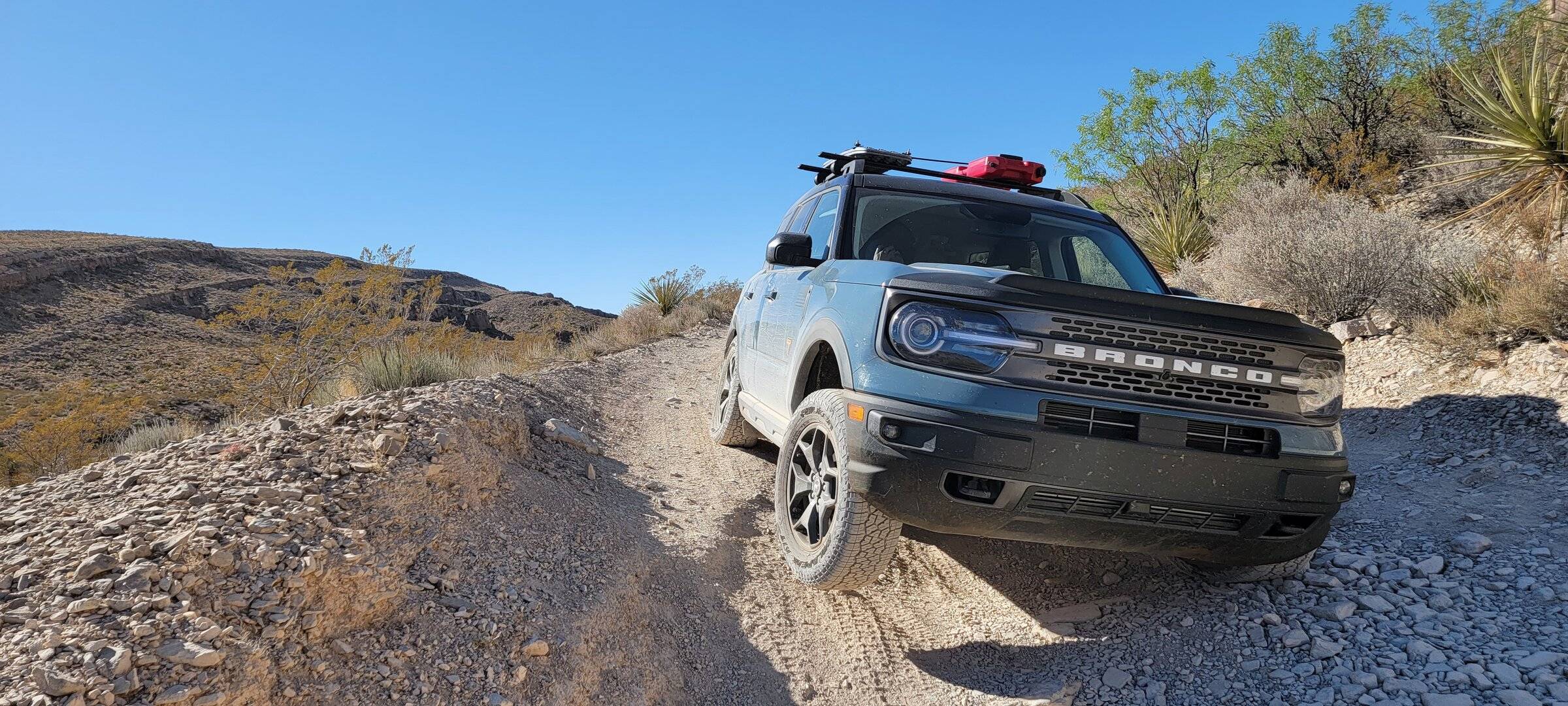

I recently took my BSBL through Black Gap, N to S, in Big Bend NP. With a little prayer and skid plate tears, I made it though the Gap. That being said, I ended up straddling a significant portion of preceeding trail, simply because I needed maybe +0.75-1" clearance to comfortably cruise the center of the trail. I did not leave confident in our BL capabilities on future more technical trails, but am convinced the ground clearance is our first significant bottleneck.
Admittedly, we were hauling gear. 52qt cooler, 5gal of water and 5gal gasoline, camping gear for 2 people, basic recovery gear, air pump, and tools. I tore up the fabric undercoat, as expected (Ford, I know you're asking yourself why you decided to line the underbody of an offroad focused CUV with paper mâché...), and the front bash plate got intimate with a fist sized rock, but everything else is cosmetic (including permanent cactus pinstripes on all the exterior black plastic, paint is fine).
Winter Soldier, or Bucky as he prefers, is my daily driver. I live in GA, so he is also my cross country crossover to get out west or up into Appalachia. I expect to drive his power train well into the 100ks+. He will get larger tires as well in his post-lift life, currently running the OEM option 235/65/17.
I'm new to aftermarket modification world. So correct me if I am wrong, but this does look like a first of its kind product for the BS (particularly the BL).
Is the GR plus a good option for me? Should I wait for the lite? Is the GR40 something I should consider? Can I help in any way?
