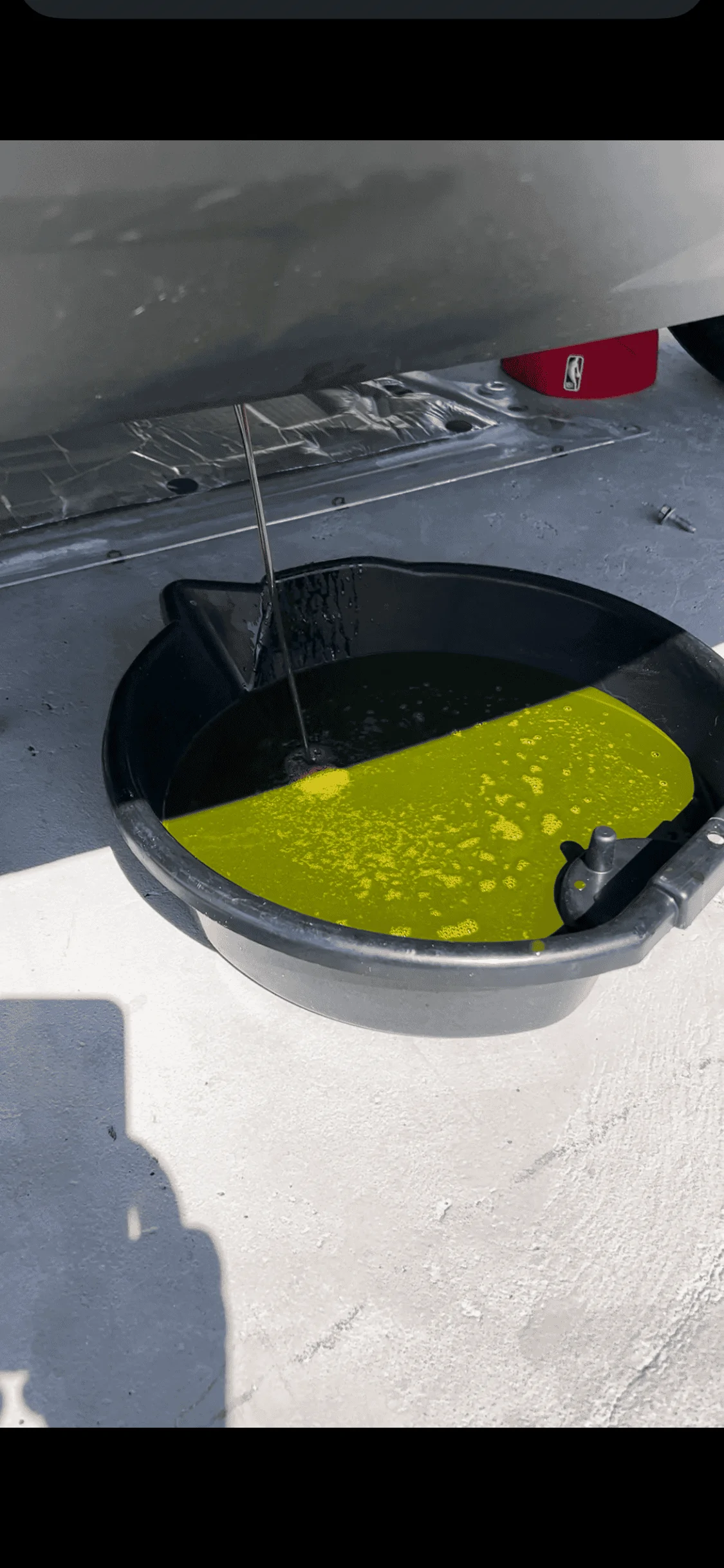

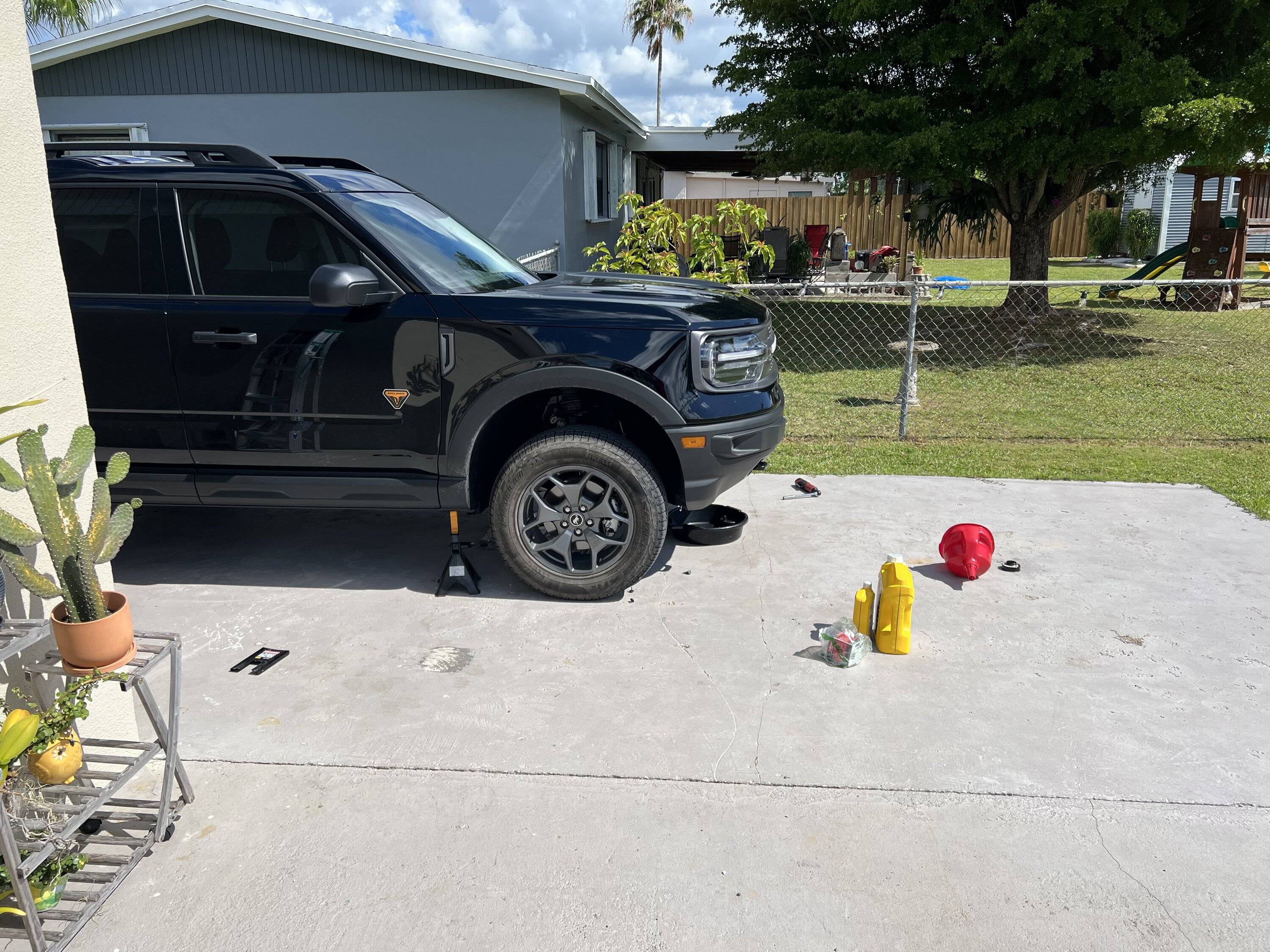

So I wanted to dump that OE straight from factory synthetic blend as quickly as possible. Honestly, I did not find the plate all that difficult to deal with. The fact that the rear bolt holes are 'slotted' makes all the difference. I enjoy that this is only 10 bolts/screws to undo in order to do the oil change, rather than the 16 on my Mustang. The location of the oil filter over the front bumper looks like it will make for a mess each and every time. Anybody find a nifty solution to avoid the oil splash all over the place?

Piece of cardboard formed into a shape that will keep the oil off whatever you want to keep it off of and drain into your pan.
I'll see if I can fashion something out of cardboard next time. I honestly thought I could use one hand to hold back the bumper, while I unscrewed with the other, but that didn't work out as well as I imagined it in my mind 😅 .

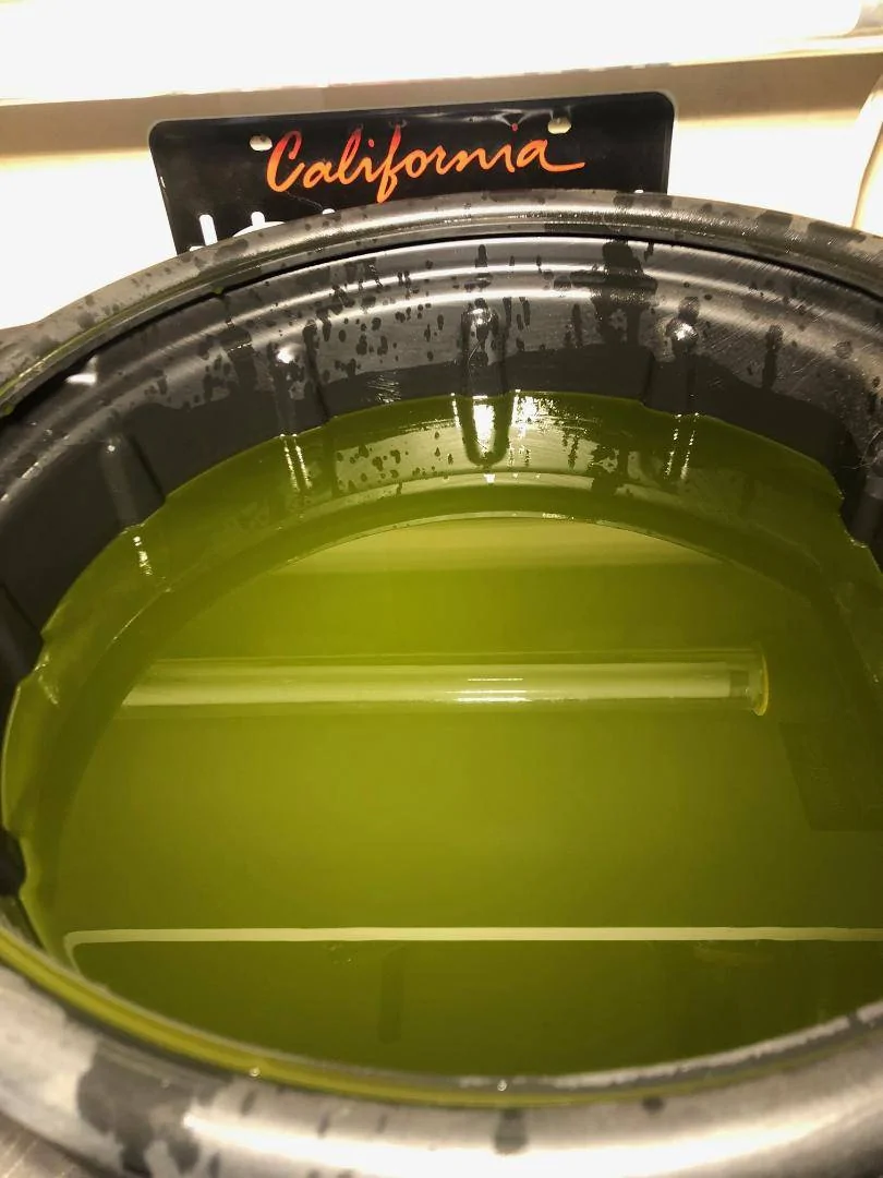

Your oil looks like it has a green tint to it like mine did when I did my first oil change.
Ford Bronco Sport First Oil Change Thoughts on 2.0L EcoBoost Engine bronco sport green tint in motor oil1
Yeah, it looked strange to me too, but I chalked it up to it being the first time I've ever changed fresh oil. Usually GDI engine oil is black after a thousand miles or two, from all the soot it soaks up.
Maybe someone else can offer up an explanation. I googled it a bit, and it seems to be that many oils have a green hue. So I kinda just chalked this up to me never seeeing fresh oil all pooled out like that.
I've done a lot of oil changes, some with relatively clean oil, and I've never encountered this. I sent a sample to Blackstone Labs and the oil checked out okay. I've chatted with some Ford tech's online, and they seem to think it's a dye from the factory to check for oil leaks.
Awesome! Yeah, I sent away for my Blackstone kit last week. Hopefully it will be here soon. I think its going to be great to get a 'baseline' reading of what the engine was doing straight out of the box.
