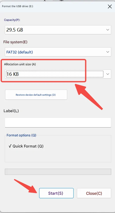

2. Prepare a 32GB memory card, connect it to your computer via a card reader, and format it to 16KB as shown in the attached image (Note: When formatting, select the FAT32 file system and set the allocation unit size to 16KB);

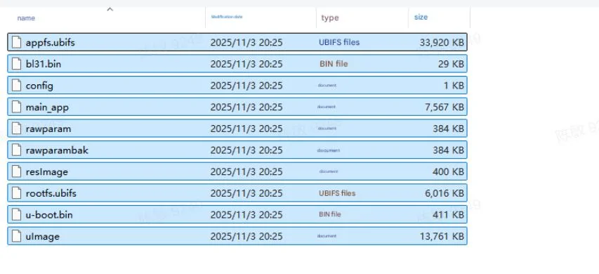

3. Keep the memory card connected to the computer (or reconnect it via a card reader), and copy all downloaded firmware files to the memory card. Refer to the attached image for instructions;
