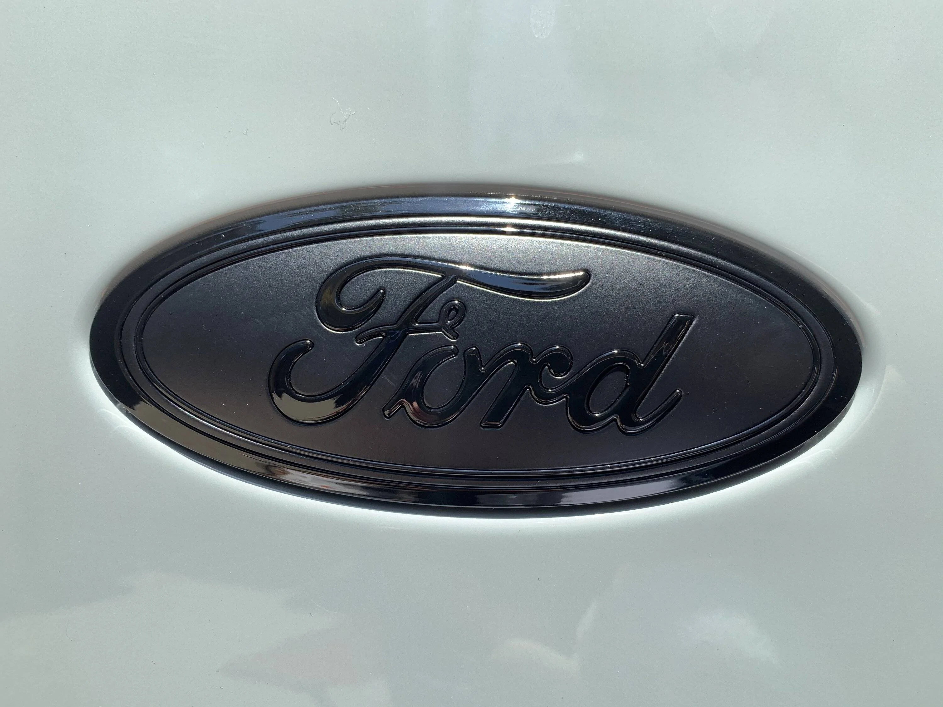

I finally got around to actually replacing the back emblem instead of using an overlay. I ordered it from emblemcity which paints oem emblems directly from ford. This is the final result

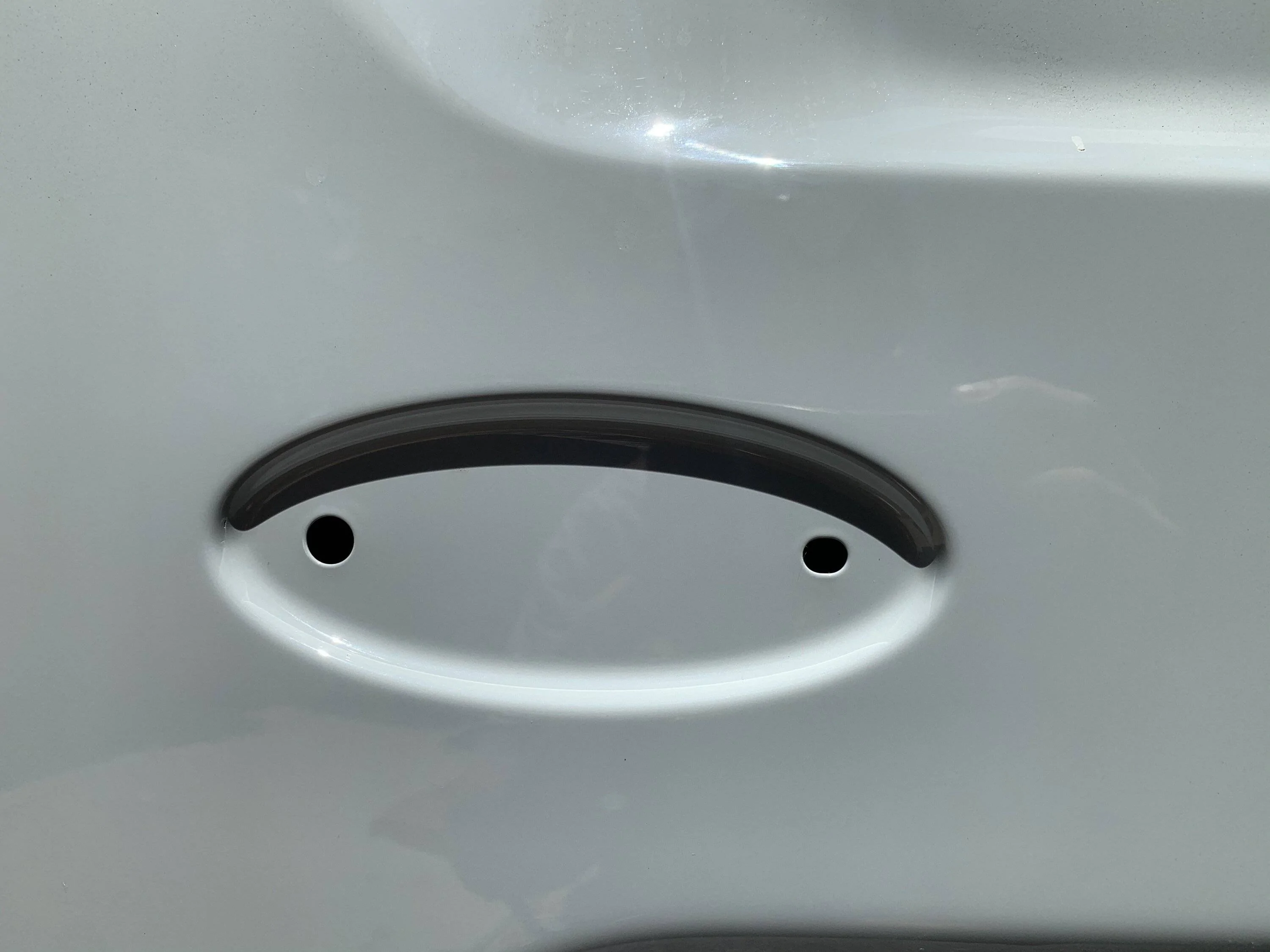

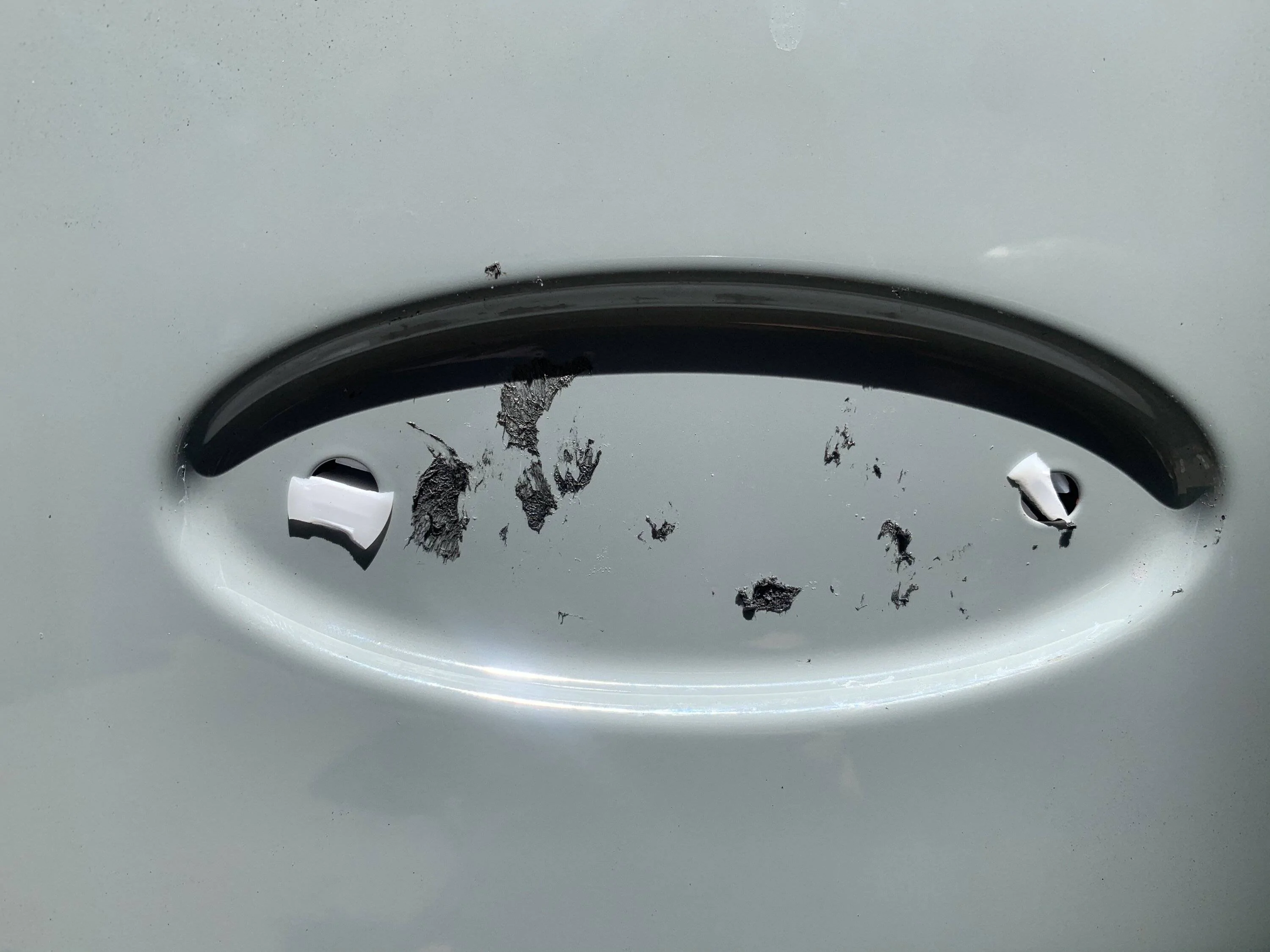

it doesn’t come with instructions but it does come with the removal tool. what I did was heat up the emblem for a couple of minutes with a blow dryer to loosen up the adhesive before inserting the pry tool. it will slowly start to come out as you work around the edges and as it becomes loose you can start to wedge the tool deeper into the back until you can see the two clips. at this point i was not sure which way to proceed , if i could’ve applied pressure to each one while pulling it order for it to just pop right out...
so i got a little impatient and forced it out which left these tabs in and i used some needle nose pliers to pull them out. i did not care to preserve the emblem since i was putting in a new one, and i was not trying to remove the back panels behind the door just to push out those clips. after i cleaned it up and let it dry out before popping in the new emblem

i’m glad i changed it out ! i was uncertain of how easy or difficult it would be but it wasn’t bad at all
