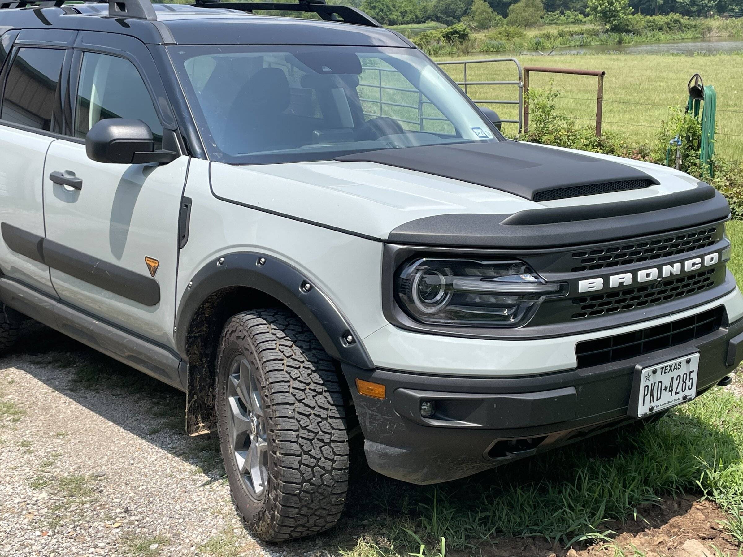

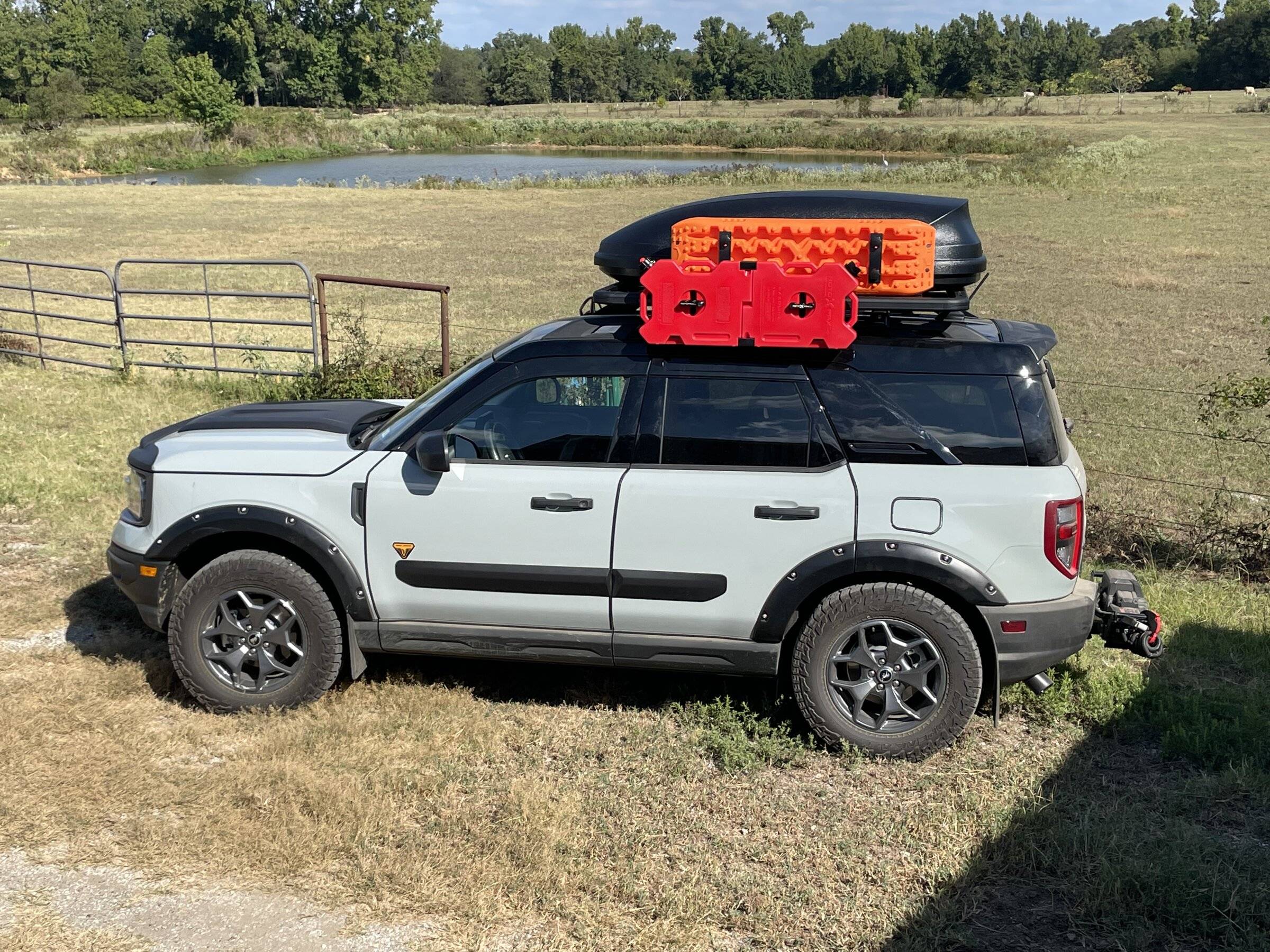

These are the Bushwacker Fender Flares. I did do some re-gluing of their internal supports to keep them flush to the BS Body. They also use Spring Clips to attach them to the Inside Fender Lip. (wholly inadequate) I lost the left front on the interstate one day. Bushwacker was NOT very responsive, but Ford took care of it. I have now attached ALL of mine with 3/16 Stainless Rivets. All in all, I’m very pleased now.
Hope this helps some.

Thanks, looking sweet

Question please,
How much has that added weight from roof rack with gear and rear winch assembly compressed your suspension?
Have you lost some of the assistance from the shocks and coils on uneven surfaces?

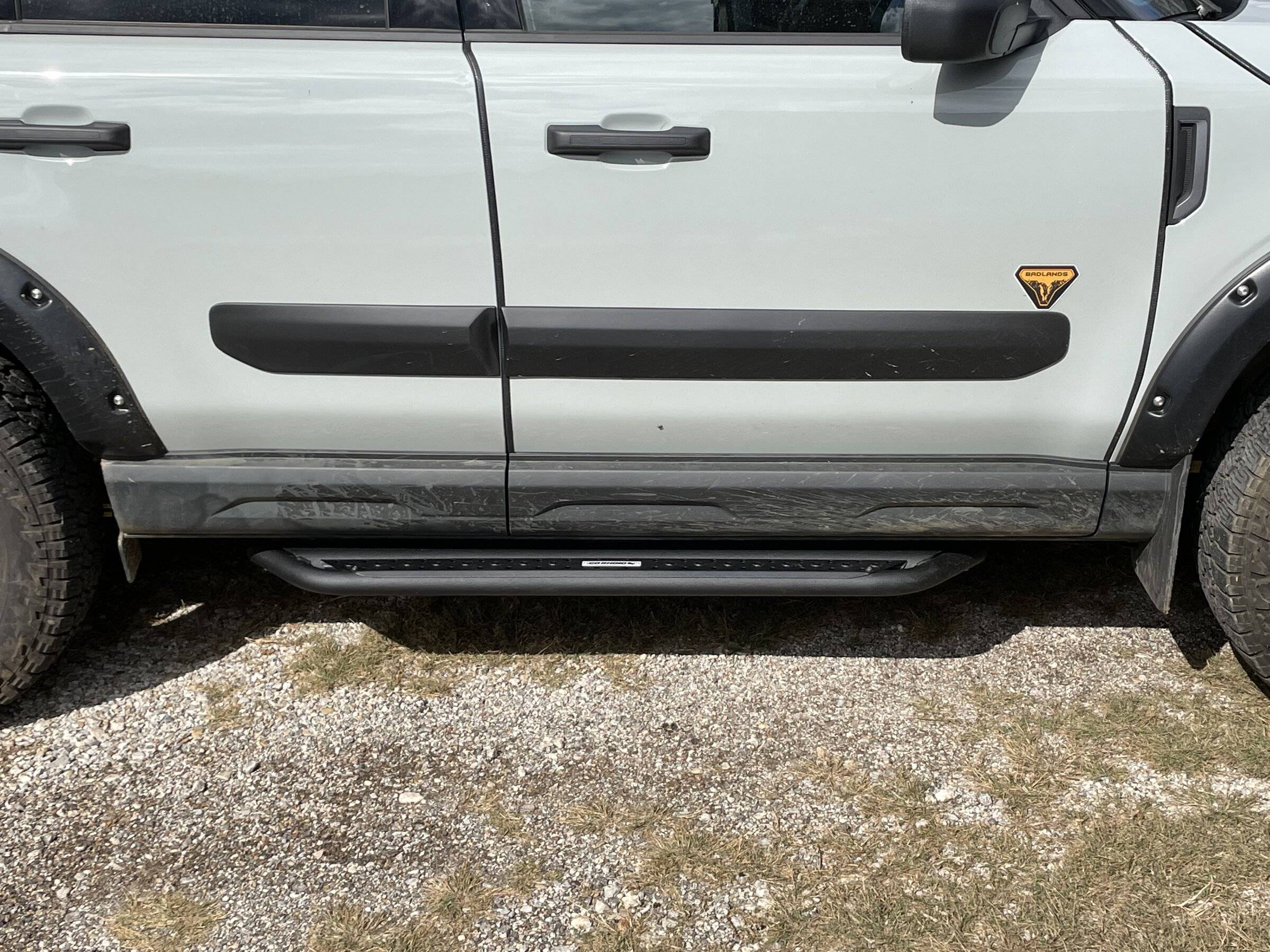

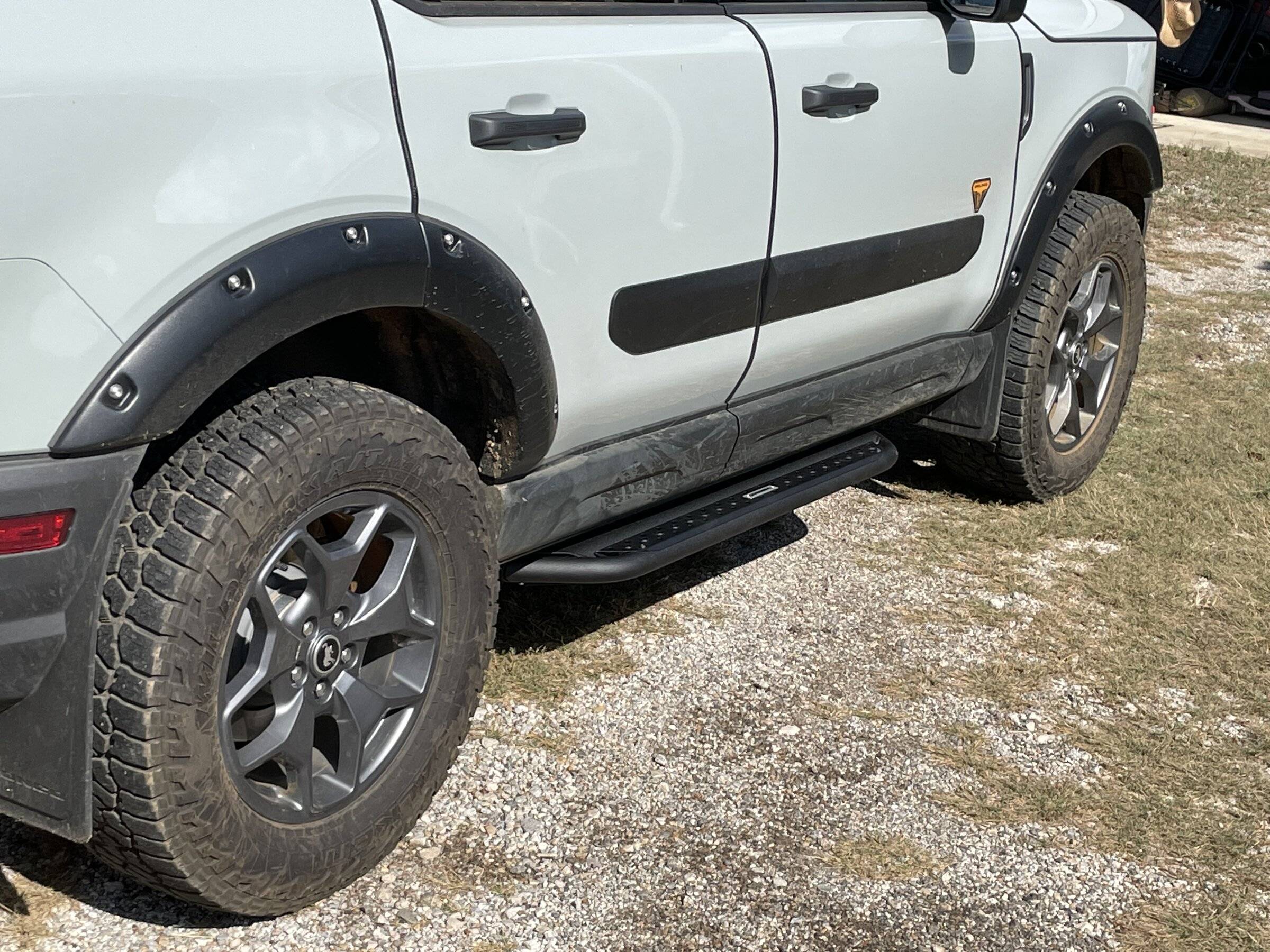

I have a 2” lift on her and Off-Road a lot. I haven’t had any Handling or Clearance issues at all. She is very nimble and sure footed and if you choose your line appropriately she’ll go just about anywhere.
The winch is going to eventually end up on the front. I’m retrofitting a Bull Bar and receiver for it.
I retrofitted some Rock Sliders not long ago and am still at about 11” of Clearance.

You used the stainless steel rivets in place of the clips?. If possible can you take a pic?.

Following. I had Ford install my bushwhackers, and they only appear to have clipped in the first and last clips on each fender. I have a gap on them all and if pried off a bit I can actually see the full clips in the middle, clearly not clipped in at all.

Looks good! What lift kit did you get?

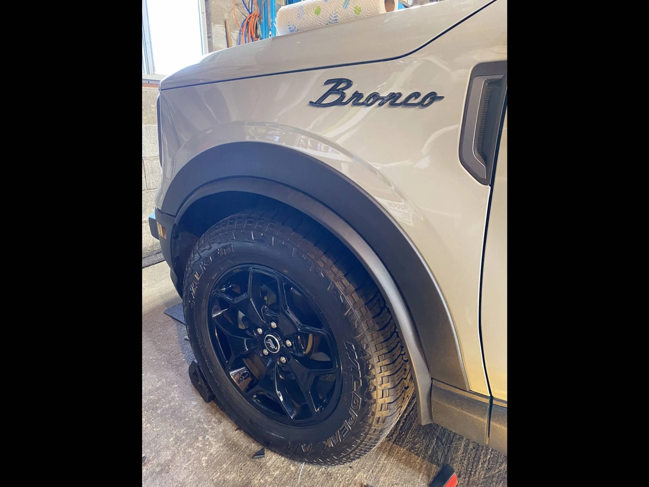

This is my version of fender flares / mud guards combo. Easy flares. Com

Did you install this body side molding or did come from the factory?
If you installed it, was it hard to do? Thx!
