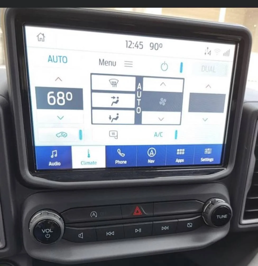

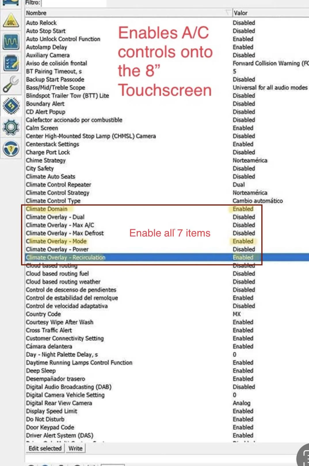

Wild idea, but what you're trying to do is mess with the Sync settings. I think what needs to happen is that you need to hit those buttons on the Sync screen. Now, you might ask, how? Yeah, you can't. Ford inexplicably hid the Climate screen from us. Now, I know some people have managed to use ForScan and re-enable the Climate screen (something I plan to do as well). I wonder if maybe, just maybe, using that procedure on the Sync controls instead of the hard buttons would have that effect.
More frustrating to me is that there seem to be a TON of valid Sync commands that simply do not work on the BS Sync or have been taken off the command list. Example : "Climate... Fan Minimum". Best I can seem to manage is if the AUTO climate is on I can use "Climate... Set 68 degrees" (in freedom units of course).
Maybe someone that has "Climate" on their BS can attempt to verify the fan reduction preference exists?

That’s a great suggestion and you may well be correct. To remind others, here is the Climate screen enabled via FORSCAN. I have not done this yet but now I’m motivated to make this FORSCAN mod to see if using the button procedure on the Climate screen will disable the automatic fan speed reduction feature during voice sessions. Thank you for this most excellent idea!!
And I share your frustration that many valid Sync commands do not work on the BS Sync or have been taken off the command list. Documented in the Owners Manual and documented on the SYNC3 help screen itself however a slew of commands are not available.
