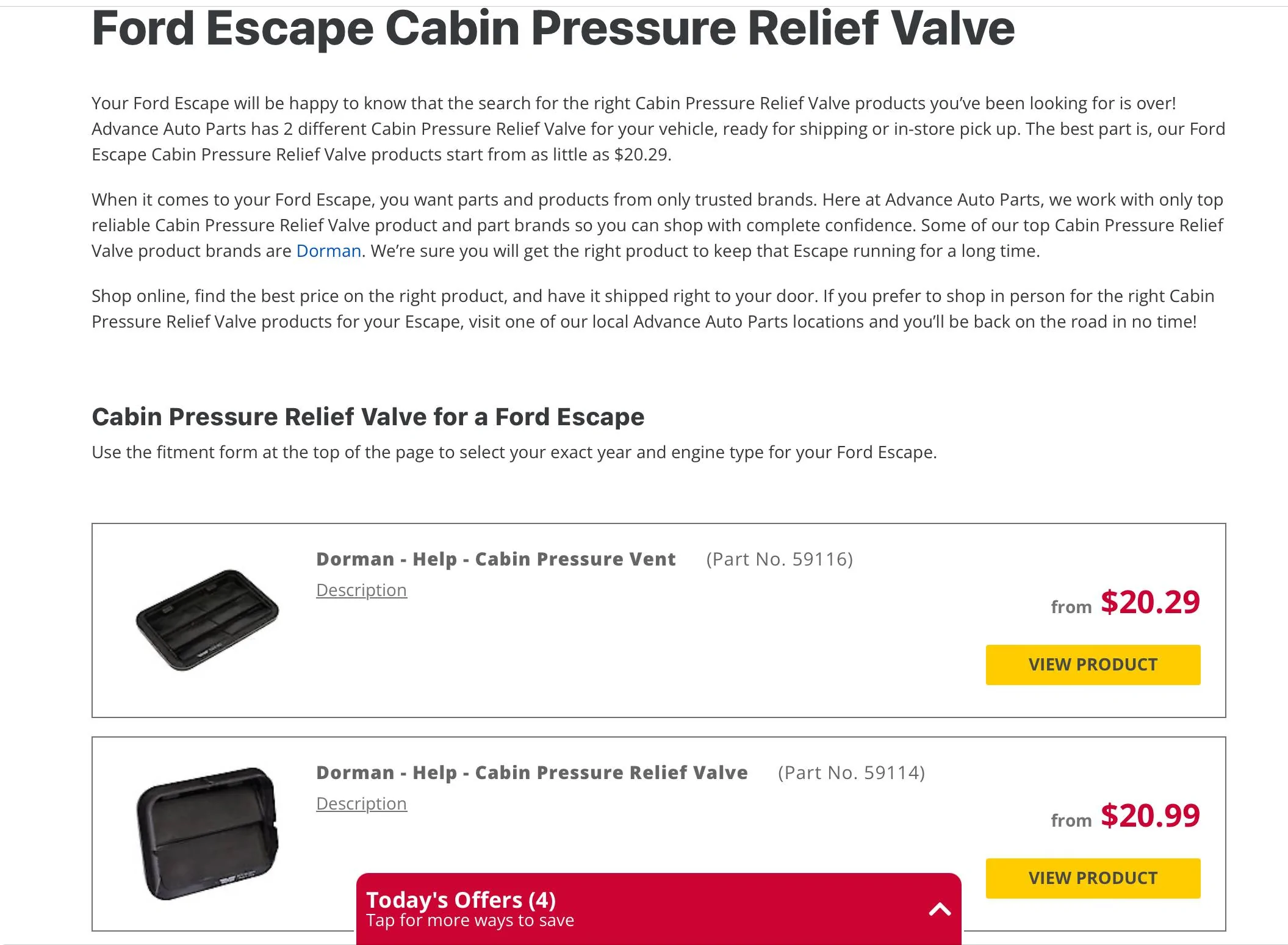

I would also make sure your cabin pressure relief valve is functioning. Do your doors close really easier than expected? These are located in the cargo area which could explain the exhaust smell. But if it is sweet, I also would agree with @Thejitney regarding the coolant leak. What does your exhaust smoke look like? That usually pretty easy to see if you have a coolant leak into the heads.
