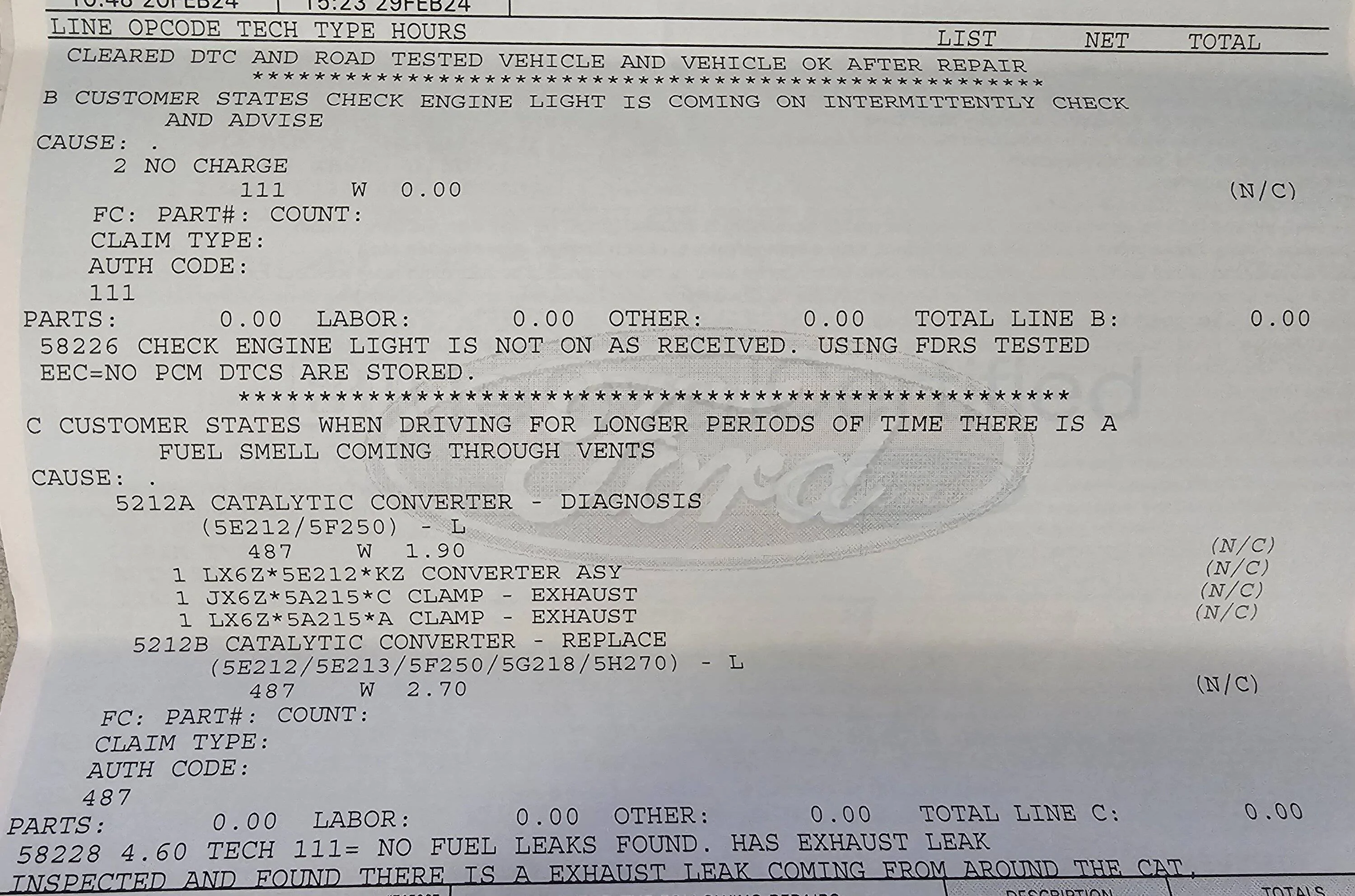

2022 Ford Bronco Sport 35k miles roughly. On November 1st I realized I had exhaust coming into my cab from the vents. It was really strong. Started burning my eyes and effecting my health. I called the dealer and brought it in for warranty repair. They did not help me with a loaner vehicle or rental. They had it for about 6 days and stated it was an exhaust clamp and gave it back to me. They struggled to find the leak during the time they had the vehicle per the service rep. I received it back and realized the exhaust is still coming into the cab. I called the dealership back and stated I need to bring it back because I couldn't drive it like that. I dropped it back off and they had my vehicle until 11/29/2023. During this time, I was told that they can't find the leak. No assistance with a loaner or rental vehicle. Had to find forms of transportation and places to stay just to get to work. Had to purchase a plane ticket during Thanksgiving due to not being able to drive to my destination and more. When they called me about the car being fixed, they stated that they had to change another exhaust clamp. At this point, they have had my car for about 28 days. After I picked it up and drove it a little I realized the exhaust was still coming into the cab. I called the dealership to have it dropped off for a 3rd repair. They had my car for another 12 days of not being able to utilize my vehicle. They replaced the catalytic converter due to a crack. I picked up the car yesterday. Corrected repair TBD.
I contacted Ford Customer Service during this process. They did not offer assistance during this time. They stated that the car needs to have a diagnoses before rental vehicle assistance can be given. The dealership failed to diagnose the car correctly multiple times and took over 30 days to come to diagnose. Due to the dealership giving my car back twice not repaired, Ford Customer Service stated they couldn't assist me because the car wasn't at the shop for a certain amount of consecutive days.
I love my Bronco Sport but I never thought I would have such a hard/rough time with warranty work and no assistance for over a month.
