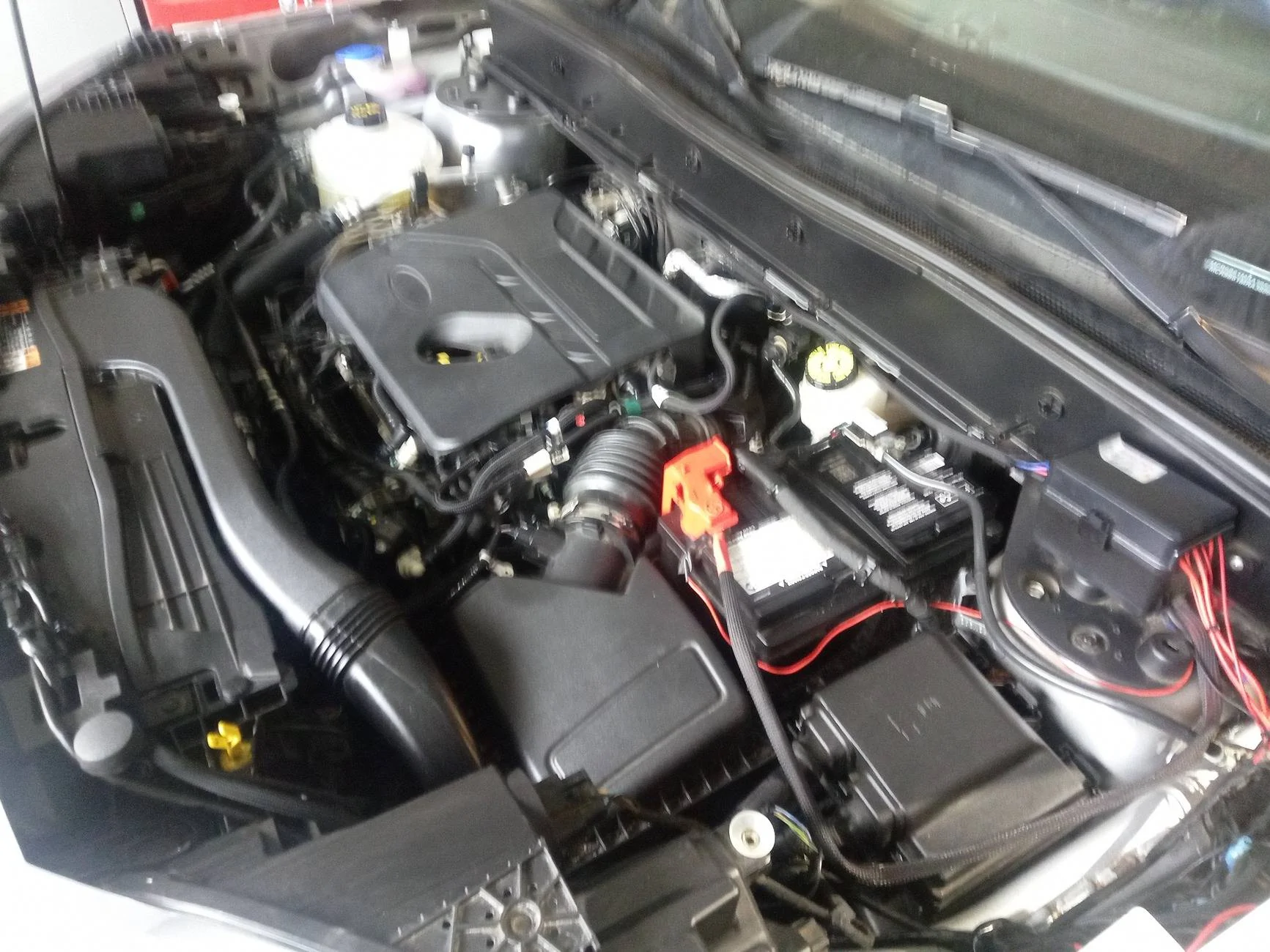

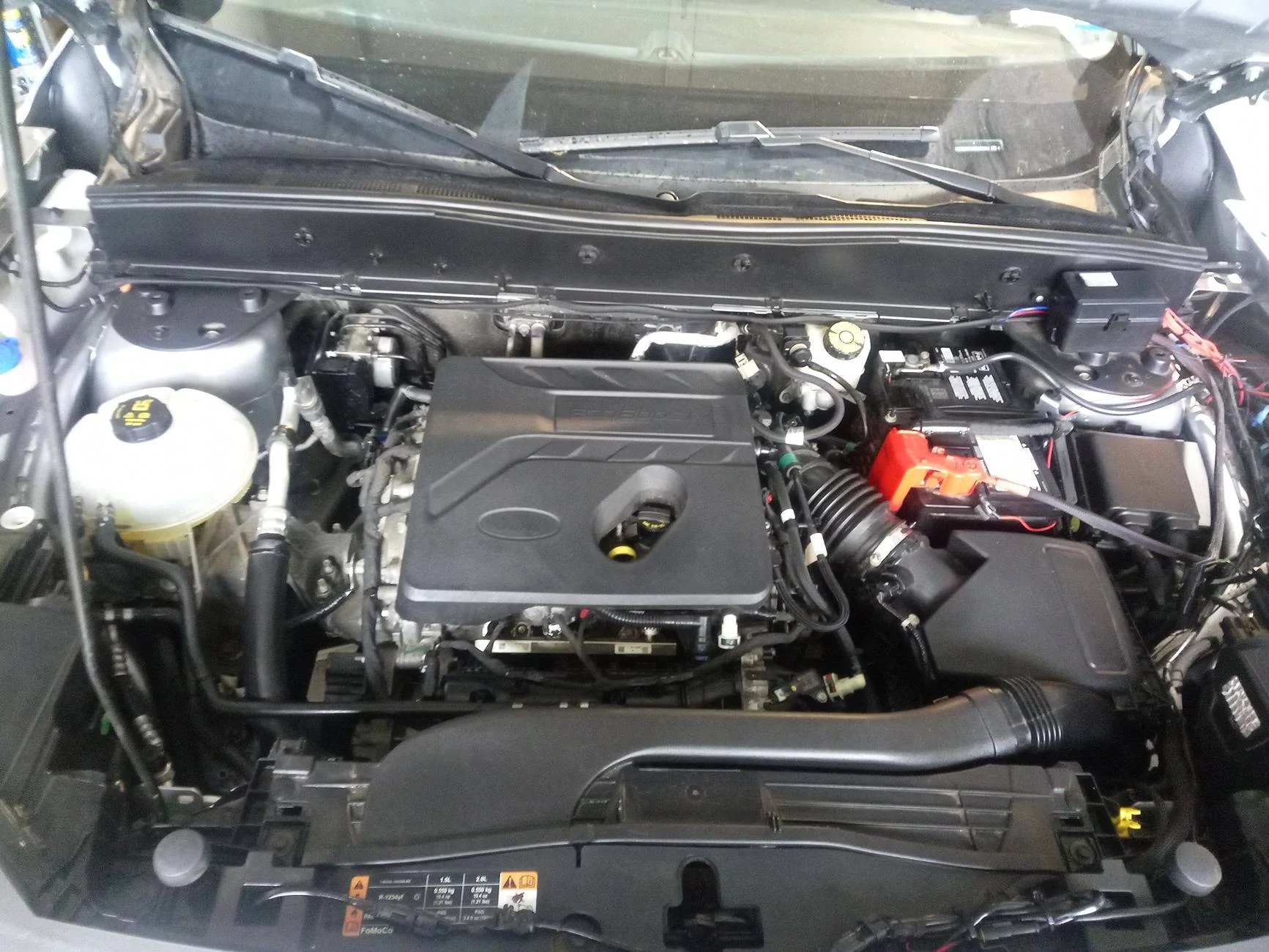

So this is the engine bay after cleaning with P21S from a pressure spray bottle. I sprayed it on, waited a few minutes and cleaned it off with rags. Then I wiped it all down with Griots Engine Detailer. It's really a superficial cleaning but looks far better than the dust bowl it was. I never used water or a pressure washer. Bronco On!!!

Sorry for the crap photos.....used my tablet.
