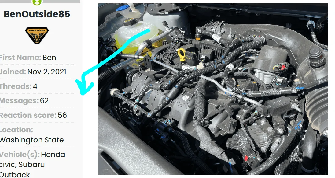

Hm, I saw the OP posted pic but still can’t find mine. Could someone point out in here?
Thanks

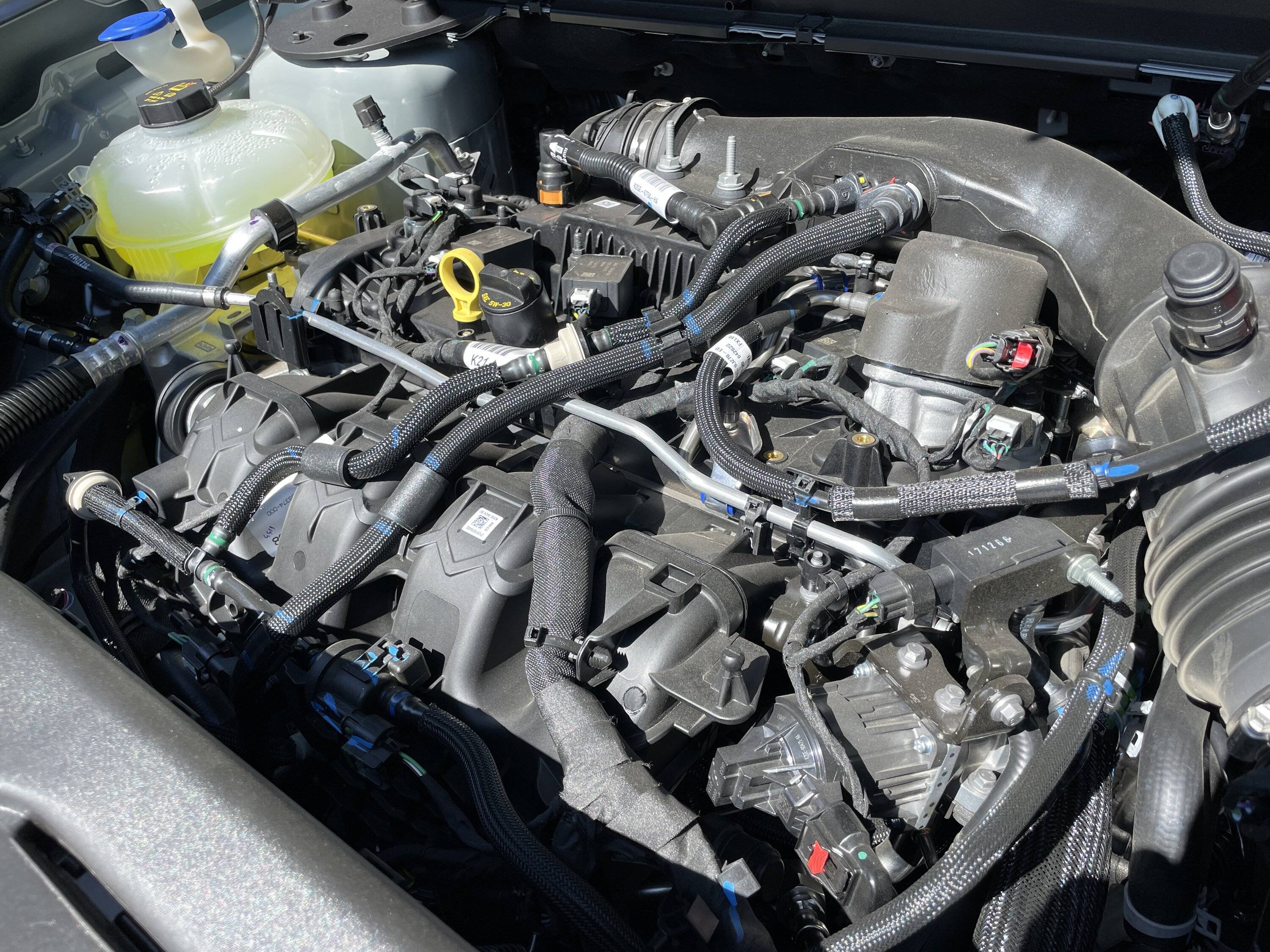

OP's pic indicates receptacle very close to hood bumper
strapped to inside corner of radiator bracket
mentioned had cover on receptacle

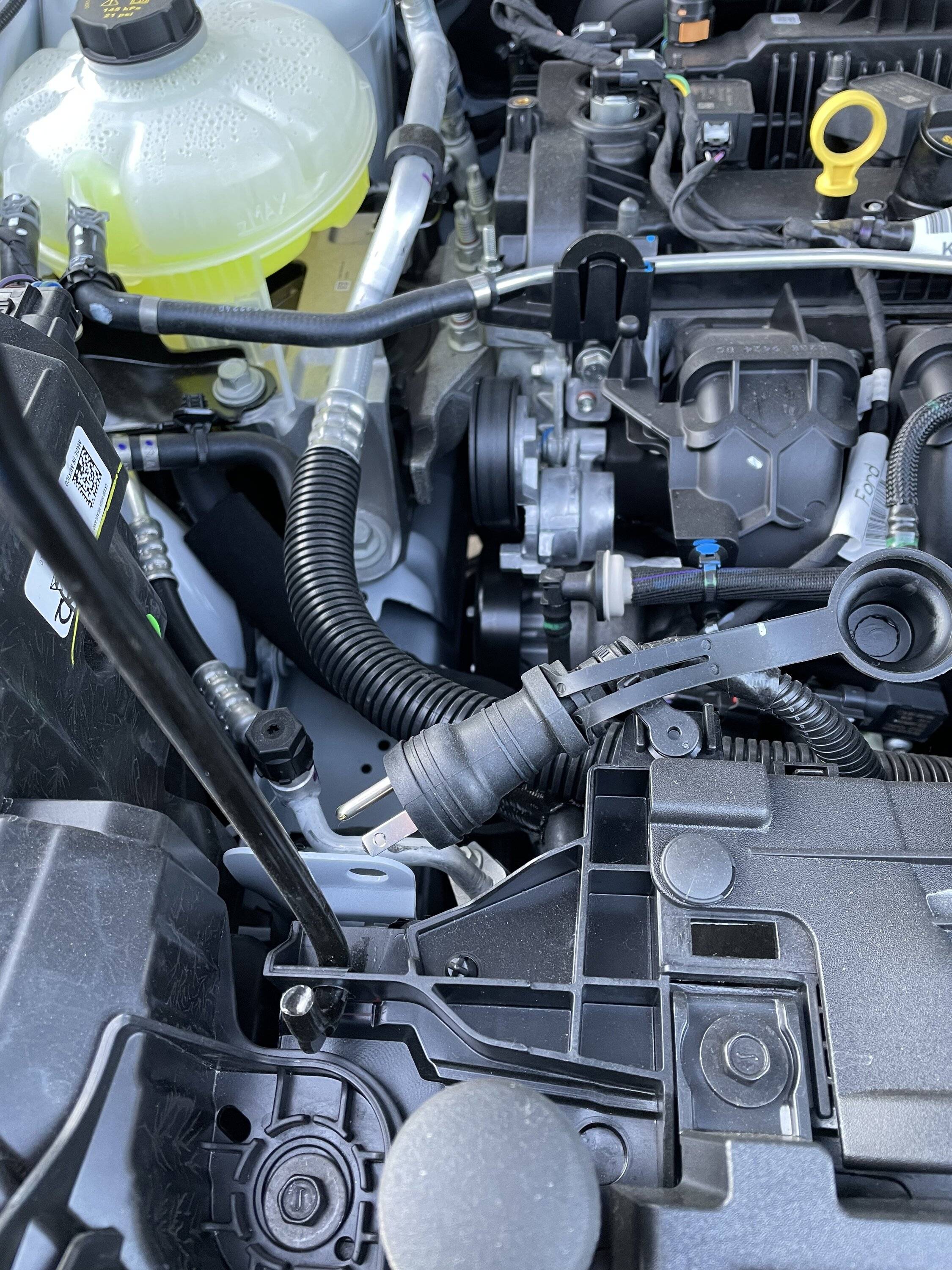

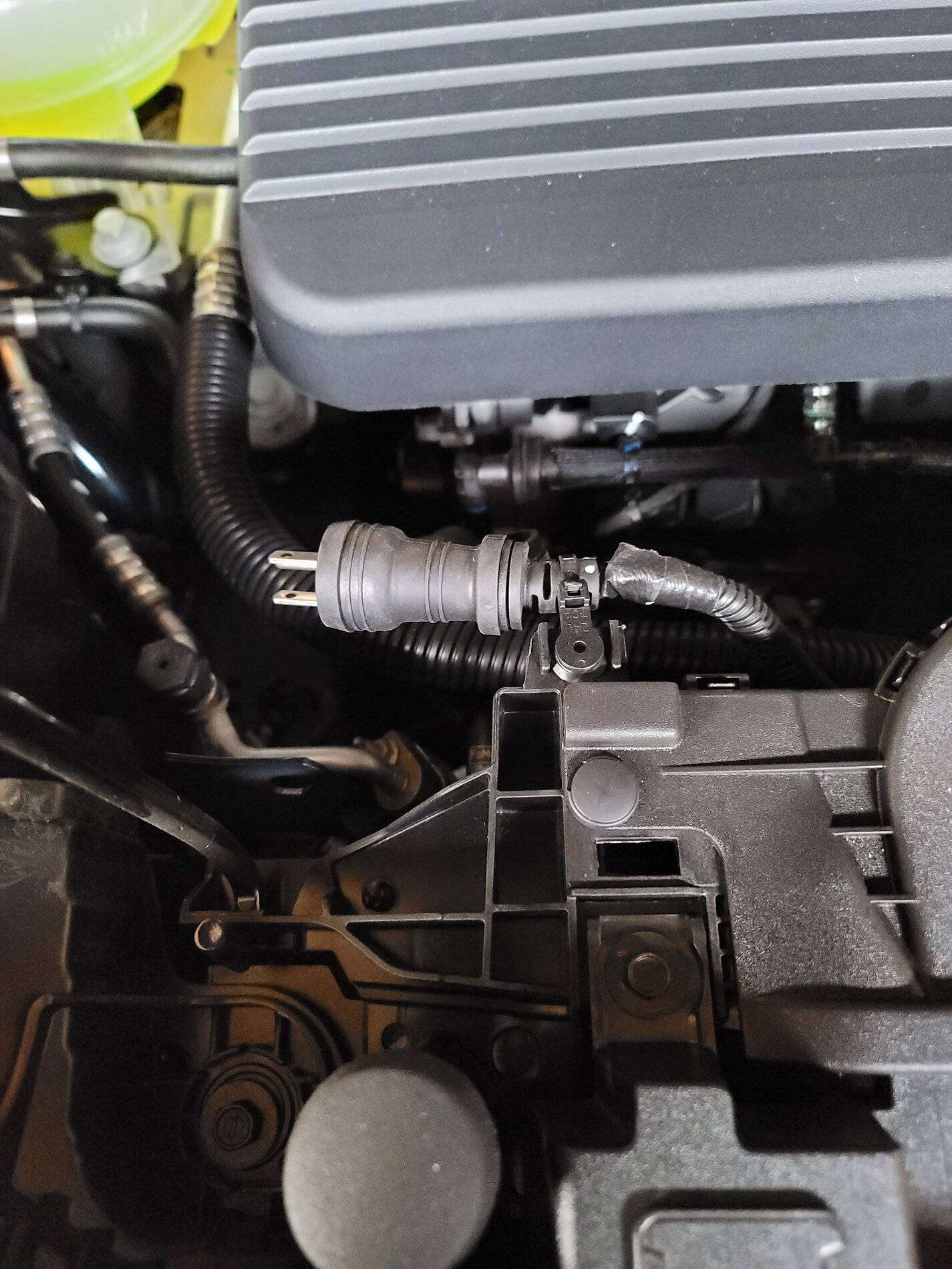

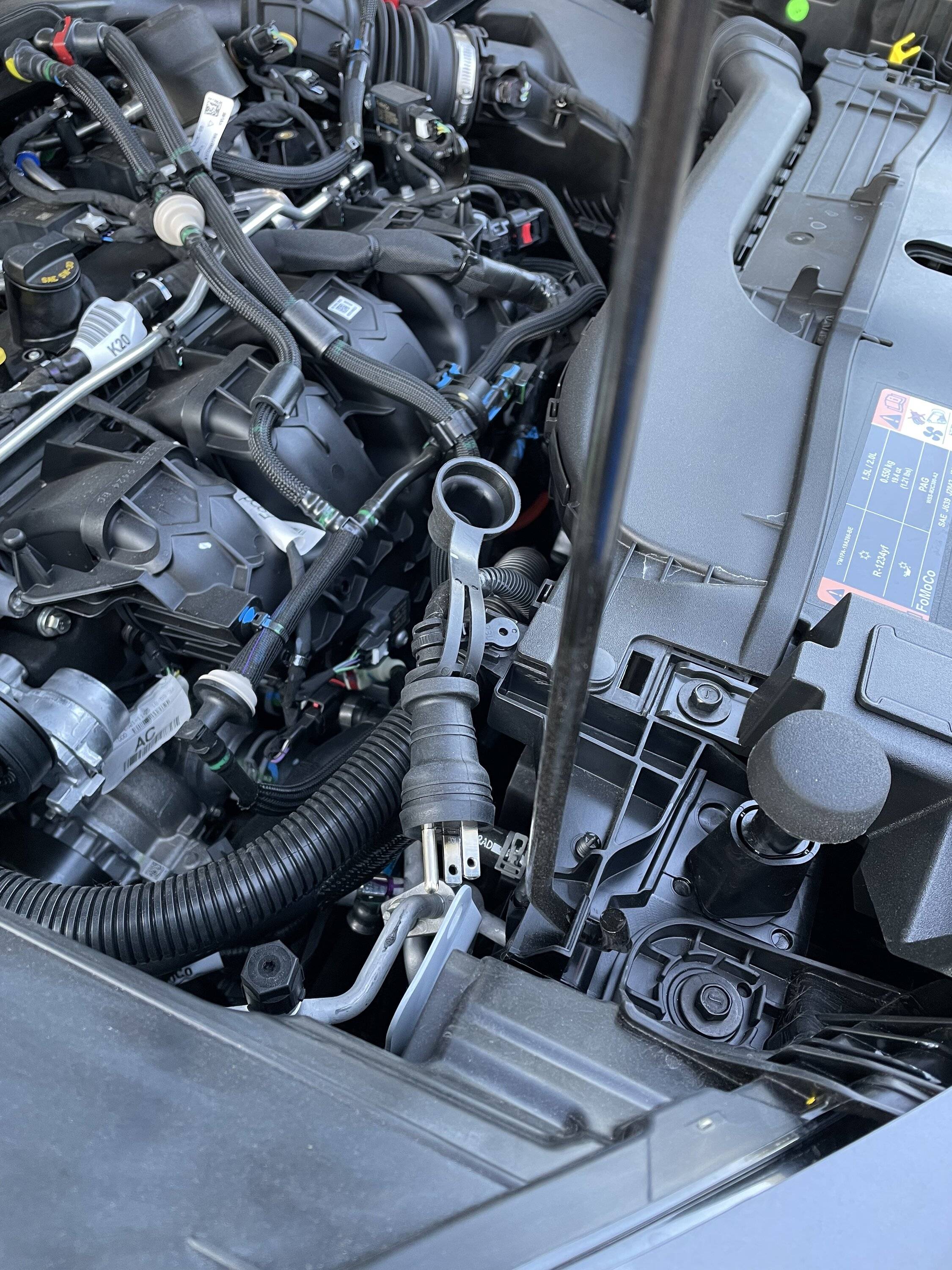

Hope this helps…cap is off for clarity…took me about 2 minutes to find myself.
