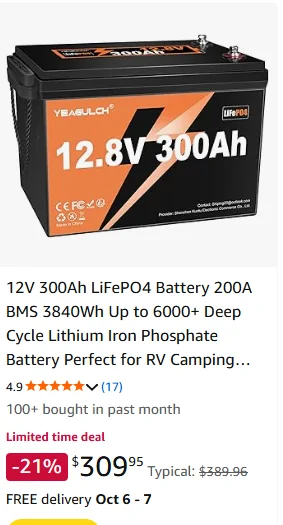

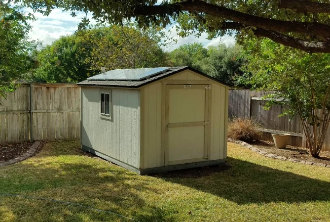

It has a dual purpose, it also allows me to use big 12vdc batteries easily and most important, efficiently. I will be powering my shed with the EcoFlow Delta Pro and a bank of these batteries.
The shed roof is sunlight all day so it is being filled with rigid panels. It also sets me up to go off-grid if I ever decide to do so.
