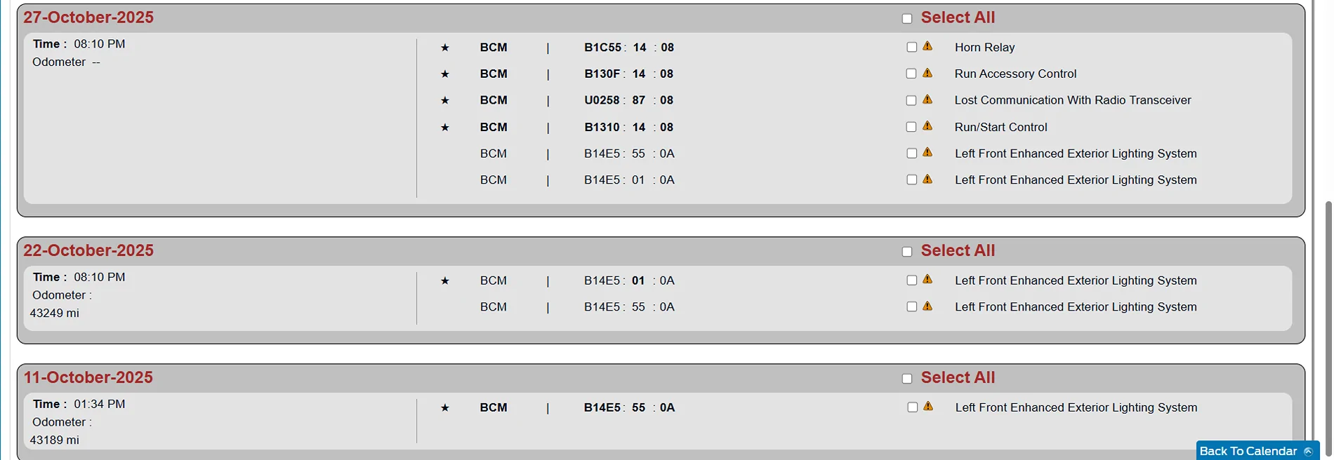

@Ashlovely Got your message, but figured I would post here so the info is out there since it seems to be a somewhat common occurence with these vehciles. Your truck had a very clean history in terms of not reporting any codes until 10/11 when a BCM code started showing. These codes are soft codes that will not trigger a light on your dash.
Of the codes you see on 10/27, the top four that end in 08 are stored codes that may be a byproduct of the the two active faults under.....hard to tell where those came from. However, the two codes ending in 0A are active faults. The fault type of 55 refers to the module not being configured and the 01 fault type cites a general circuit/electrical failure.
Ford Bronco Sport Drivers side headlight acting wonky 1761774555054-mg
These things are very difficult and in most case, impossible to diagnose remotely, but it points to a potentially bad body control module.
Wow, thank you so much for this! That’s extremely helpful. I just wonder if I replace the module myself, if Ford has to do anything else on their end? I thought I saw someone mention the BCM would need to be flashed or something. Maybe that was something different I’m thinking about. Not sure. This stuff is way over my head lol
The BCM itself is pretty easy to get to and to swap out. The problem with DIYing the BCM is that it will require FDRS to first program/configure it and then to run PATS on it to program the keys to the new BCM. Even with FDRS, this may not be possible with a non-dealer login. With FDRS, it won't let me update the firmware on my BCM without a NHTSA password or a Ford employee/dealer login. Not on my truck anyway that is on Sync 4. These Sync 3 vehicles are still new to me and I am learning.....not sure if you can program and run PATS on the BCM of one of these without a dealer login.
If this was something simple like a door module (for example), I would tell you to go for it, because I can program a door module with FORScan. However, encrypted procedures like PATS and TRON authorization cannot be run with FORScan.
