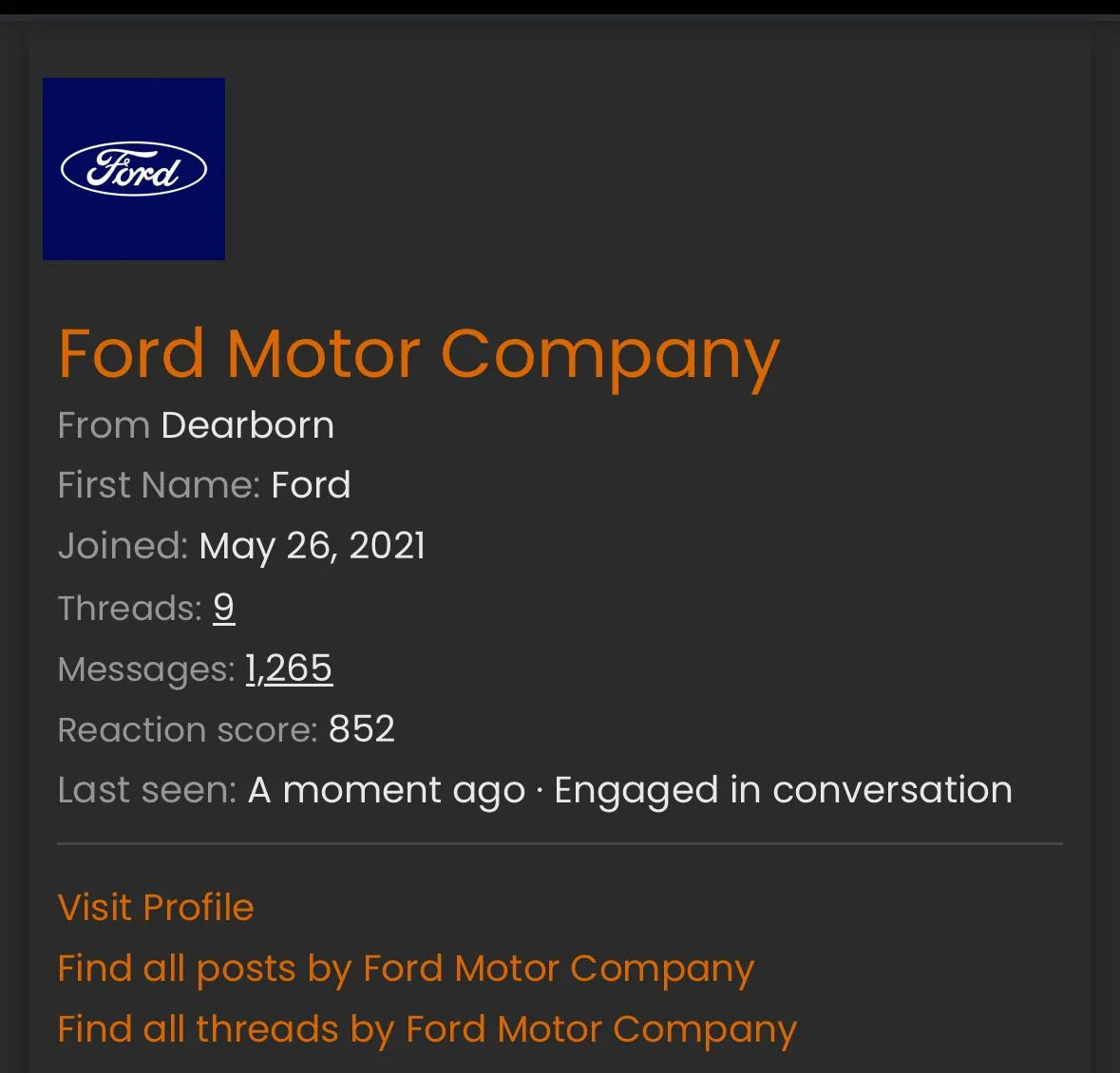

Not sure but you may want to change to use @Ford Motor Company in your prior post
