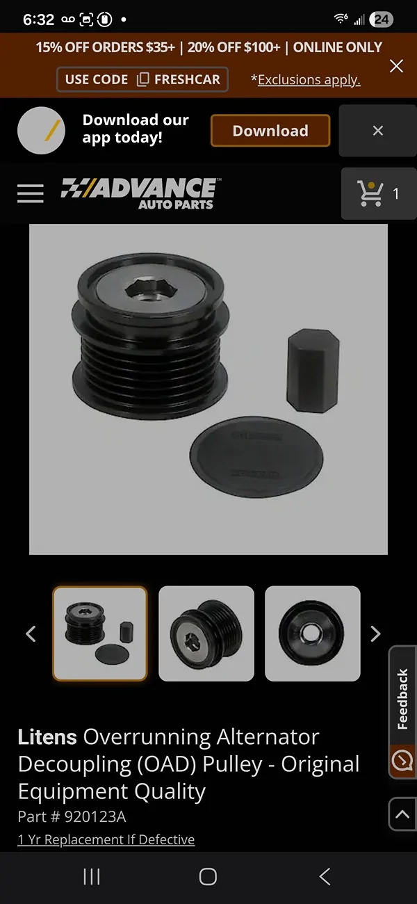

Advance Auto Parts is the ONLY place I found in writing what an exact replacement is. It's made by Litens part# 920123 920123A or 920123k. Must be delivered to home as the have shut down 700 stores.
I got it on Amazon with a new serpentine belt for $75
What an embarrassment for Ford that they won't release a replacement part number just to force you to buy the entire alternator.
I feel bad for non mechanically inclined folk who are duped out of an extra $400 + labor
This was for 2022 outer banks 1.5L for anyone else with the same issue.

Rock Auto has the same Litens part for $44
The pulleys for the 1.5L and the 2.0L are not the same. They are both 52mm outside diameter, however the pulley for the 1.5L is wider.
