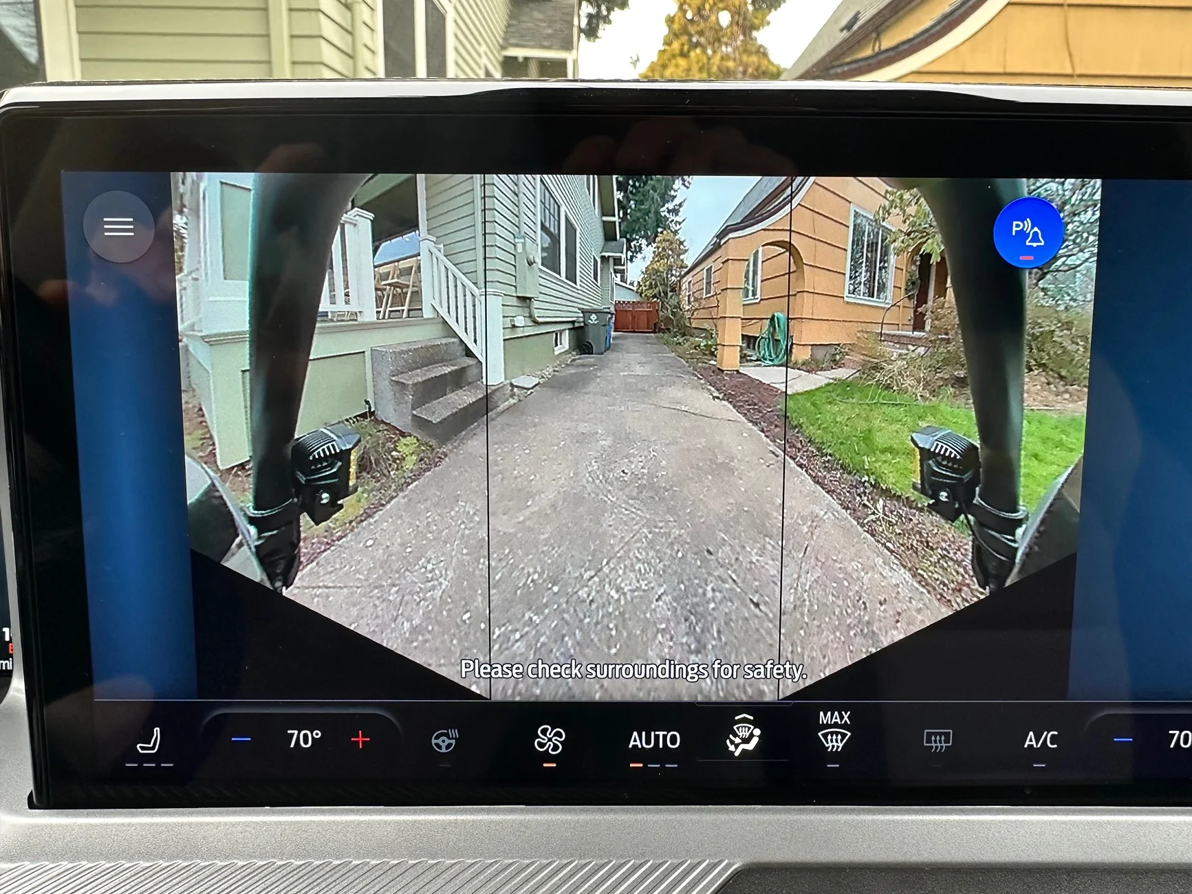

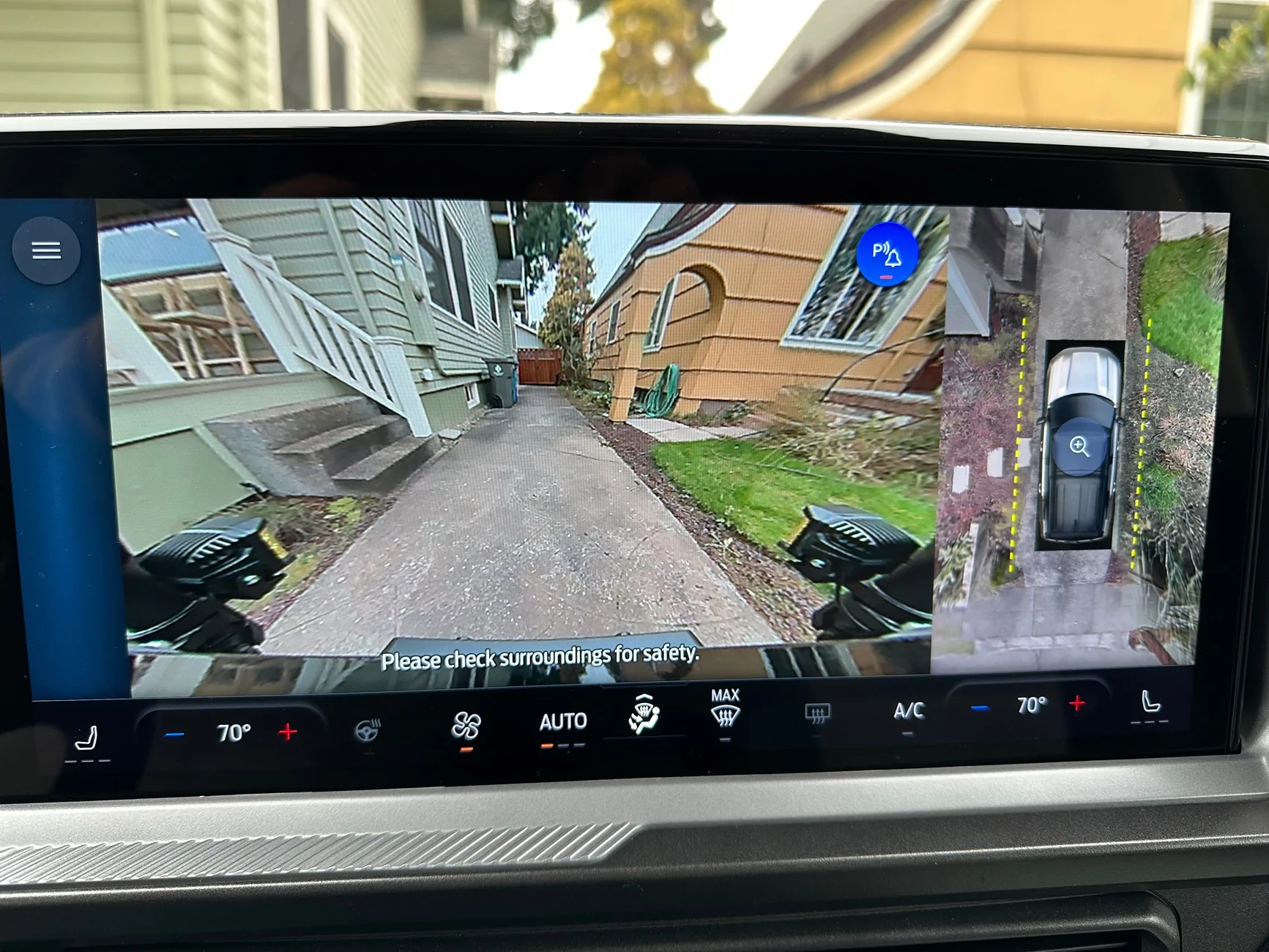

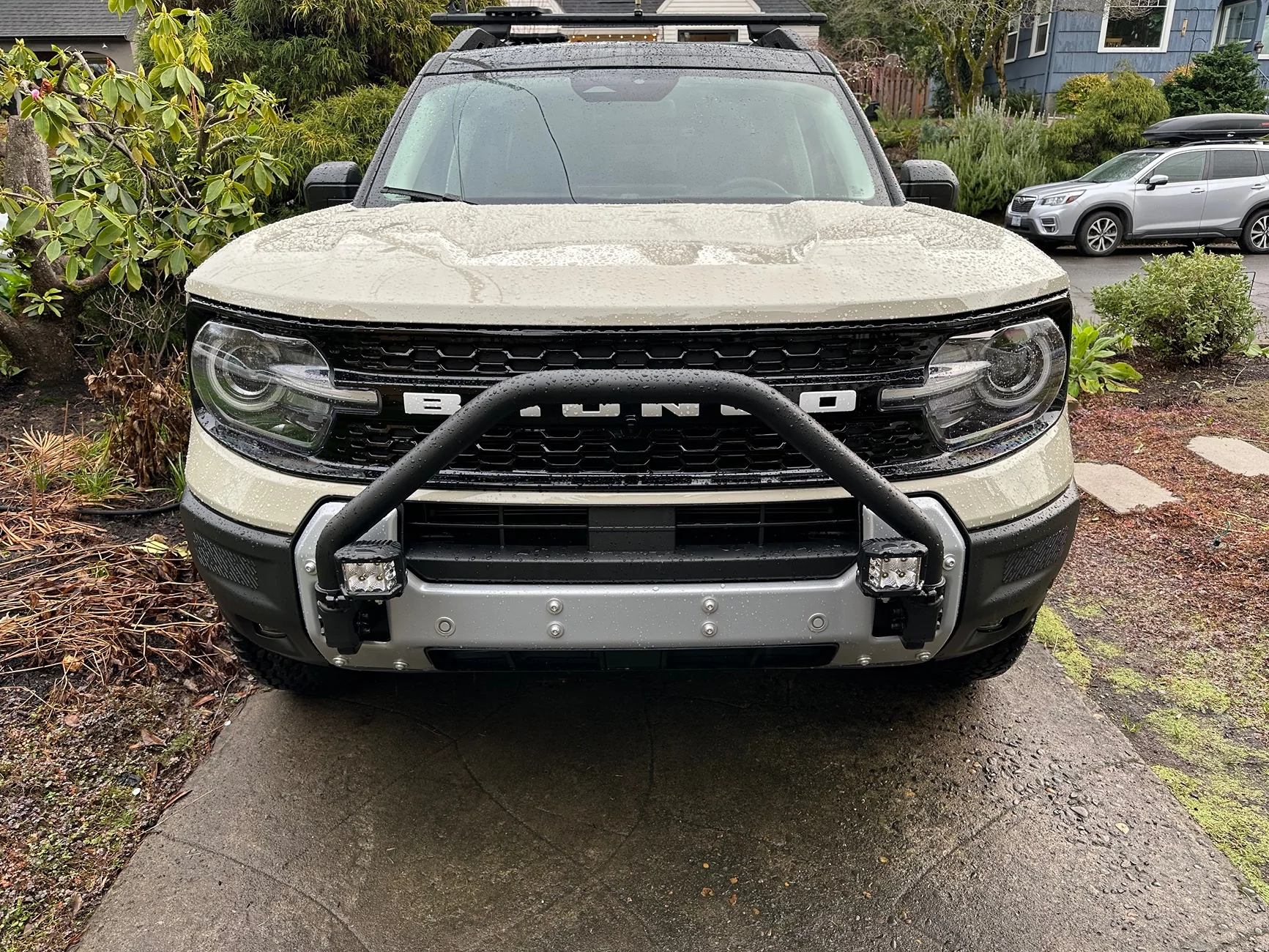

Whatever height and shape you end up with make sure the front camera isn’t obstructed. It’s got a very wide angle lens and is right below the BRONCO text. I’m convinced that’s why the stock bar comes up so high. If you don’t have a front camera or don’t care no worries. I was surprised when I mounted fog lights on the factory bar that they fall into the cameras field of view.

Sure, here’s a couple and what the front camera view looks like with them in it. Not really intrusive but I was surprised they showed up in The front camera view at all.

Thank you. I have four auxbeam 4 in round pods that I want to install, two Amber, two clear. I was originally planning on roof mounting them between the roof rails but I I have a couple sets of mounts left over in my shipping container from my old truck but I never installed and they will fit the tubing on that bull bar perfectly. I'm tempted to go that route. You placed your lights exactly where I want to put two of mine I'm thinking the other two right on the other side of the tube at roughly the same height.

Lights look good. Not really intrusive at all. The bar shows more than I thought it would.

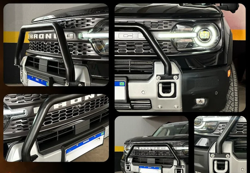

There is a guy in Brazil that is selling.
Maybe we can check the price or get more info

I’d highly pass on that. It’s literally mounted to the front with two small bolts on each side with nothing behind it to support it.
Mine is going to replace the tow hooks and actually have something worth a damn to mount to.
