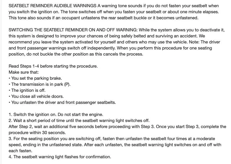

You can ignore it and it will disappear on its own after a while. I’m not sure, but it may be able to be disabled entirely with FORScan.

Interesting. Do I need a dead chicken in a bag and does it involve hopping on one foot while chanting? :crackup:
I will give it a shot later.

Ya know, I'm thinking this only removes the audible warning and not the pop up message on the dash, as the title of the document refers to the audible warning. 🤔

I did it and it worked for awhile but stopped after my last oil change at the dealership, I believe seat position changes require reapplying the procedure. At this point I'm not redoing it.

Did it remove the popup alert or just the audio alert?
