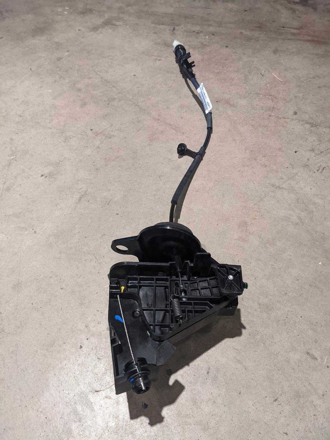

Mine had a faint noise so I went ahead and ordered the revised cable at $55 shipped and installed it myself. I don't have pics of new cable but it had a metal cylinder on it to dampen the sound. I had to take out entire air filter box, battery tray, and left lower dash panel to replace it. Not easy and not for the inexperienced novice. Took around 2 1/2 hours cause had to figure out how it all comes apart and careful not to mess stuff up.
But the faint noise is gone. With radio off its so smooth and quiet now. So well worth the effort.
Pics of old cable and part number for the new revised cable. It should also be noted that this is the second revision from Ford to address the cable noise.
