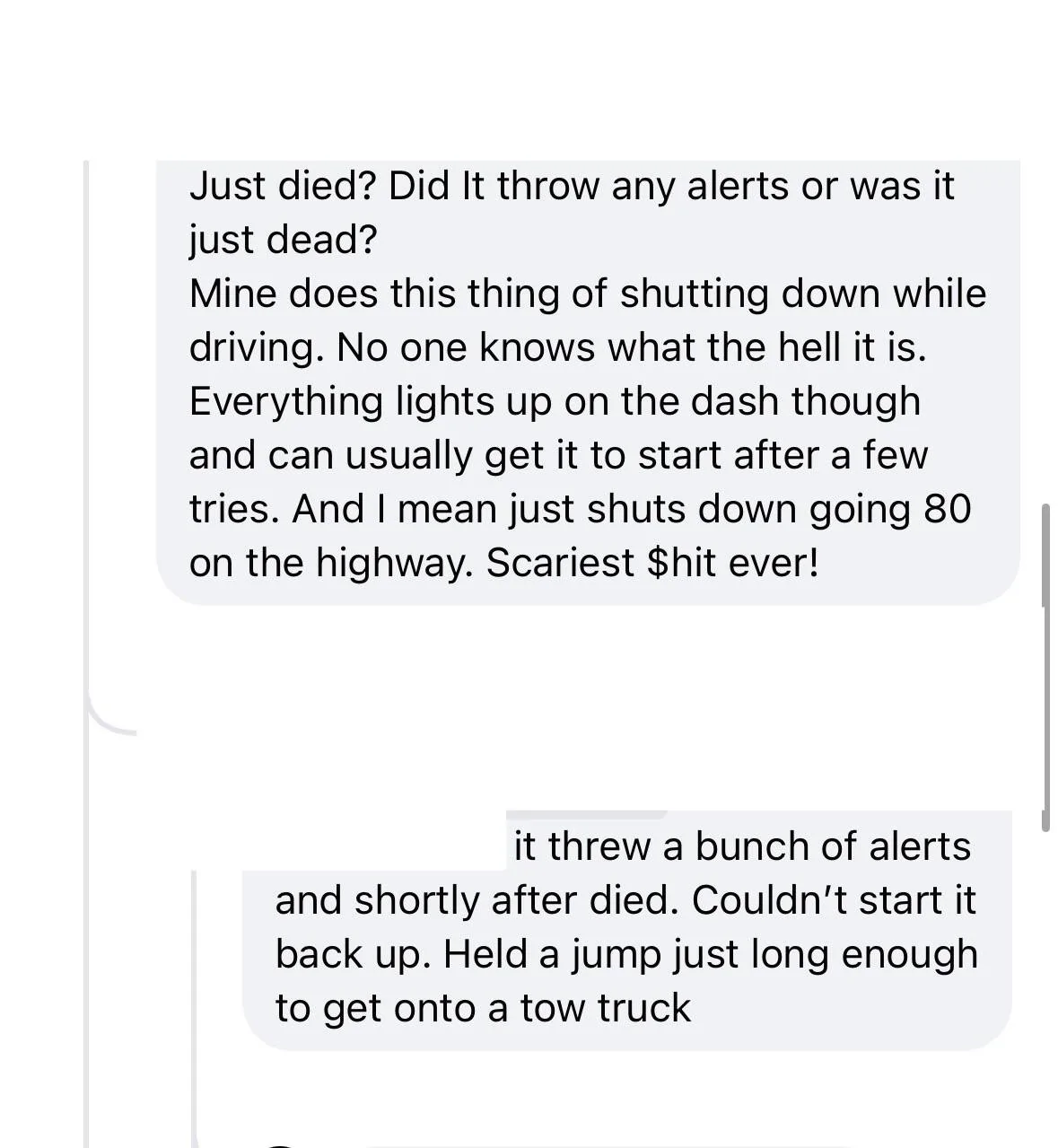

I think you are 100% correct, the confirmed instances of a Bronco Sport engine quitting while the car was in motion seems to be pretty small.
Ford and NHTSA likely have more data it would seem. And I thought there were quite a few on the various Facebook Bronco Sport groups but when I went back to check two of the most popular groups all were cases of the car not restarting after an auto stop/start except maybe the one in the attached pic stating “shuts down going 80 on the highway”.
In that case the thread was about vehicle shut down due to the battery however the posted comment shown in the attached pic was not clear as to the actual cause.
I didn’t do an exhaustive search so there could be more cases listed in the Fb groups but most people provide sparse posts and not always clear what happened or what the dealerships fix was. Although there is a lot of “battery replaced, and no further issues were seen” according to what they posted. If the problem never reoccurred, it could also mean there could be a number of defective batteries perhaps but that is just conjecture on my part.
