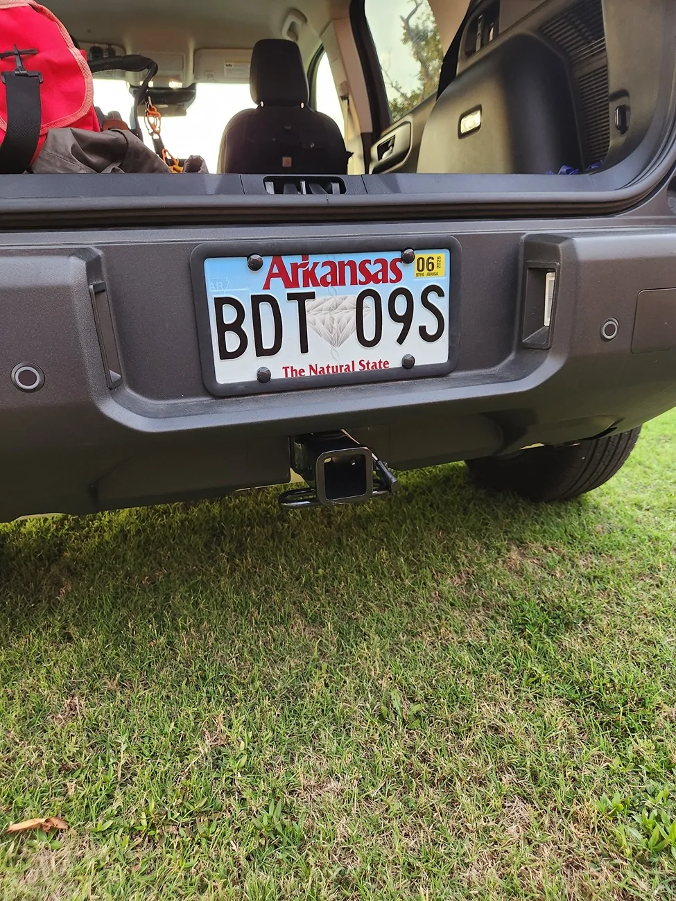

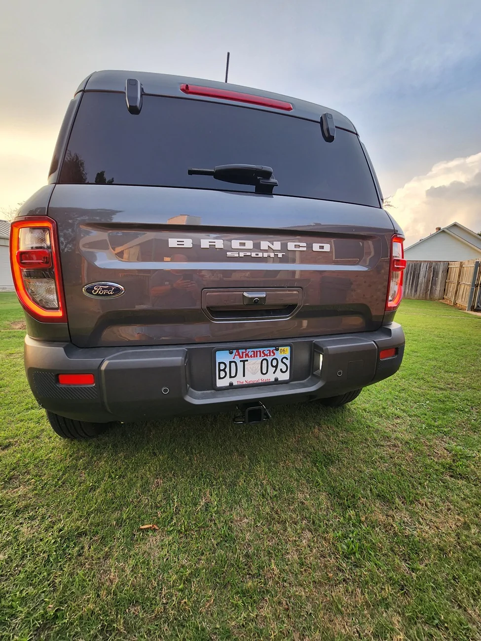

I installed the curt hitch on my 2025 big bend. It's not easy . I used the U-Haul video. It's the best one I found.
You do have to remove the bumper cover. Be careful of the clips on the bumper fender intersection. They're easy to brake. If you do brake them get the replacement at O'Reilly's They're cheaper than the dealership.

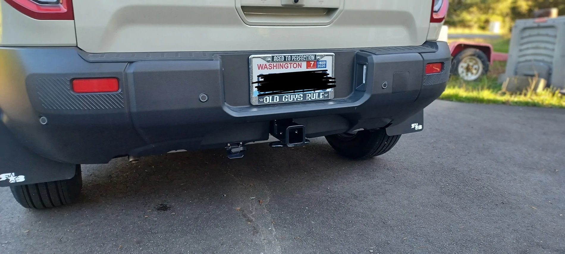

The hitch showed up yesterday and I installed it today. Everything went fine, no broken clips, and best of all, no "extra" hardware left over! :cool:
