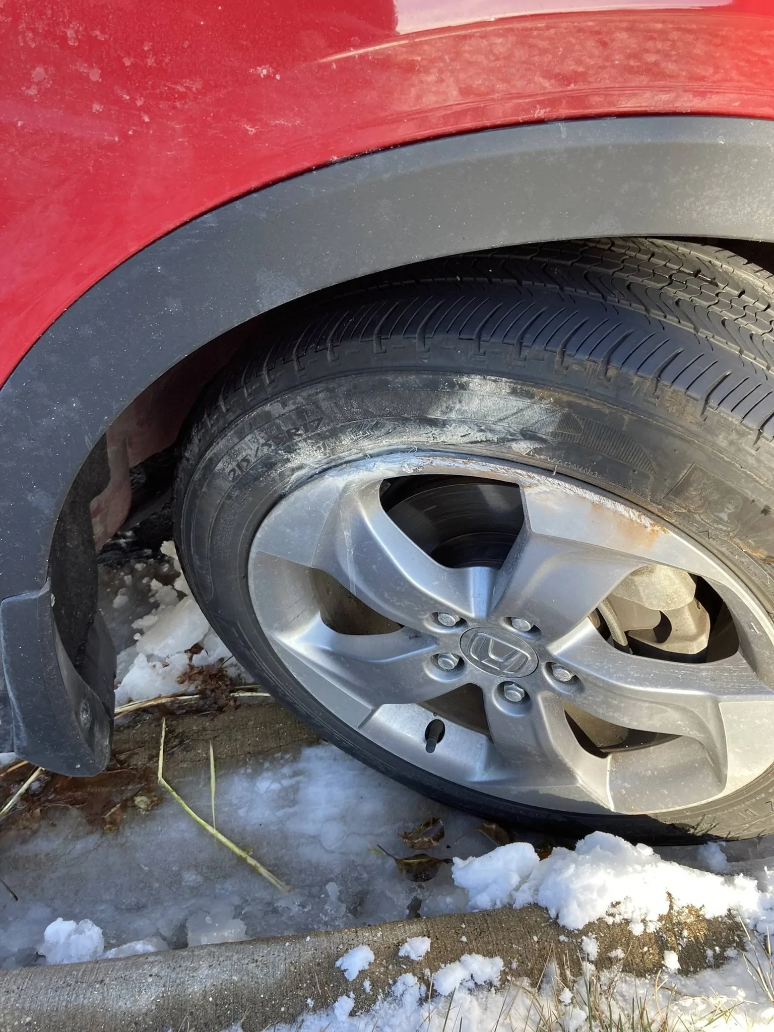

There are places that will repair or just swap you plus cash. Here’s ours that is being replaced with a refurbished one.
