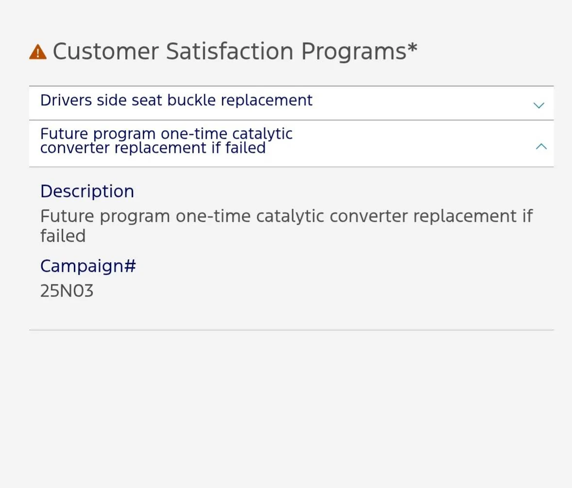

Thesre from my Ford Pass. I also got a letter from Ford. Definitely 25N03
Ford Bronco Sport Cracked/Leaking Catalytic Converter, Out of Warranty, New Recall? 20250524_161029
Ford Bronco Sport Cracked/Leaking Catalytic Converter, Out of Warranty, New Recall? 20250524_161003

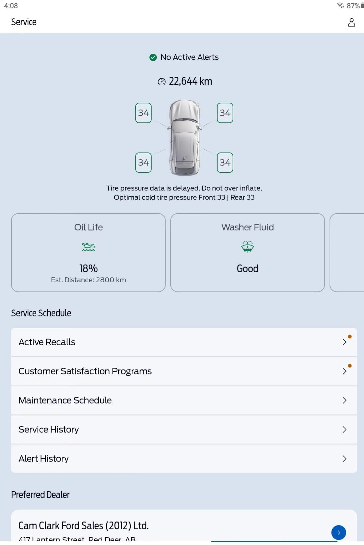

This is what was posted in the FB Groups.
Ford Bronco Sport Cracked/Leaking Catalytic Converter, Out of Warranty, New Recall? Screenshot_20250522-230222

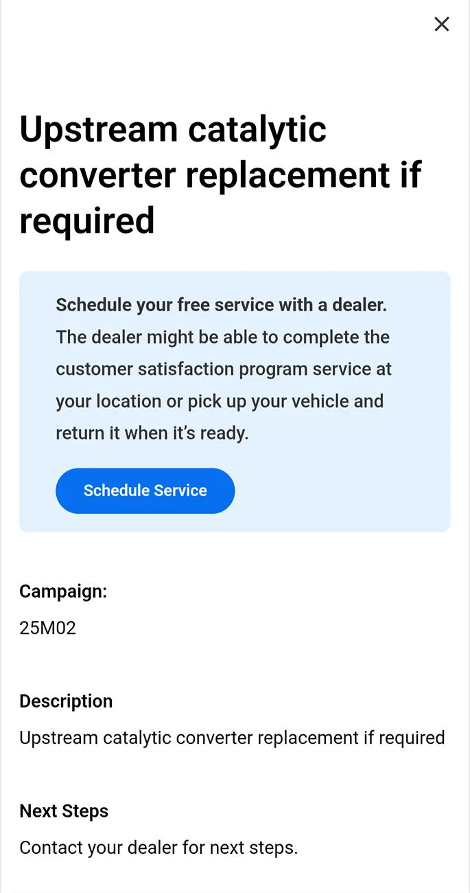

I received a similar message in my personal account with the code 25M02. The car is for the US market
Ford Bronco Sport Cracked/Leaking Catalytic Converter, Out of Warranty, New Recall? 1000017779
