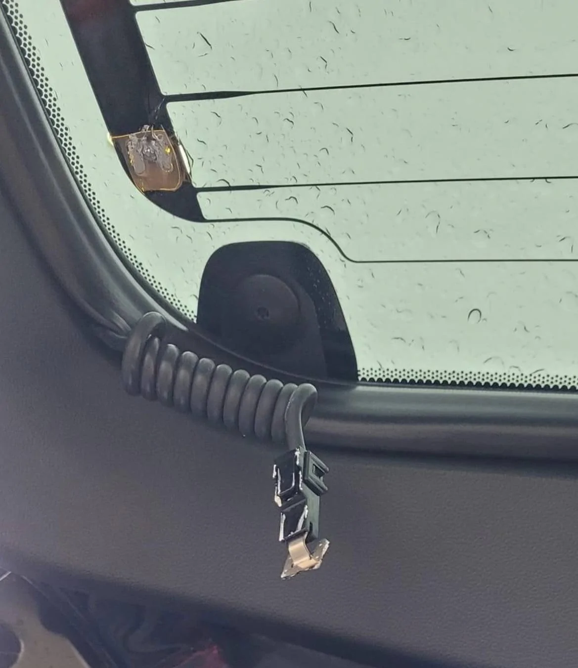

I remember seeing a post about covers for the rear hatch window wiring connections for the heating element.
1 in each upper corner.
I had an issue with the connector bending over and causing 1 coil to get caught between the window and the gasket.
Very hard to see with everything blacked out in that area. Caused a serious water leak into the rear area until I figured it out what was causing it.
Those connectors bend very easily by accidently getting those coiled cords caught on something or when cleaning the inside rear window.
Anyone put these on and have a link so I can purchase them?
1,555
1,525
I assume yours has not broken like this one?

Not yet. A piss poor design by Ford. The connector is brass/copper and very fragile.
Should come from the factory with some sort of cover.
I will look on Ebay motors to see if I can find something. The challenge is to figure out what to call it.

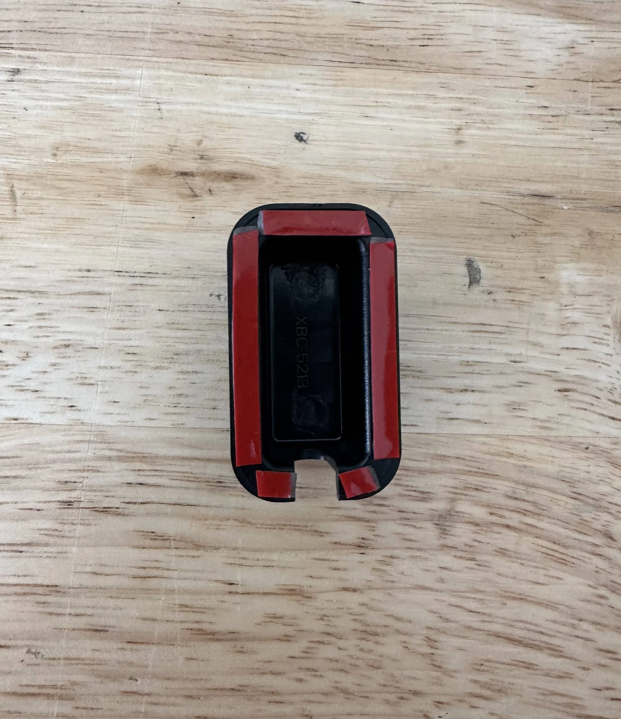

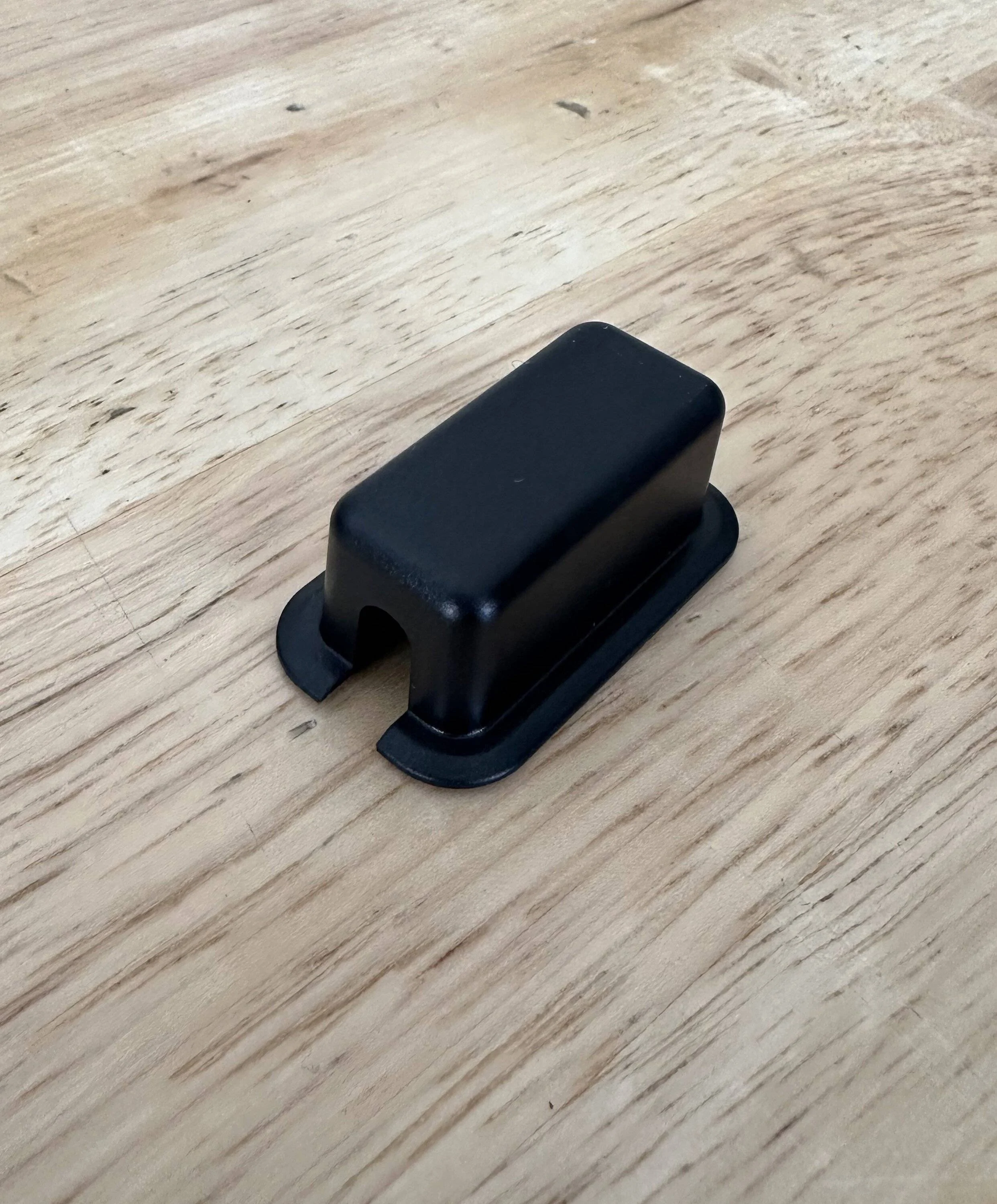

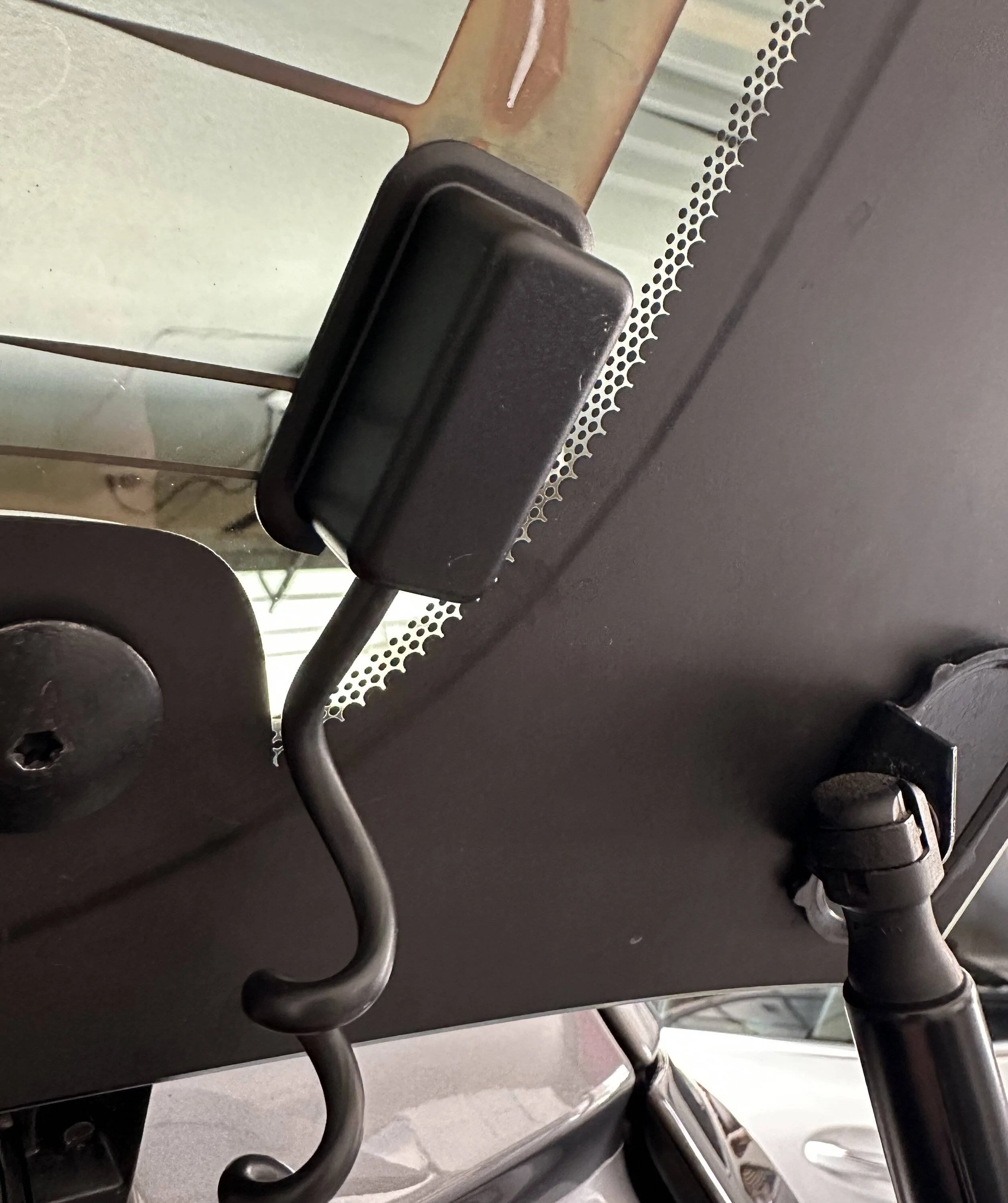

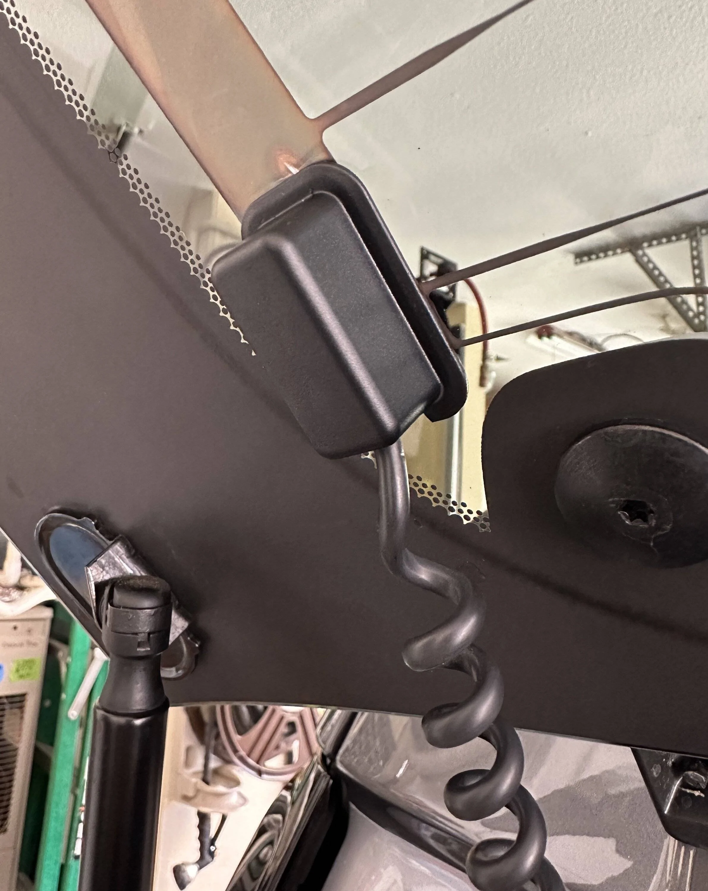

My covers weren't supposed to arrive till next week. Ordered on Thursday and they arrived today, Saturday. Only 2 days going coast to coast.
They are what the ad shows on Ebay. Looks like 3M tape on the back. An adhesion promotor was also enclosed, but I decided not to use it since the heating element is exposed on the window where these attach.
It probably wouldn't have affected the element, but I
deferred not to use it.
They fit as advertised. See the attached photos.
