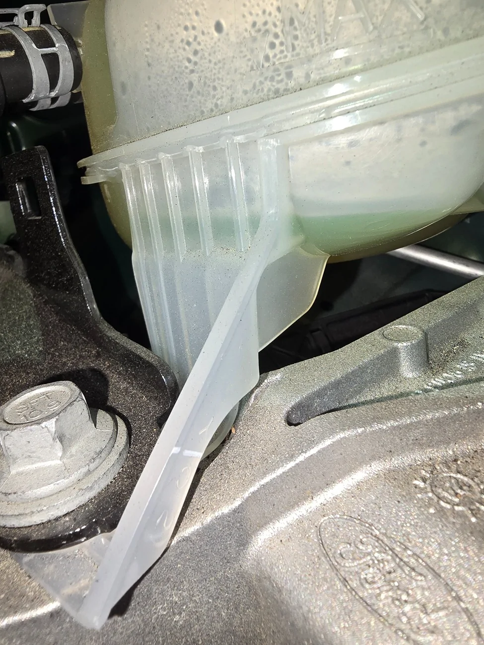

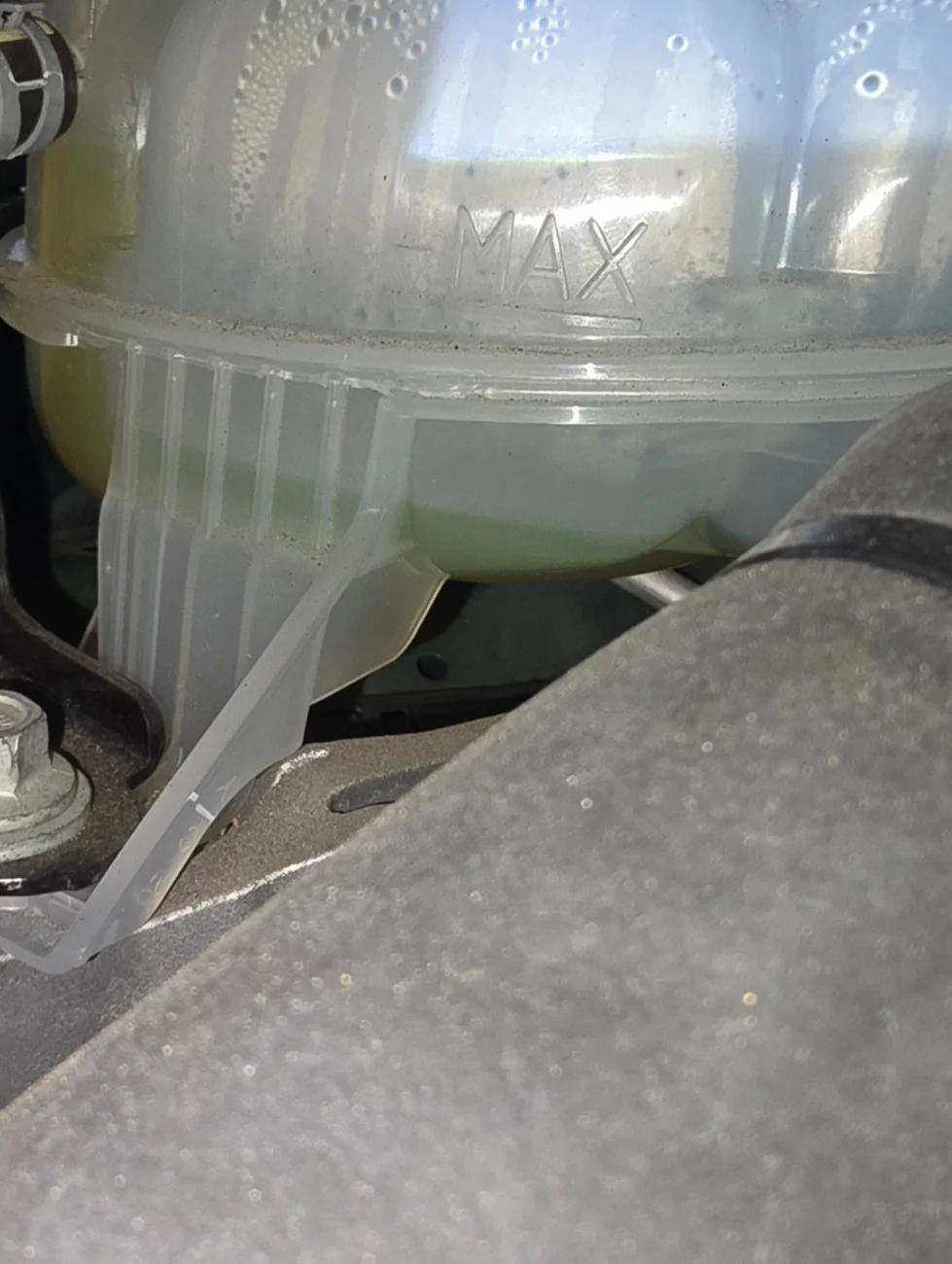

The first picture is when It had been sitting for about 3 hours The second picture is after driving about 30 mi immediately after parking

Unfortunately the coolant level looks low. You can fill the coolant resovoir to a more normal level and keep an eye on it.
More likely than not your Sport has a coolant leak and usually it's the water pump. If your vehicle is still under warranty take it to the dealer so they can make it right
That's what I was thinking. I just always like to get a second opinion. Thank you for the response.
