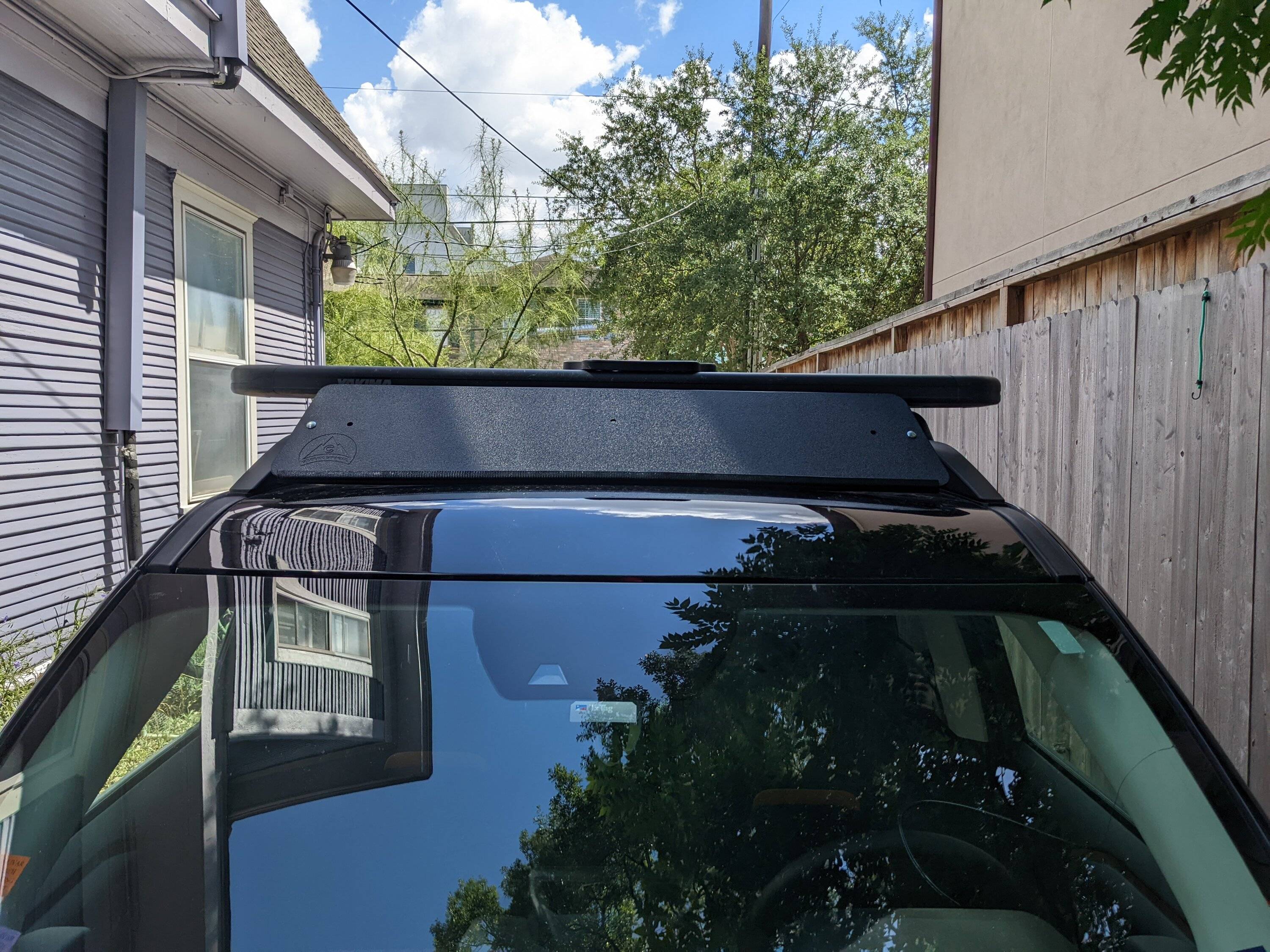

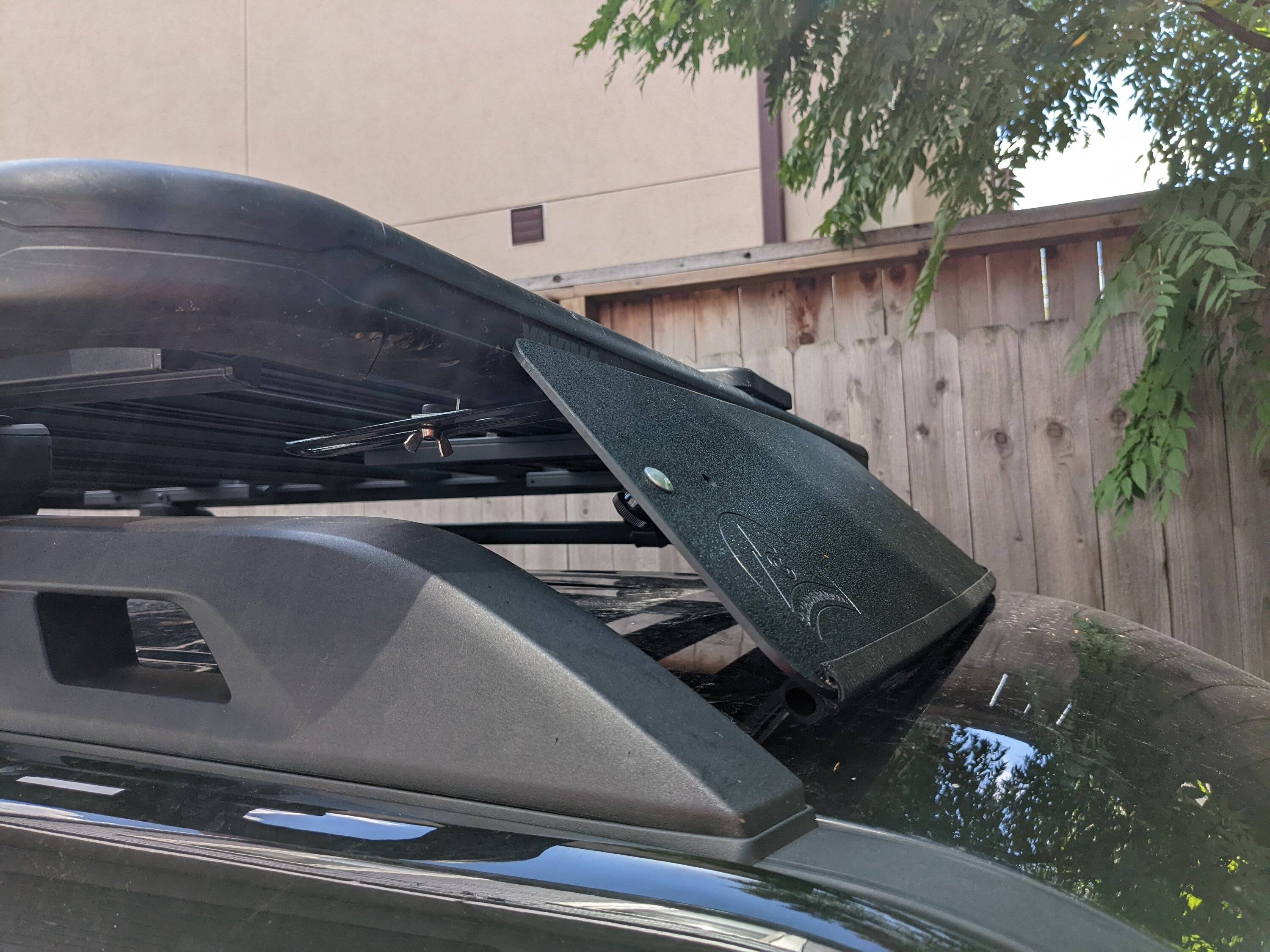

Wind noise is a very real drawback to having a roof platform or large crossbars. I need the extra storage (and ability to haul long things like surf rods or 2x4s), so I was always going to have a platform. However, I'd been less than thrilled by the amount of extra wind noise, especially when things are mounted on the platform. I've been looking for a good option for fairings for awhile. I'm quite happy with what I've settled on, especially the mounting approach. I did this a few months ago, and I've been meaning to add a bit here in the hope it's useful for other folks.
The sport has a surprisingly large gap between any platform or crossbars and the top of the roof in front. As a result, it can be hard to find wind fairings that actually fit. I'd been struggling to find a good option for a wind fairing to sit in front of / underneath my Yakima platform, as Yakima's fairings are a bit too small and are a bit clunky to mount on the platform (they're meant for crossbars).
Based on measurements, the "large" size of standard fairing from Colorado Fairing Company (i.e. 42.5" x 9") seemed to be a good fit. It's one of the few I've seen that is high enough to close most of the area beneath the platform off from wind.
It fits well, but I didn't love the default mounting system....
Ford Bronco Sport Colorado Fairing Co Wind Fairing + Yakima Platform Mounting on Bronco Sport PXL_20220911_231028623
Ford Bronco Sport Colorado Fairing Co Wind Fairing + Yakima Platform Mounting on Bronco Sport PXL_20220911_231038696
By default, the mounting system uses rubber straps that extend over the top of whatever crossbar/etc, you're using. There are slots that allow it to be bolted to platforms/slotted crossbars, but it's still too short to be able to put the brackets on top of the platform where the slots are to bolt things. (There's also supposed to be a third bracket in the middle, but I'm skipping it here.)
The rubber straps seem quite secure, but having rubber straps over the top of the platform blocks some of the things I need to mount there. Also, if you use the rubber straps, you can't quite snug the fairing up against the platform, which doesn't impact functionality, but it leaves a bit of a large gap, as you can see above.

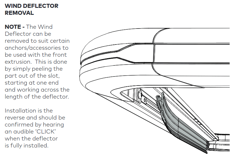

The Yakima platforms actually have a small wind deflector built in. It fits in a slot on the inside edge of the platform and can easily be removed and re-installed:
Ford Bronco Sport Colorado Fairing Co Wind Fairing + Yakima Platform Mounting on Bronco Sport yakima_wind_deflector_removal

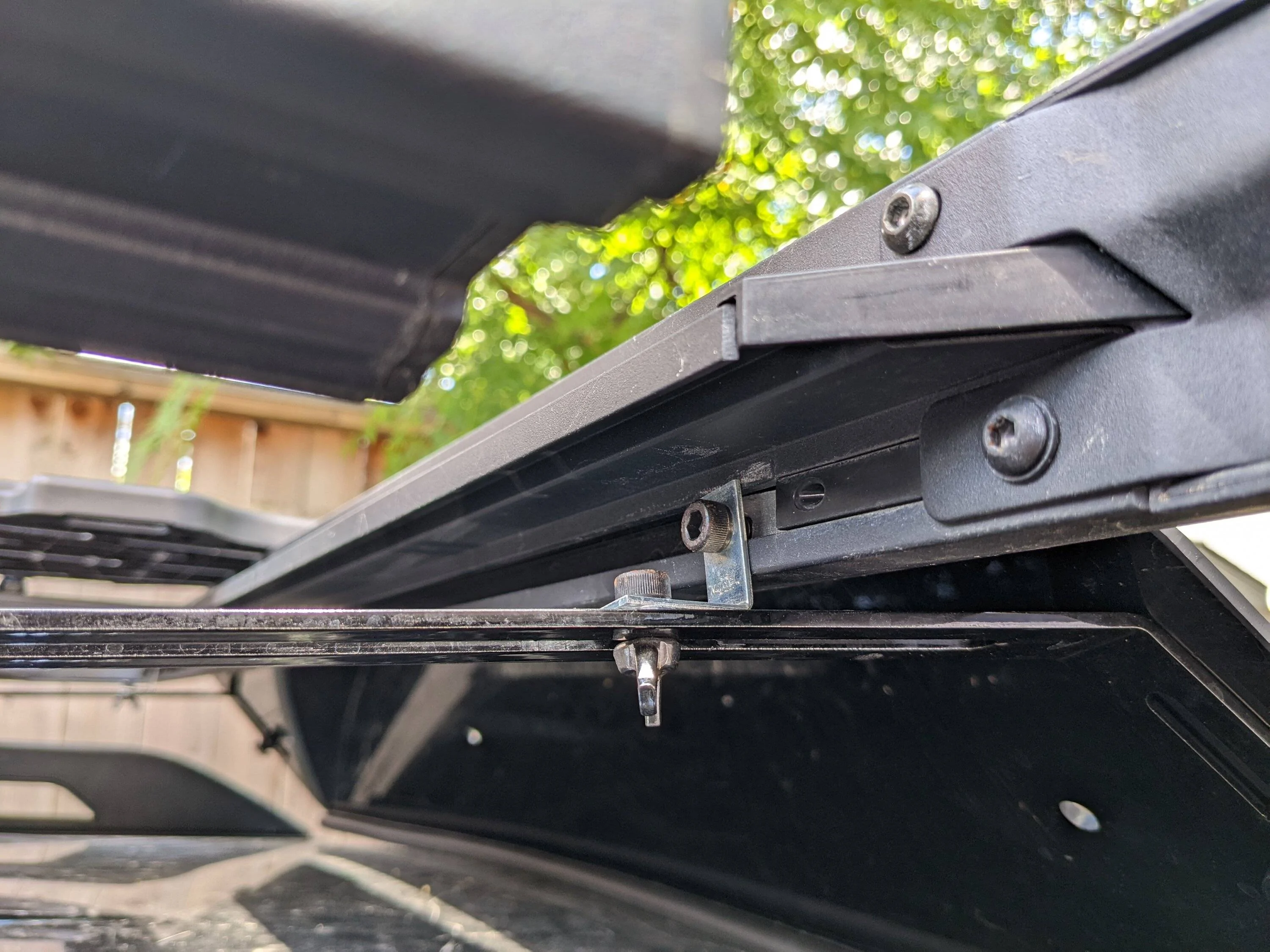

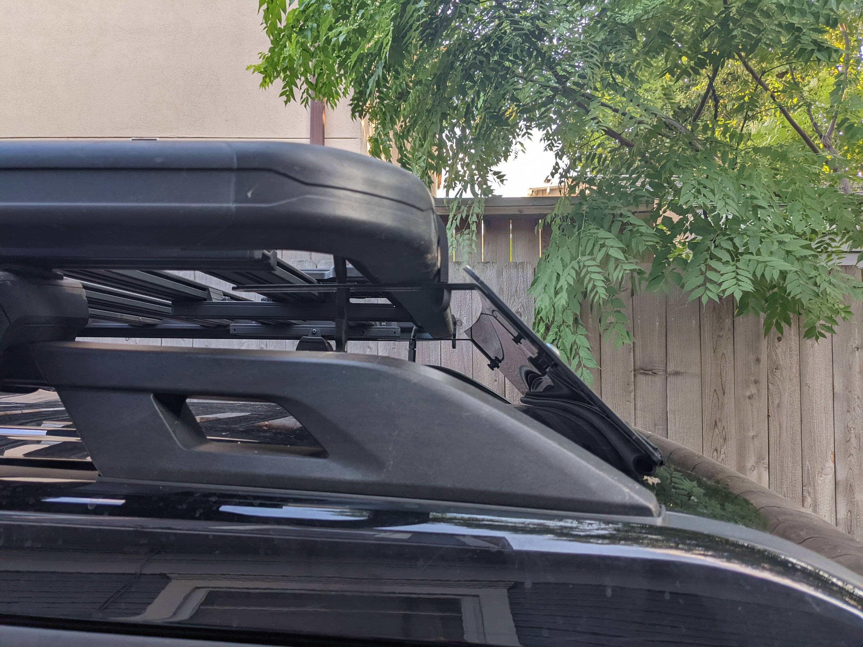

I decided to use this slot to mount the wind fairing, which avoids taking up space on the top of the platform.
The slot is a uniform width the entire length and does not have an easy way of fitting standard t-bolts that fit the top into it, as a result. It's the same inside dimensions, but without a larger opening, you're limited to things you can angle in. I happened to have two trapezoidal t-nuts from a different product that could be easily "angled in". I'm sure there's a cheaper and easier place to find them, but they were these: https://moonfab.com/products/sprinter-rail-anchors
I picked up some M6 machine screws and small L-brackets from the hardware store to put together a way to mount the fairing. This wound up being much more secure and fit a lot better than the default way of mounting the fairing:
Ford Bronco Sport Colorado Fairing Co Wind Fairing + Yakima Platform Mounting on Bronco Sport PXL_20220917_172712357
Ford Bronco Sport Colorado Fairing Co Wind Fairing + Yakima Platform Mounting on Bronco Sport PXL_20220917_172718468
Ford Bronco Sport Colorado Fairing Co Wind Fairing + Yakima Platform Mounting on Bronco Sport PXL_20220917_172747465
The wing nuts will shake loose eventually. They were only temporary, as the hardware store happened to be out of lock nuts in the right size. I've since replaced them, and with lock nuts, I haven't had any issues with things shaking loose.
I'm very happy with the result overall. It looks good, I have full use of the top of the platform, and it seems even more secure than the default method of mounting the fairing. I didn't use the third/middle mounting bracket, as I didn't have a third trapezoidal nut, but two seems quite secure when they're bolted in place, and I don't feel like I need the third.

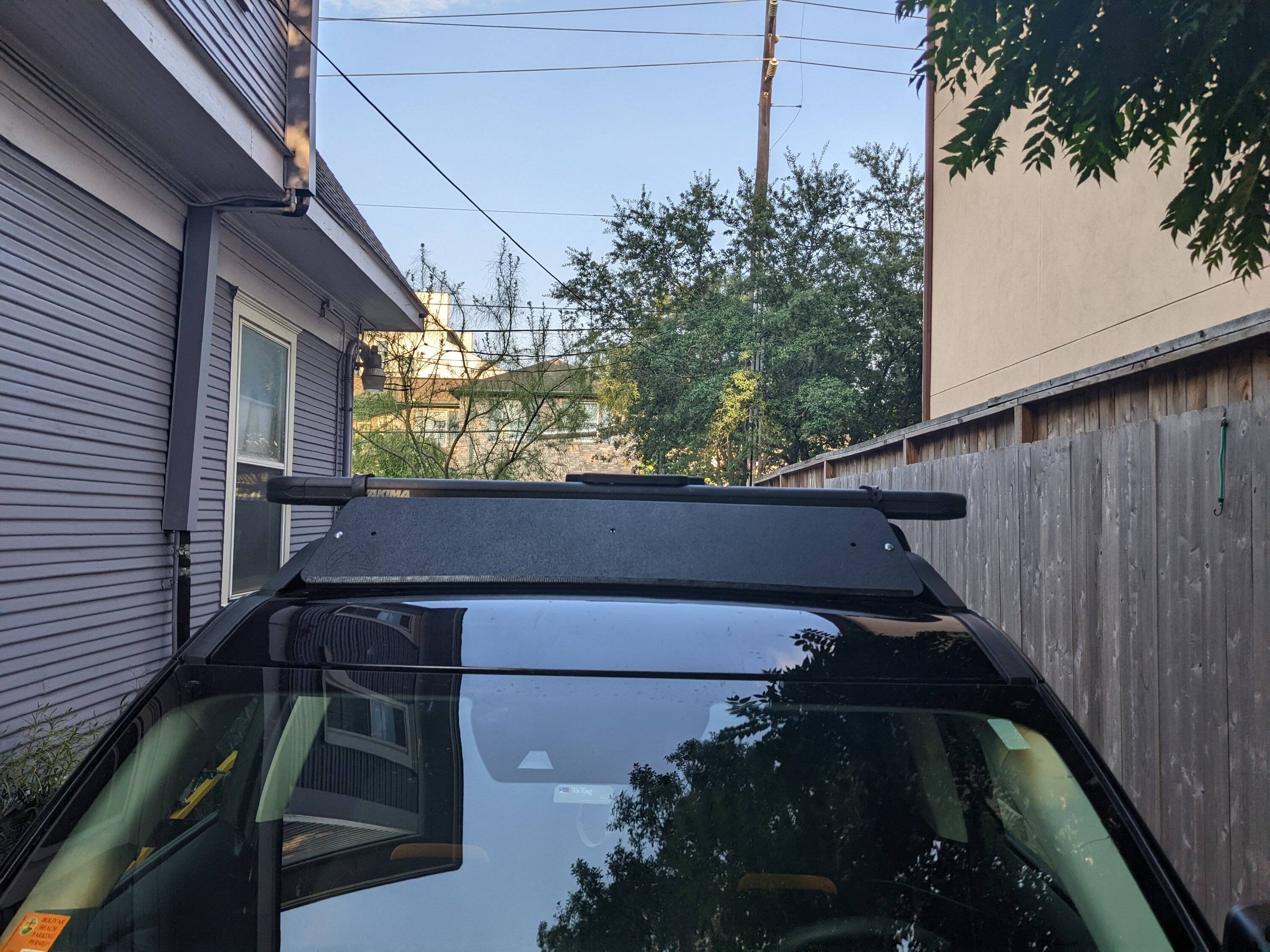

I've since adjusted it a bit to have a bit more of an outward curve, and it fits perfectly. There are no longer the small gaps you'll see at the corners below. It just needed to bow out in the middle a bit more, as it's designed to do.
Ford Bronco Sport Colorado Fairing Co Wind Fairing + Yakima Platform Mounting on Bronco Sport PXL_20220917_172813380
Either way, I like it, and I'm kinda kicking myself for not getting one of the fancy color/skin options on the fairing!

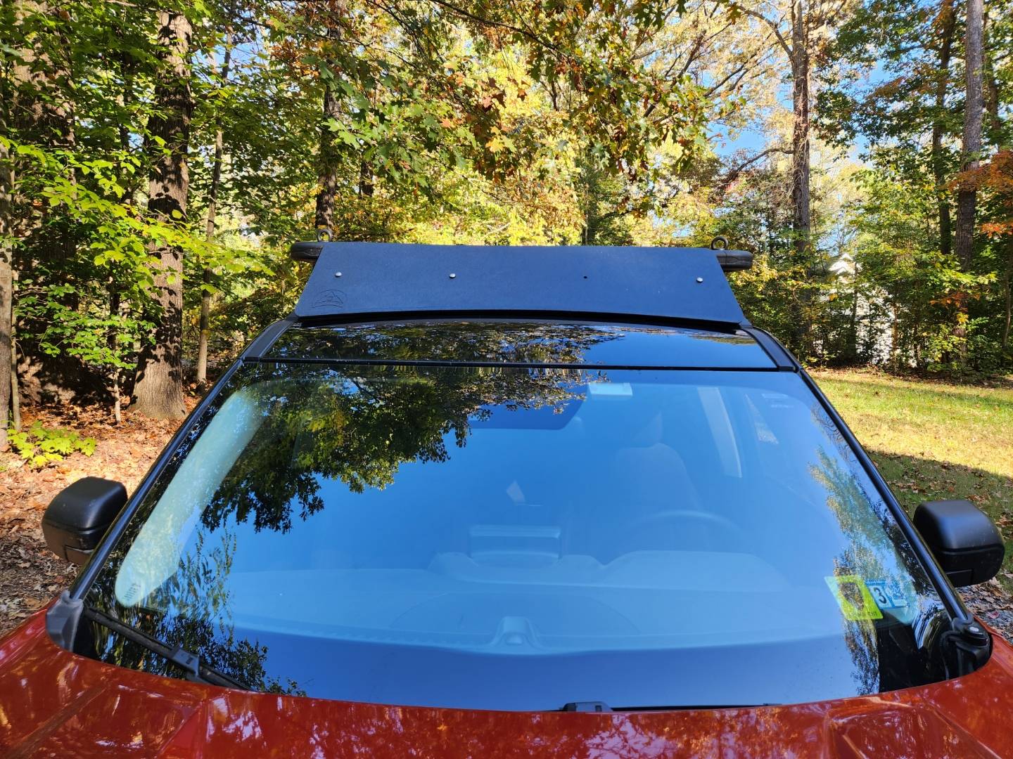

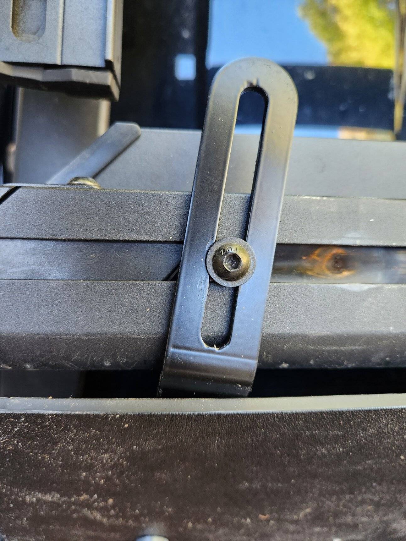

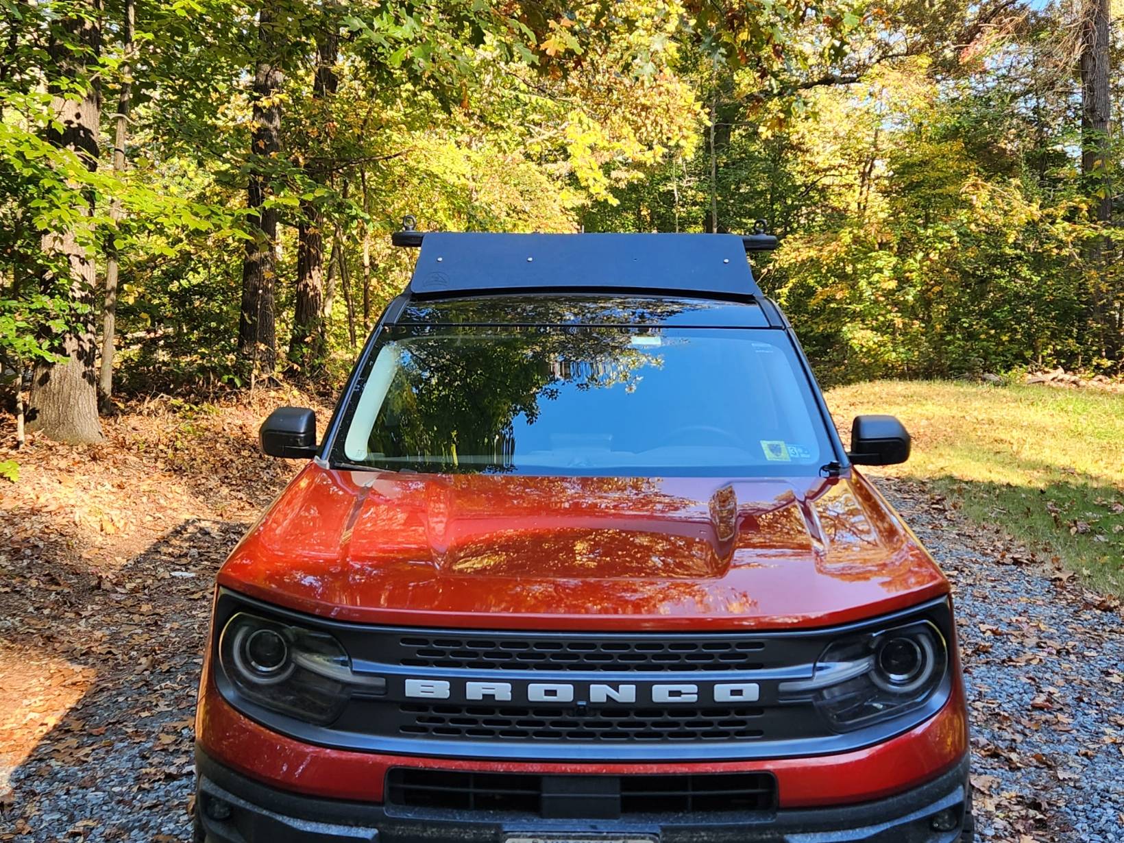

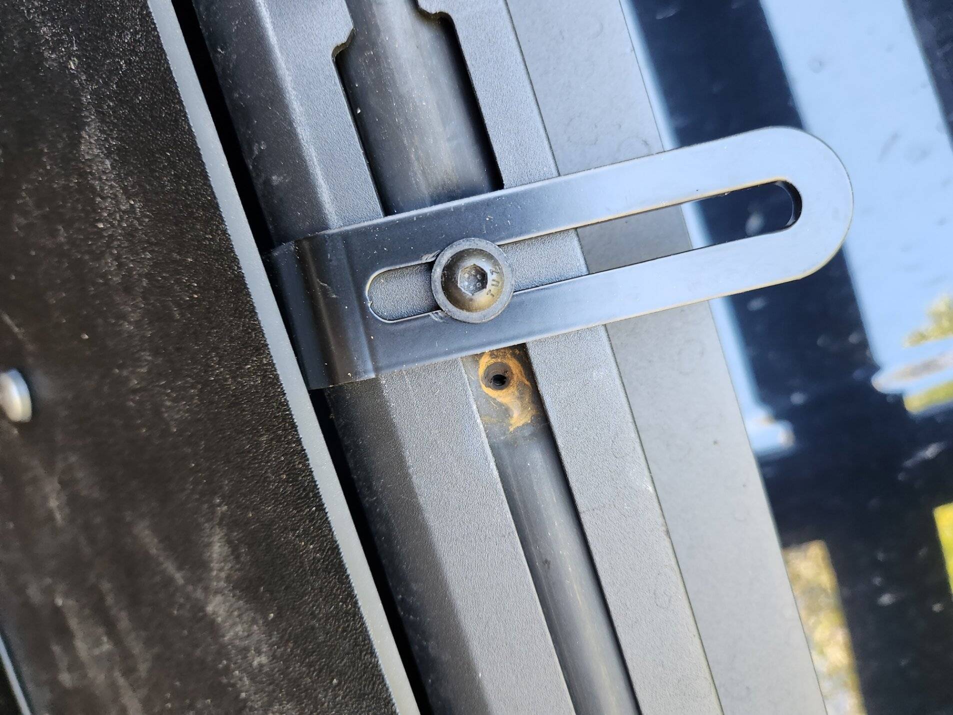

bbednar
Brad
Feb 15, 2023
South Dakota

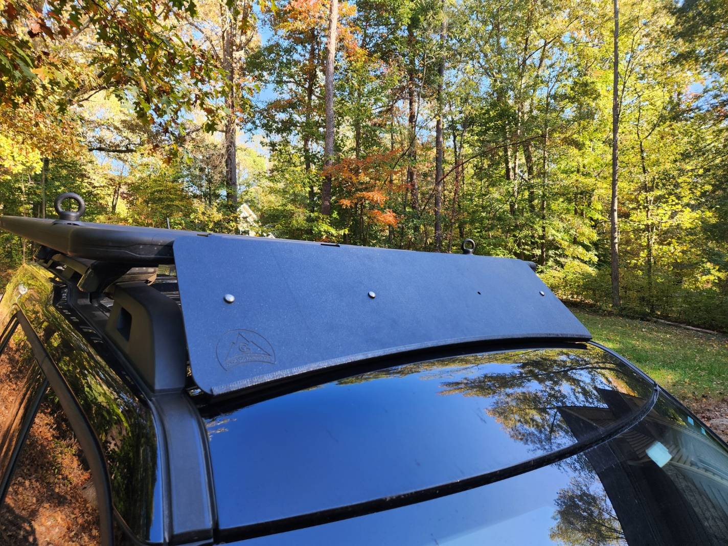

Here's another option for you, 46" x 12" Colorado Fairing Company Fairing with a reverse smile.
