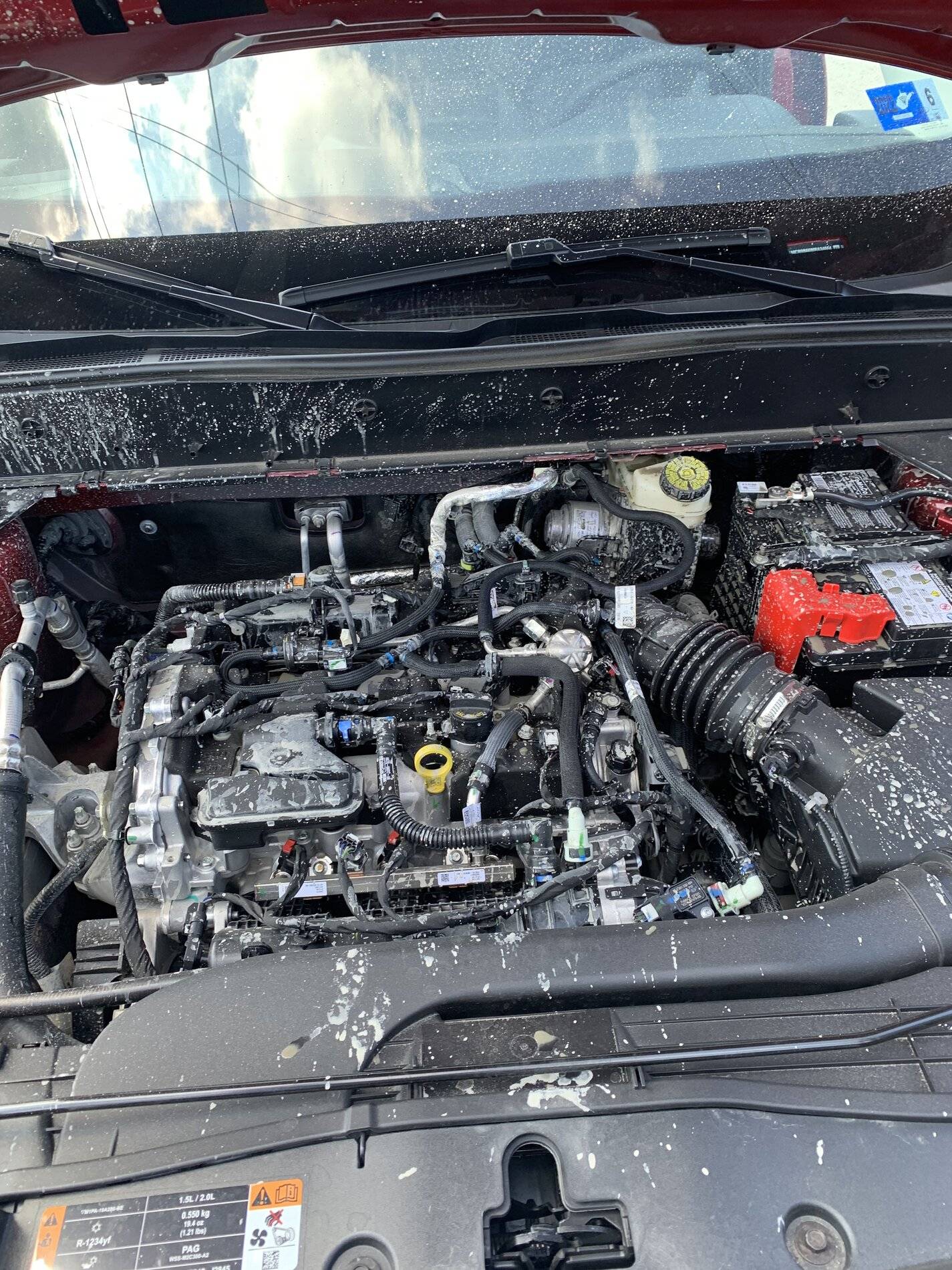

Did a little mudding today and the engine bay is no longer clean.
How do you go about cleaning the bay and what do you use?
Thanks!

foam gun with something like simple green followed by a low pressure rinse.

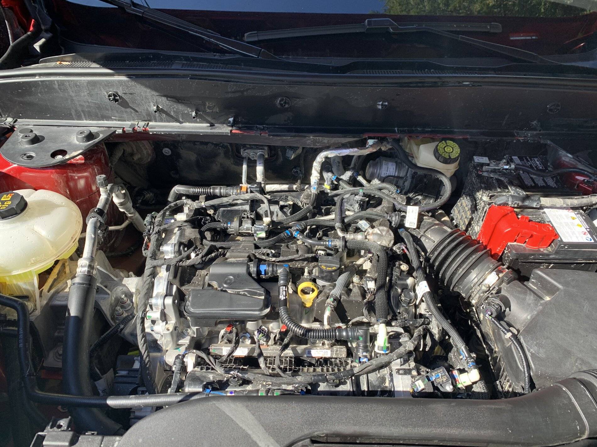

Very tedious. I could have probably spent another 2 hours on it. I sprayed where I could. But most of the cleaning was using a wet towel.
That was gonna be my guess as I was thinking to myself how could I clean this, as much of it can’t be just soaked with water? You made a very noticeable difference.

I bought some simple green to try next time I wash the vehicle. It has been recommended by several folks.
The manual that is link above doesn’t give a ton of instructions, but does say you can wash it.
Other instructions say to cover alternator and remove the battery. After that you can spray away.
I usually wash the BS once every two weeks. So the next I wash it I will try the simple green out. Unless I go mudding before then.
