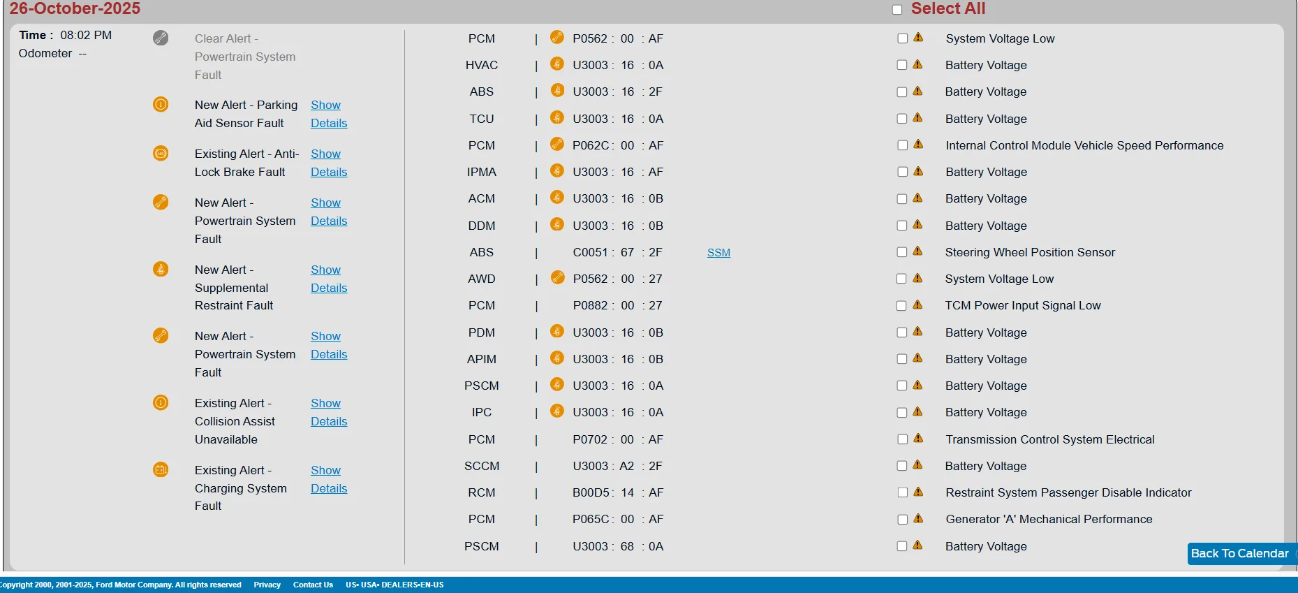

Ford Bronco Sport Charging System Failure + plethora of other error codes 1761773124612-bu
If I click on the 25S76 link and go through the motions, it shows the software update for that issue was released on FDRS on August 18th. Unfortunately, due to recent changes in Ford's cybersecurity, I cannot run your VIN through FDRS to confirm if there is a PCM update showing for your VIN or not.
The truck reported a boat-load of codes; most of them having to do with battery voltage. The last time it reported itself to the cloud, the battery SoC was recorded at 0% and voltage at 8.1%.

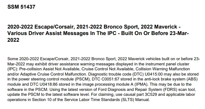

That one SSM referenced by the ABS code says it could be the PSCM software that needs and update. This would not be covered out of warranty, though:
Ford Bronco Sport Charging System Failure + plethora of other error codes 1761773625893-4a
You'll have to wait until it gets into the hands of a tech and they start the diagnosis process. It does not seem (to me) like this will be very difficult to get to the bottom of once they start working on it unless there is some parasitic draw somewhere that will require them to run pin-point tests on the figure out, but that would not be covered outside of warranty, either, so hopefully the recall resoves it.
