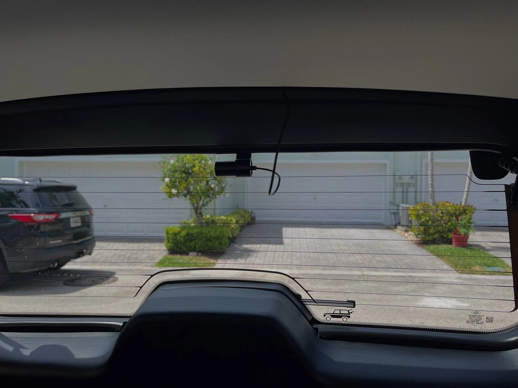

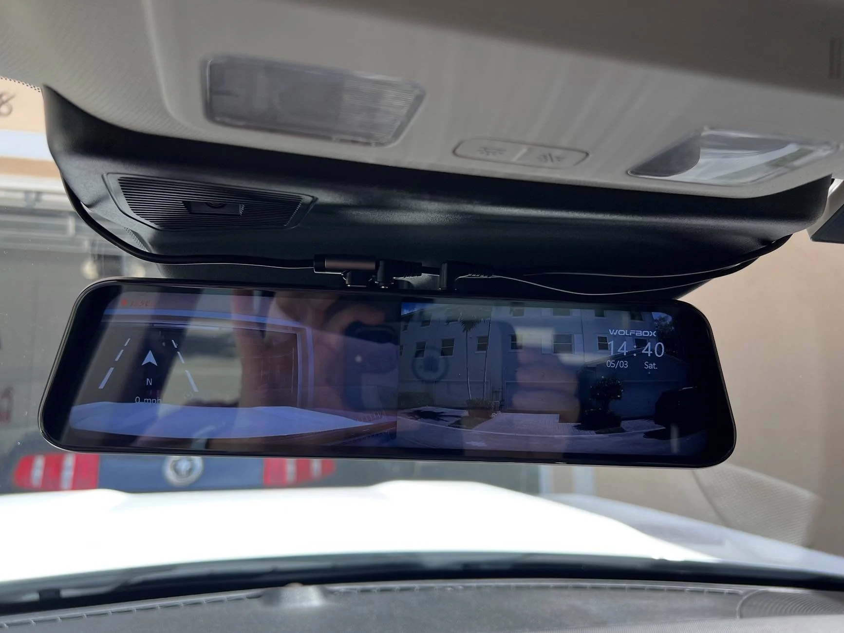

The grocery store parking lot is the place I find the backup camera and object detection to be the most helpful. Example: Impatient drivers zipping past while you are backing up and small children walking behind the vehicle, which with a high lift gate you are likely not going to see.
Even with the OEM backup camera, I replaced the OEM mirror with a WolfBox mirror dash camera with a rear camera so I have evidence for my own protection.

How have you been liking the Wolfbox? I'm looking at the same one (front & rear). Is it permanently mounted, or did you use the straps?

I've had a G850 hardwired in my '10 Mustang since December 2022. I used the straps in order to keep the OEM mirror which has the microphone for phone calls. Wolfbox sent me a replacement G850 mirror when I reported the compass would incorrectly report NE heading when traveling in the NW direction. They eventually fixed the compass heading problem in a firmware update. It's been working great, even in the Florida hot tropical sun.
I purchased an i05 for my BS as I had plans to install an auto dimming mirror from a '24, but found out the small headliner wiring pigtail in the '25 uses a completely different connector than the '21'-'24. Since I had a spare G850, I purchased the permanent mirror mount and connected the i05 rear view camera to the G850. To route the wire for the rear camera, I removed the overhead console and used a fish tape to pull the wire down the center of the headliner to stay away from the curtain airbags. I mounted the GPS puck near the top of the windshield and tucked the excess wire above the overhead console. I did run the included power cord down the A pillar making sure to not interfere with the curtain airbag squib wires. On the '25, the power port default timeout is 30 or 45 minutes. I changed it to 5 minutes so I don't have worry about excess battery drain with it plugged in all the time. The only downside is the rear camera is pointed through the tinted back glass which is OK during the day, but at night you get halos from bright lights. A small compromise since my BS is a lease. I didn't want to install anything permanently that could not be easily removed.
In summary, a dash camera is absolutely necessary to protect yourself from liability. Also makes me a safer driver since I know it could be used against me. I have no complaints with the Wolfbox brand of dash cameras. For anyone considering a dash camera, I recommend watching the following unbiased and technical comparison of dash cams.

Great info, thanks!
