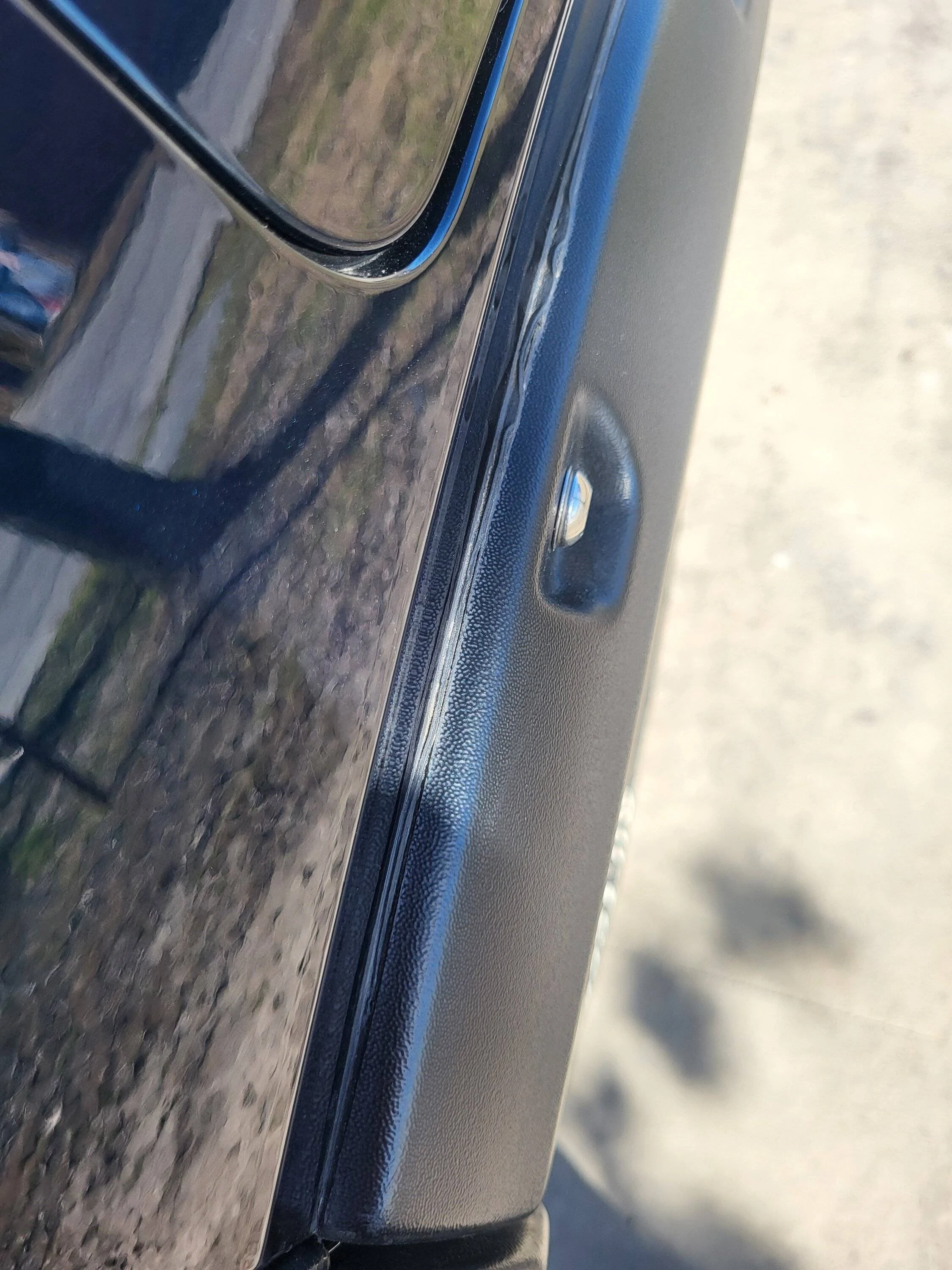

Before
Ford Bronco Sport Bushwacker Fender Flares U-Clips 20240131_141401
After
Ford Bronco Sport Bushwacker Fender Flares U-Clips 20240131_141353
I just took these, the after is my driver side rear which kept falling off, before is passenger rear, after applying the 3m tape, I used some black silicone so dirt wouldn't keep getting stuck on the 3m, note I never got replacement clips
