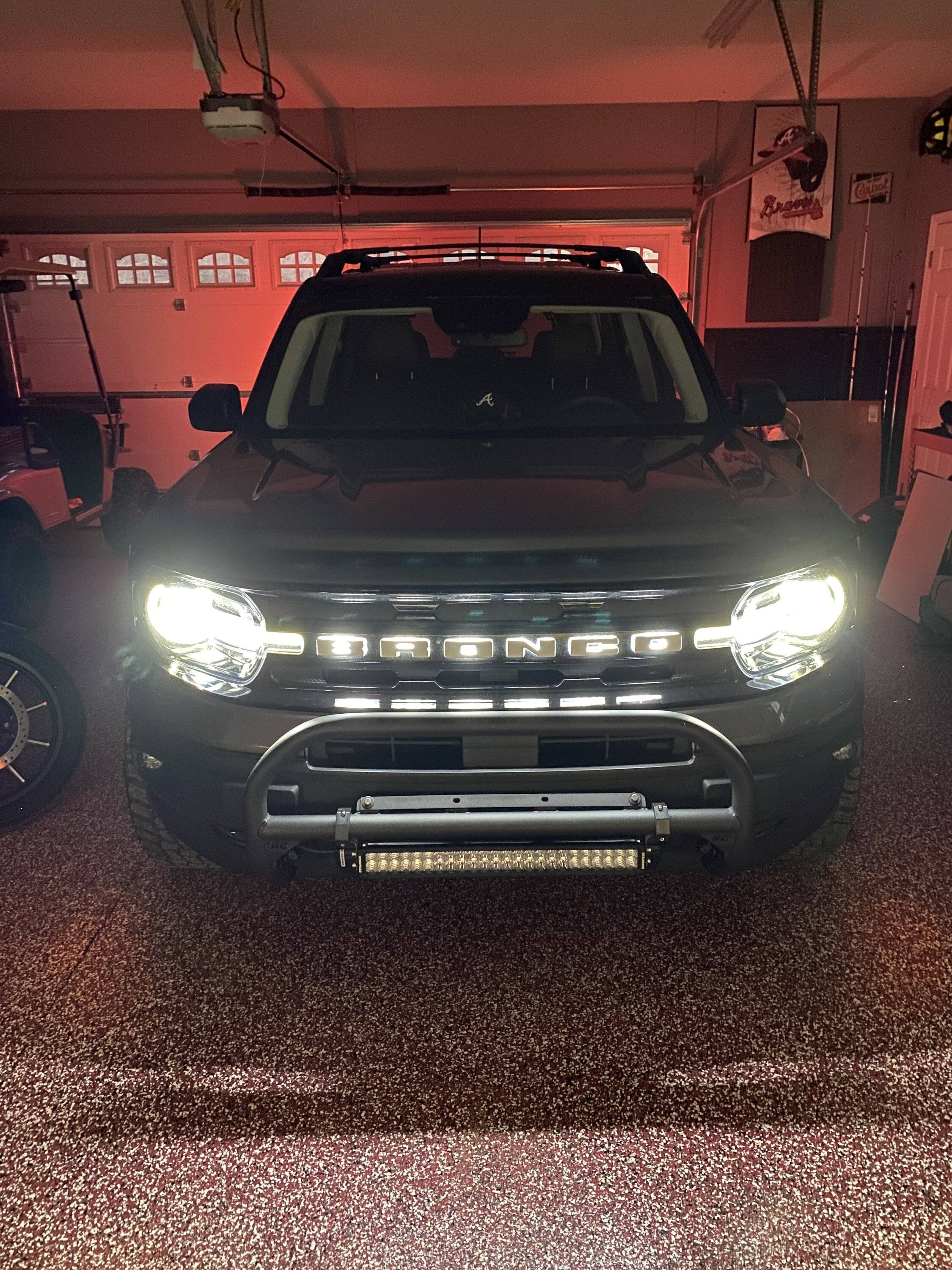

Did you do your Oracle lights yourself? Hopefully you were able to take a peek at my previous thread, if so. I found them to be a bit of a pain but 100% worth it.

Yes I did them myself. I ended up wiring them to an Auxbeam panel along with the bar light.

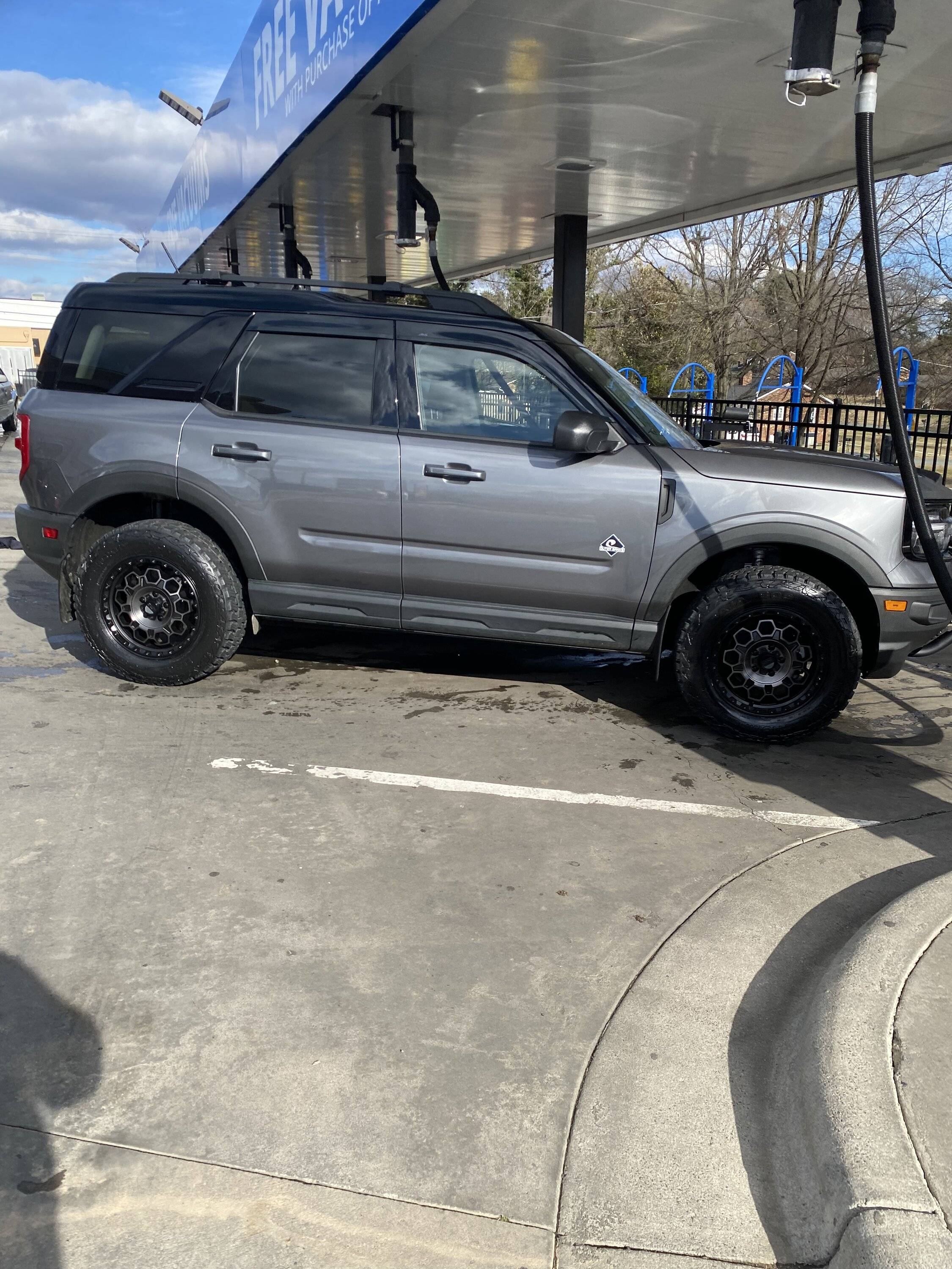

What size are your tires and how is ride quality?

245/65R17 on 17” KMC Trek Satin black w/ grey tint 5x114.3 and 35mm offset.
Ride quality is ok. It’s not as good as the stock ride. The tires do barely rub fender liner at full lock. My guess is a couple more miles and they will not rub any more.

Thanks for the information on the size of tires and the rubbing. I know Meanderthal mentioned he had similar issues. I've got a 1" Spacer (your Adapter/wheels are fire man, what did you use? Can you post a link? Wondering if they have a 1" adapter), and am limited to the 235's if I don't want to rub.
Your ride looks damn good though. Read that as Tire/Wheel Jellies...

Adapters came from titan wheel. https://www.titanwheelaccessories.com/products/32mm-1-25-titan-5x108-5x4-25-to-5x114-3-5x4-5-wheel-adapters-12x1-5-studs-set-of-4
Wheels and tires came from Rimzone online.

Lane, did you have to remove the front grille & bumper assembly to install the nudge bar?

Yes. I did the Oracle lights and the nudge bar at the same time.
