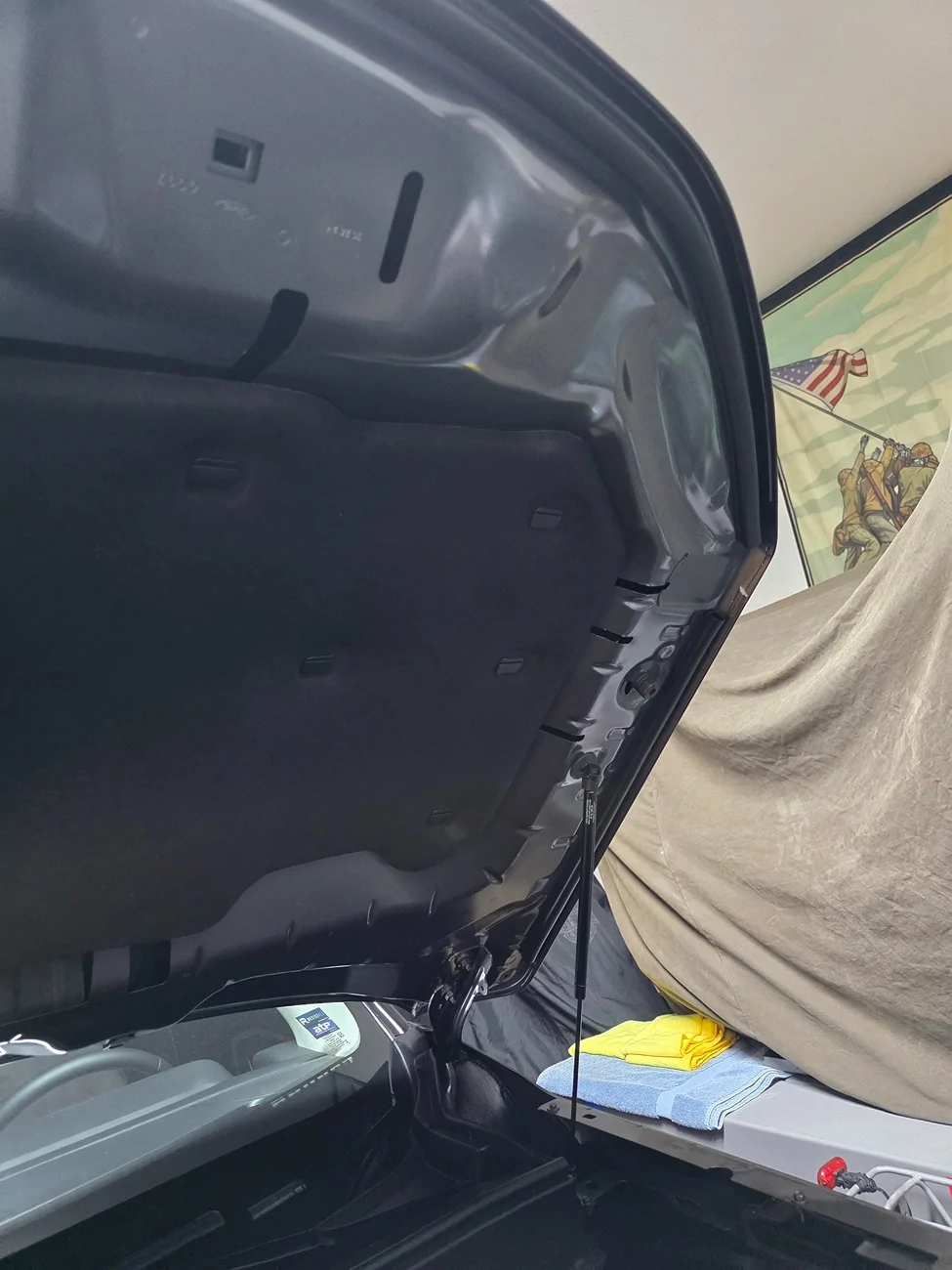

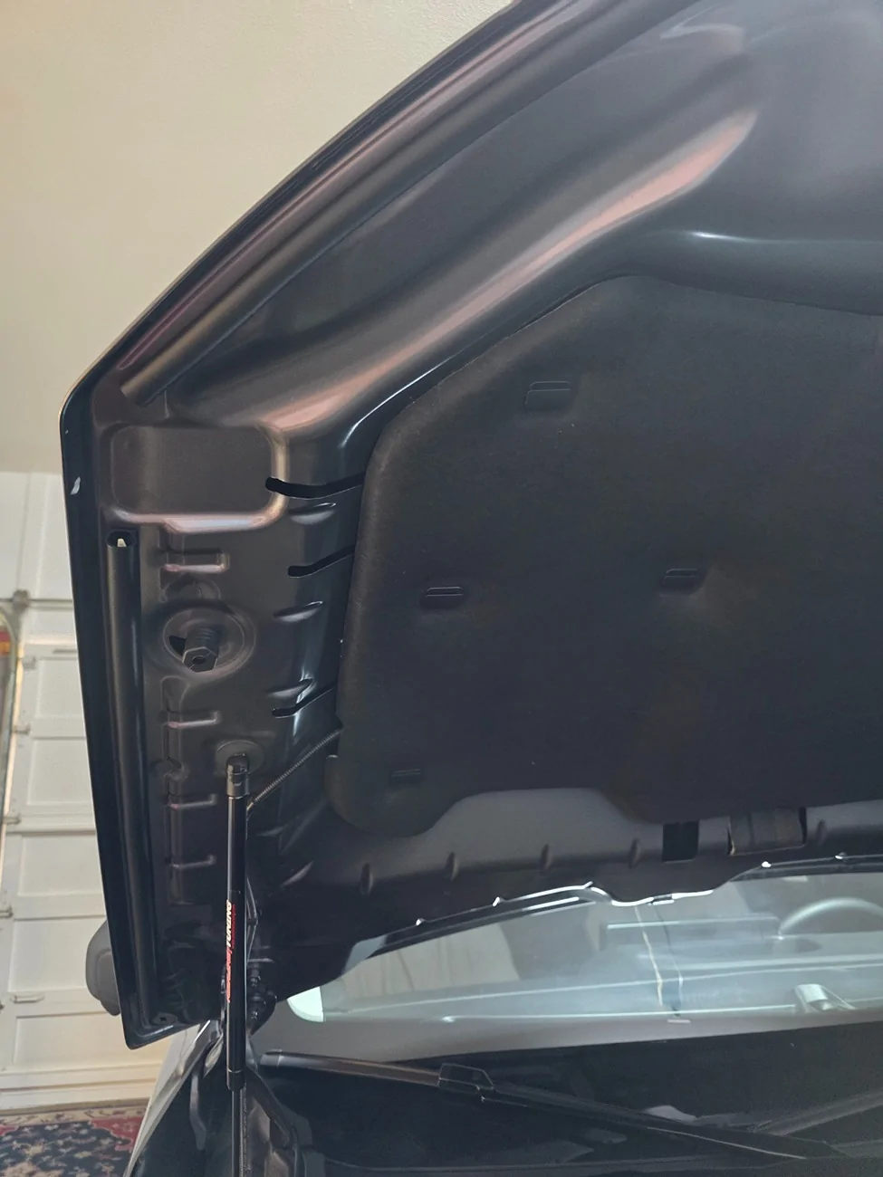

Hi dude mine are
The 2 lower ones ar 3 and 3/8 from the bottom plate
The 2 upper ones in the hood are 13/16 ths from the hood in the front
I believe this is what you were asking ?
Ford Bronco Sport Bug guard or don’t bug gaurd. IMG_0125
Ford Bronco Sport Bug guard or don’t bug gaurd. IMG_0124
Ford Bronco Sport Bug guard or don’t bug gaurd. IMG_0116
Ford Bronco Sport Bug guard or don’t bug gaurd. IMG_0115
Yes! Thank you!
Just adjusted them. Let’s see what happens. 🤞🏻

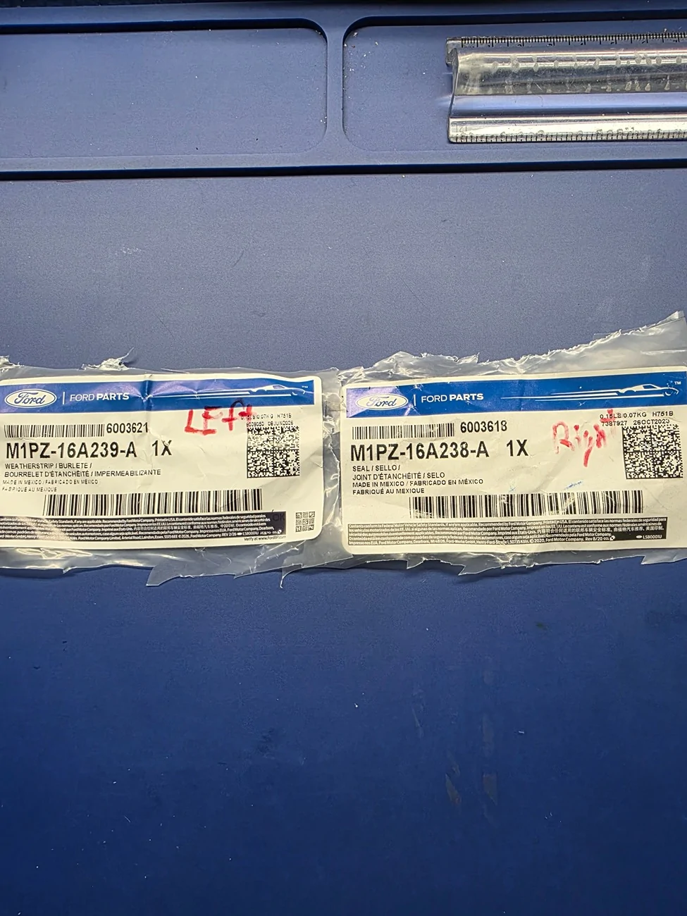

see attached photo, I actually bought an extra set for my 2022 Badlands. The grey fasteners on the molding snap into the underside of the hood on driver and passenger sides. Not sure if the part number works on your vehicle double check with parts at your dealership.

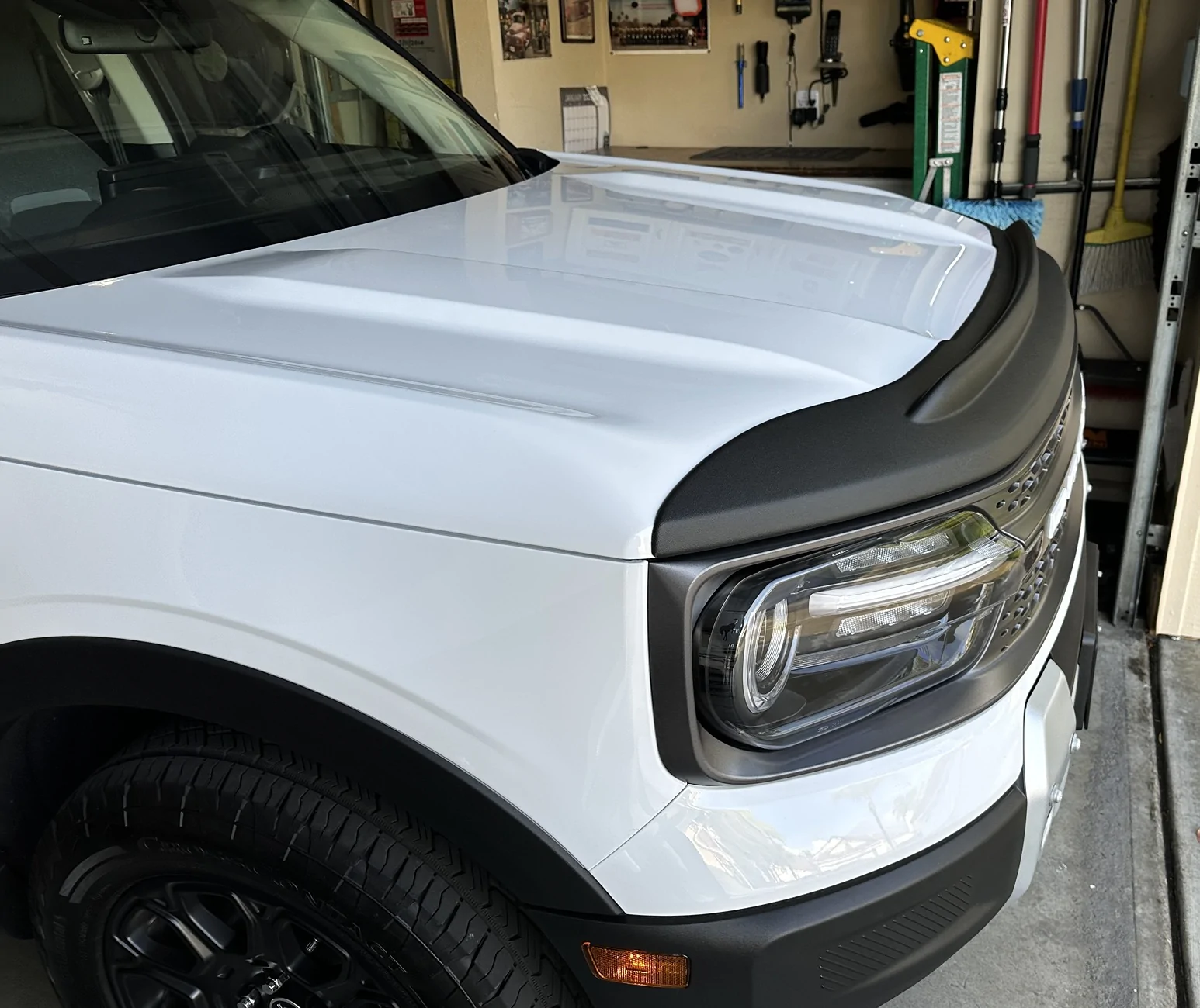

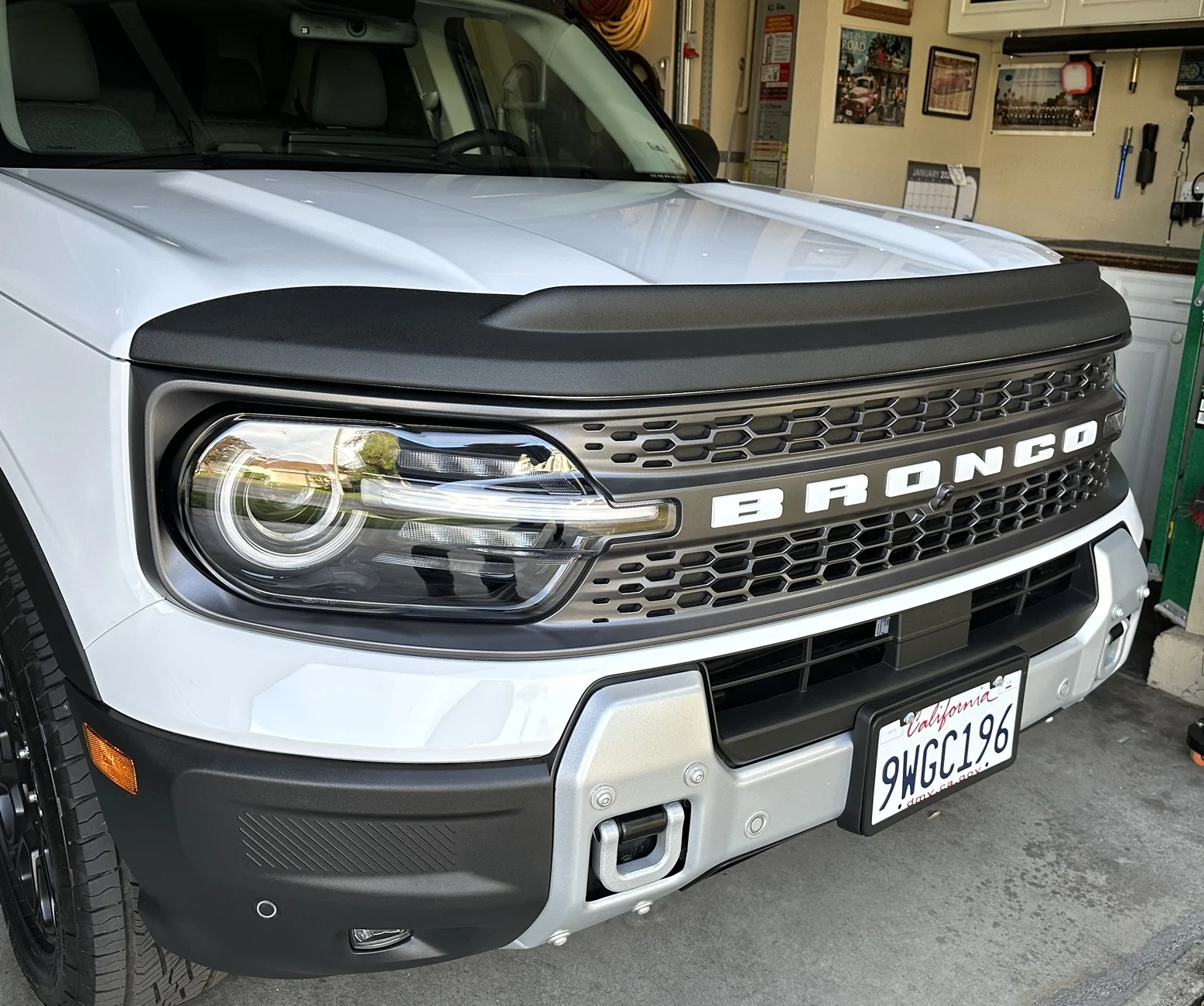

After reading your post, I ordered a set as well. I have a 2025 Badlands, and I had to call them because they would not accept my order without verifying the VIN. As you can see, they snapped right into place.
