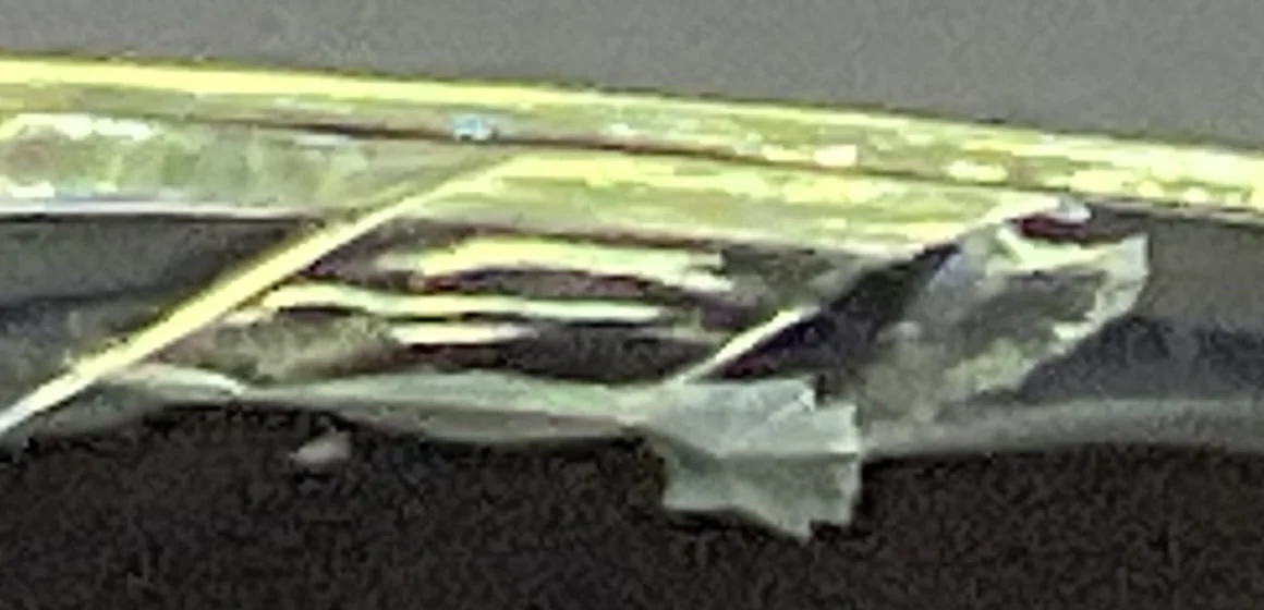

I am embarrassed to admit that I ripped the antenna out of the roof of my 2024 Bronco Sport backing out of my garage and it got caught on the door because the door wasn’t open enough to pass through ☹. We bought the identical antenna to replace it but can’t quite figure out how to drop the headliner so we can secure it from underneath the roof.
Anyone have any tips, tricks or videos they can share? We already fixed the dent it created just not sure if we have to drop the entire headliner.
All advice is welcome and appreciated!

According to the workshop manual, dropping the headliner is needed. You also need to remove the A, B and C pillar trim covers to drop the headliner. All relevant info is attached.

WOW….this is awesome info and exactly what we need. I can’t thank you enough!
