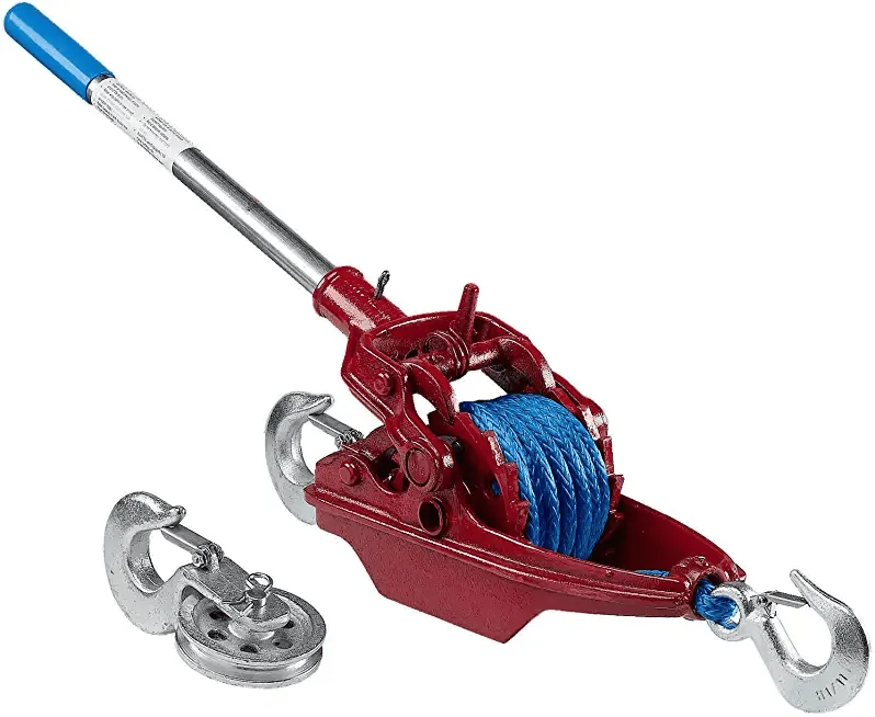

I have my spare on the roof so I use the space for recovery storage.
I have a shackle receiver for the rear and have the hooks up front. I have a bunch of straps, shackles, an 8k come along, snatch block, compressor, plus bunch other stuff. On my jeep I needed a dedicated winch. This for the few times I’ll need it works for me.
You could put a winch on the BL. But would have to fab almost a pull bar style plate out front and then mount a winch. So you’d add probs 60-80lbs or more out front.
That would suck without a complete suspension. The front already hits everything off-road without the weight
