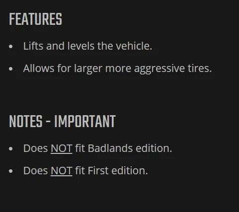

Interesting notes... unless there is a different kit number for BL/FE.
Nov 12, 2020
New Jersey
2008 Grand Cherokee Overland
Somehow I completely missed that very important bit of info. I need to drink more coffee before looking for parts. Thanks for sharing it. They seem to only have the one kit on the site. Hope they have one for the BL by the time I order one in the next couple of months.
