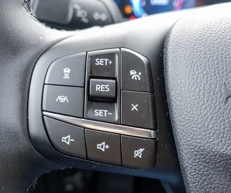

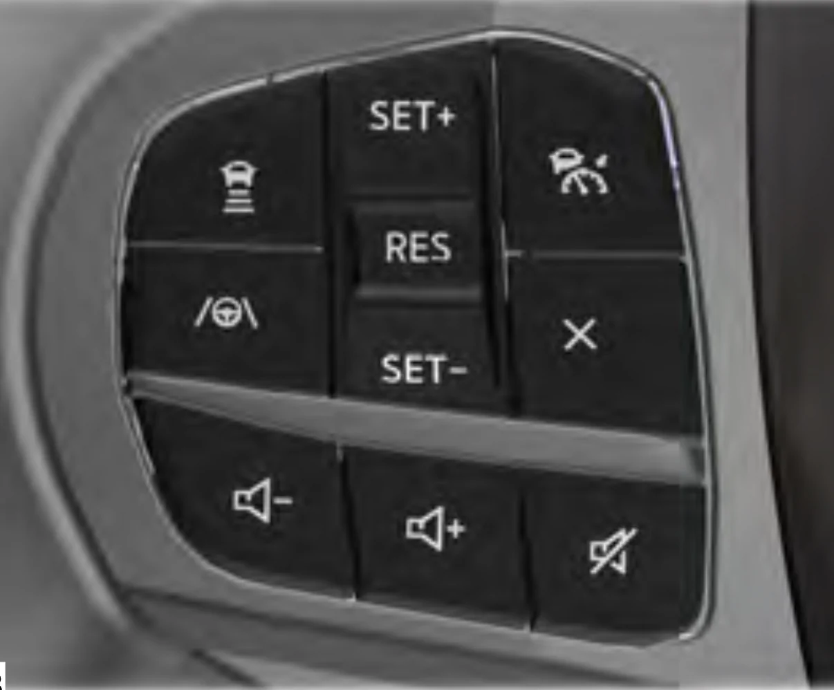

With Lane Keeping set to on (the push button on the end of the turn signal stalk) the vehicle will bounce back and forth in the lane. When you use your turn signal Lane Keeping will be paused as you change lanes.
Lane Centering is only available with adaptive cruise control. This will keep the vehicle centered in the lane (no bouncing) and will also steer the vehicle as the road veers to the left or right.
Look at the button controls on the left side of the steering wheel. If you have adaptive cruise control it will look like this.
Ford Bronco Sport Bronco Sport Driving Assist Help! IMG_0142
Adaptive Cruise will keep your set speed or read speed limit signs while driving. Your vehicle will also slow down and speed up according to vehicles in front of you.

Yes this is what ours steering wheel functions looks like. Thank you all so much for the knowledge you shared with me. Much appreicated!!!
