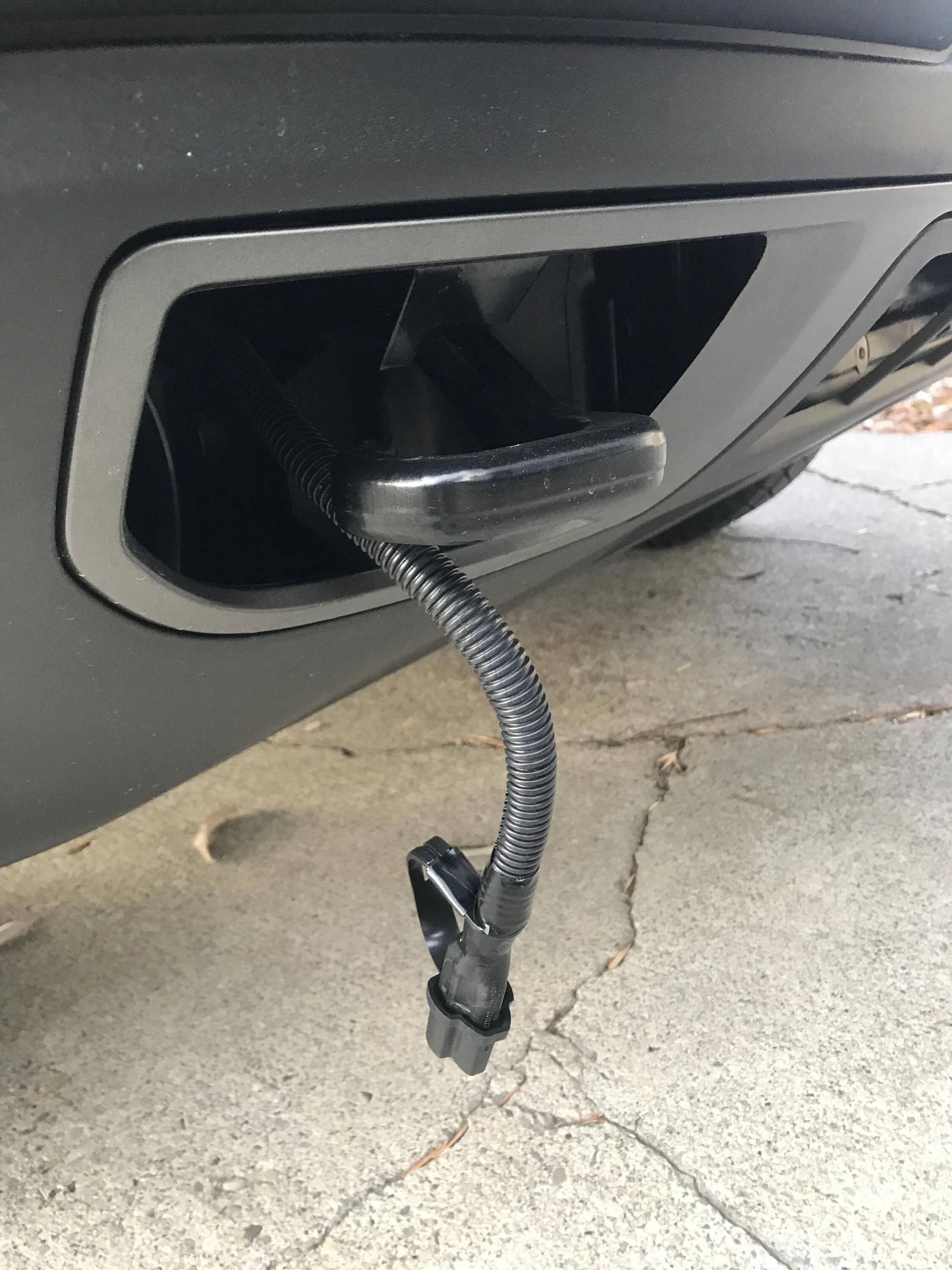

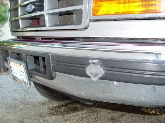

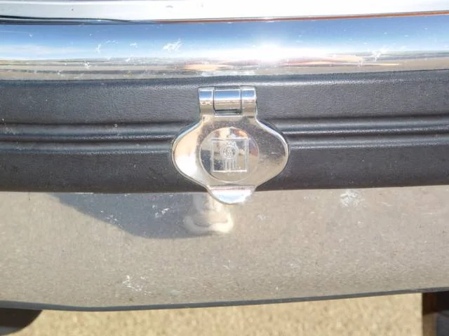

For an example, on my 7.3L Ford Diesel, I put a spring loaded cover/receptacle in the bumper and rerouted the cord to it. You just flip up the cover and plug in an extension cord. Mine is off a Kenworth, but there are other ones out there (like Marinco). Cheers!

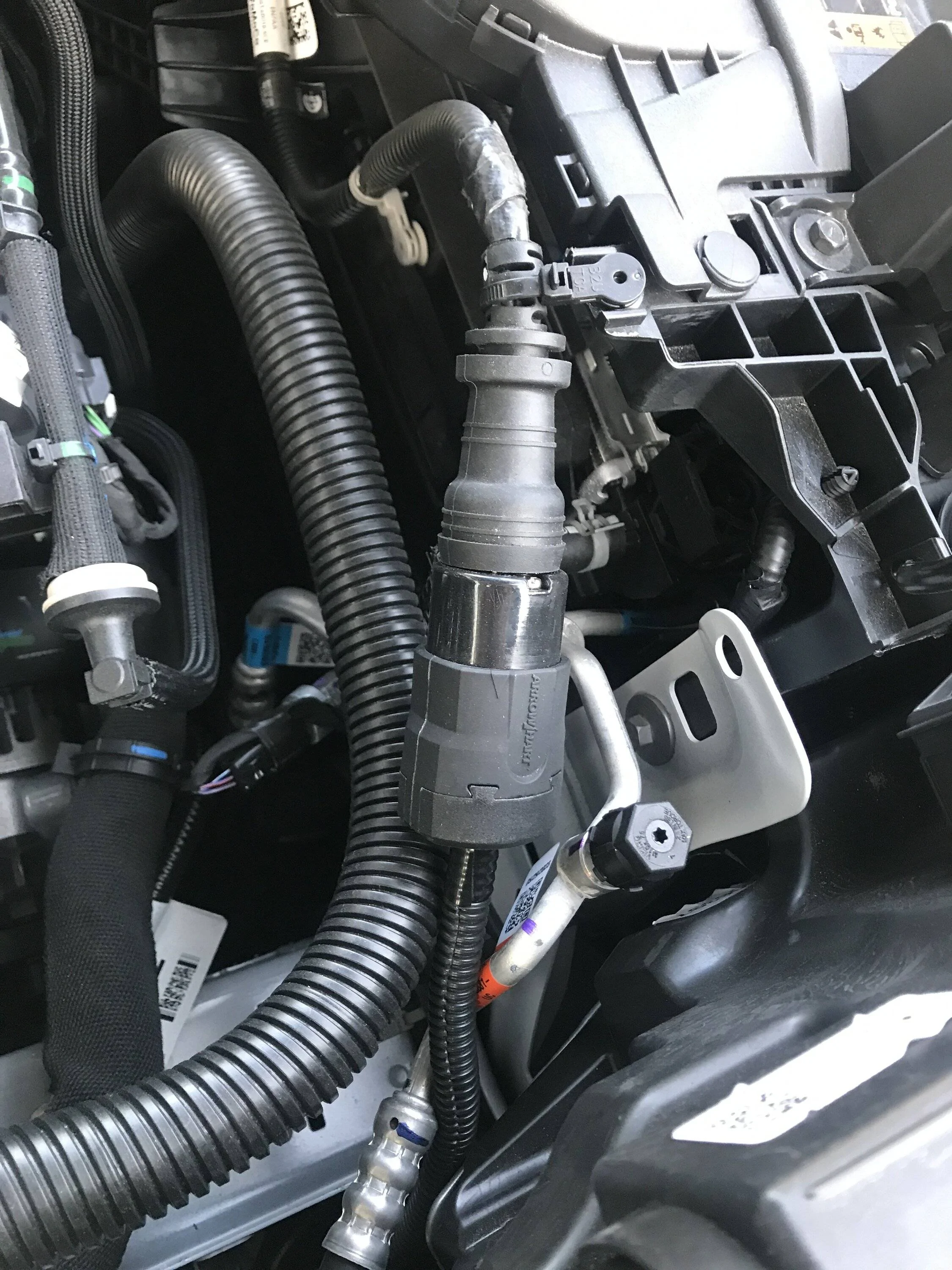

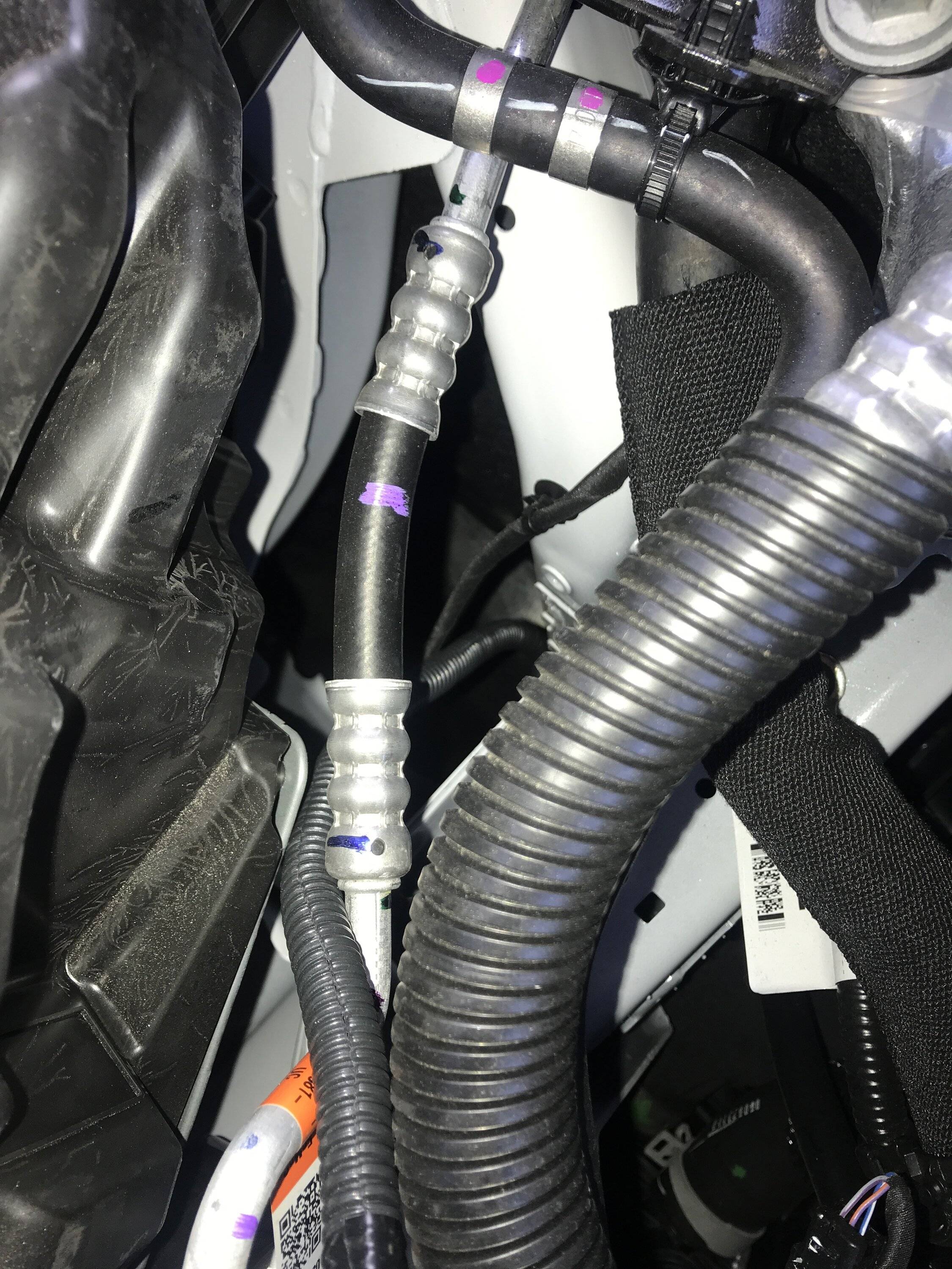

I took a standard block heater cord and modified it to run to where I have access on the outside of our Bronco.

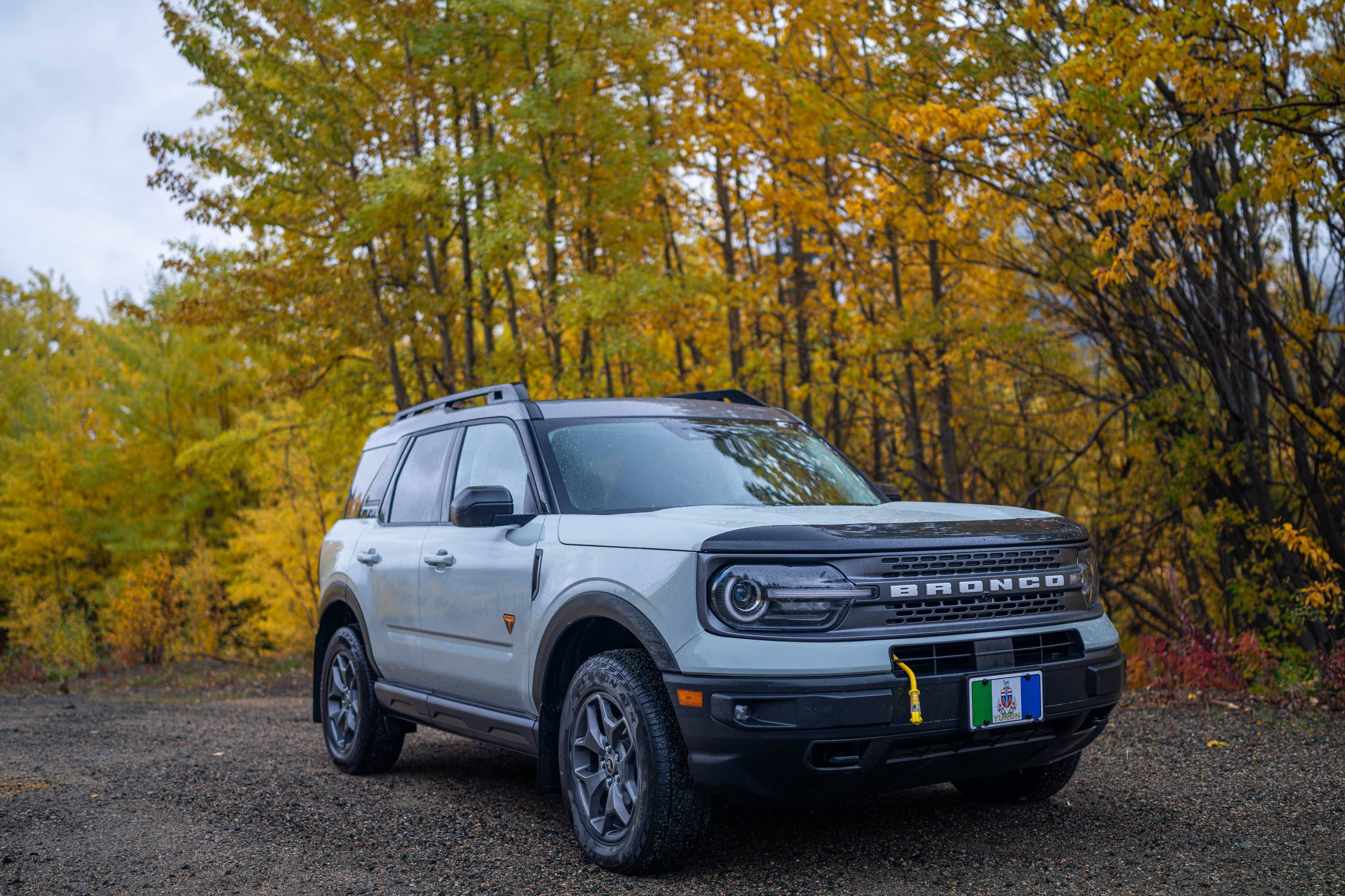

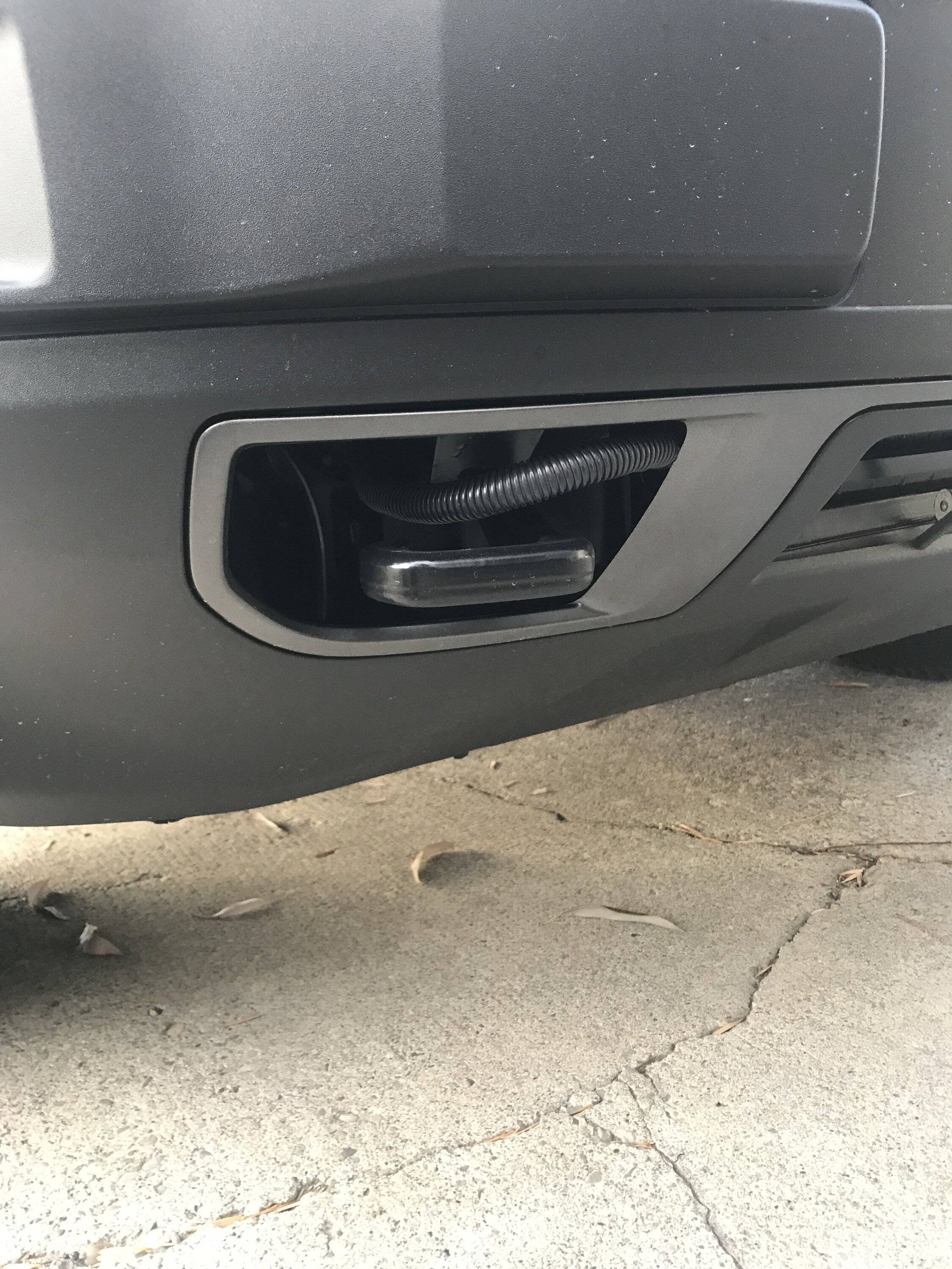

I've routed a 3ft extension cord behind the front bumper. It was a bit of work, but worked out really nicely.
I followed this video for how to remove the bumper (taking it off was pretty simple, but putting it back on the clips was a bit of pain). How to replace the front bumper on a 2021 Ford Bronco Sport Badlands - YouTube You dont't have to take it off entirely either, just get it off the clips upto ~halfway point
I think the results were worth it though as it looks really tidy and doesn't interfere with anything.
Ford Bronco Sport Bronco Sport Block Heater - Cord Rerouting 2

Nice clean work!

If you haven't already, I would suggest using dielectric grease to help prevent corrosion and possible water intrusion.

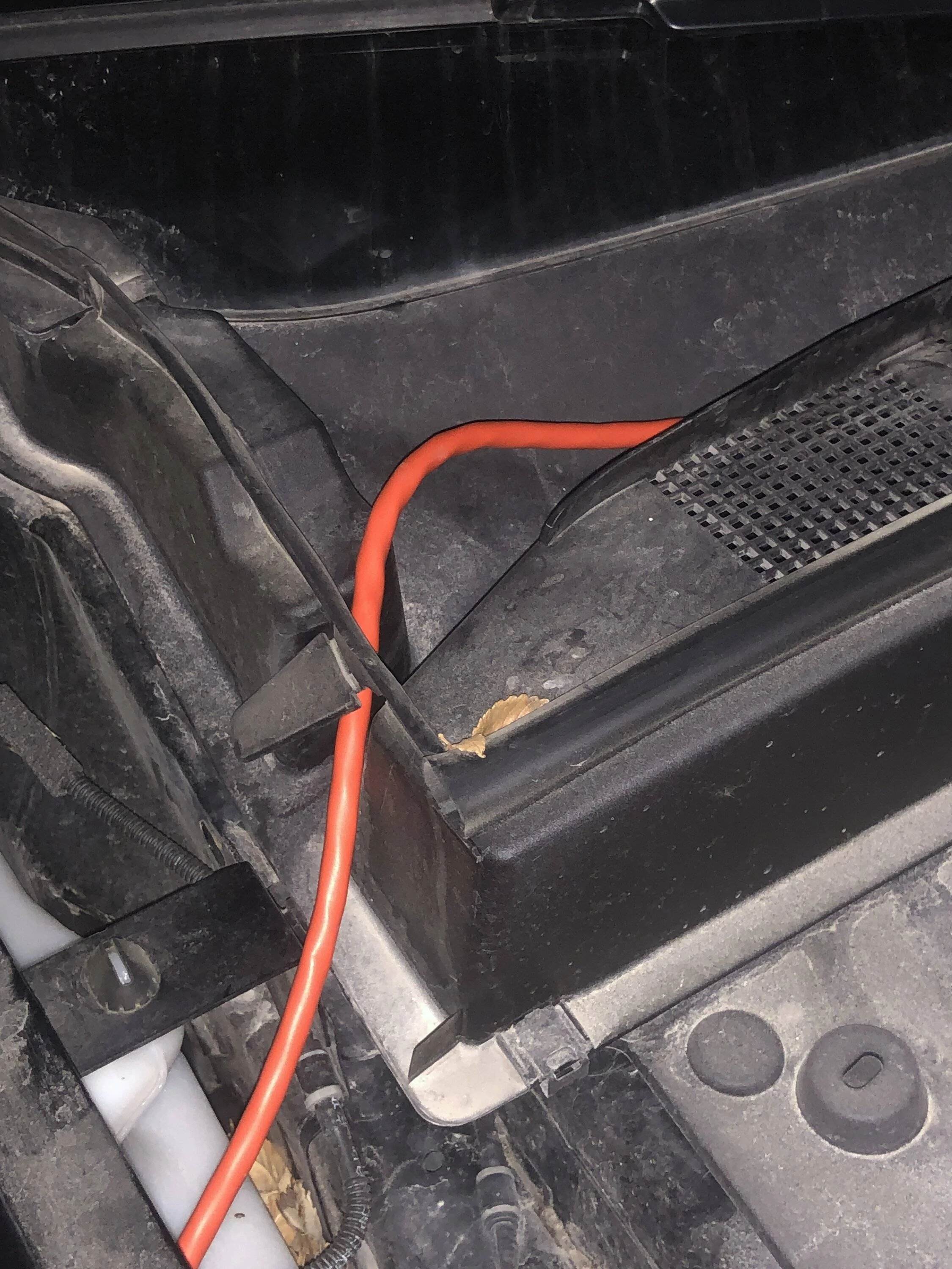

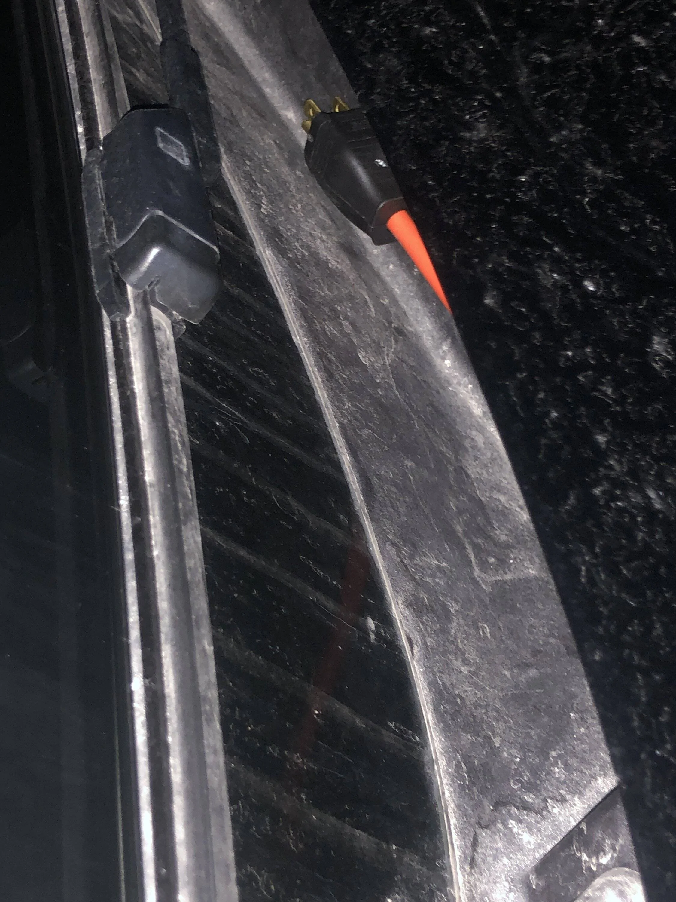

My reply above was from this time last year. When I ended up doing was obtaining a block heater extension cord routing it around the engine bay to the bottom of the windshield. Works beautifully.

Just zip tie it as you route it. I leave mine in year around.
