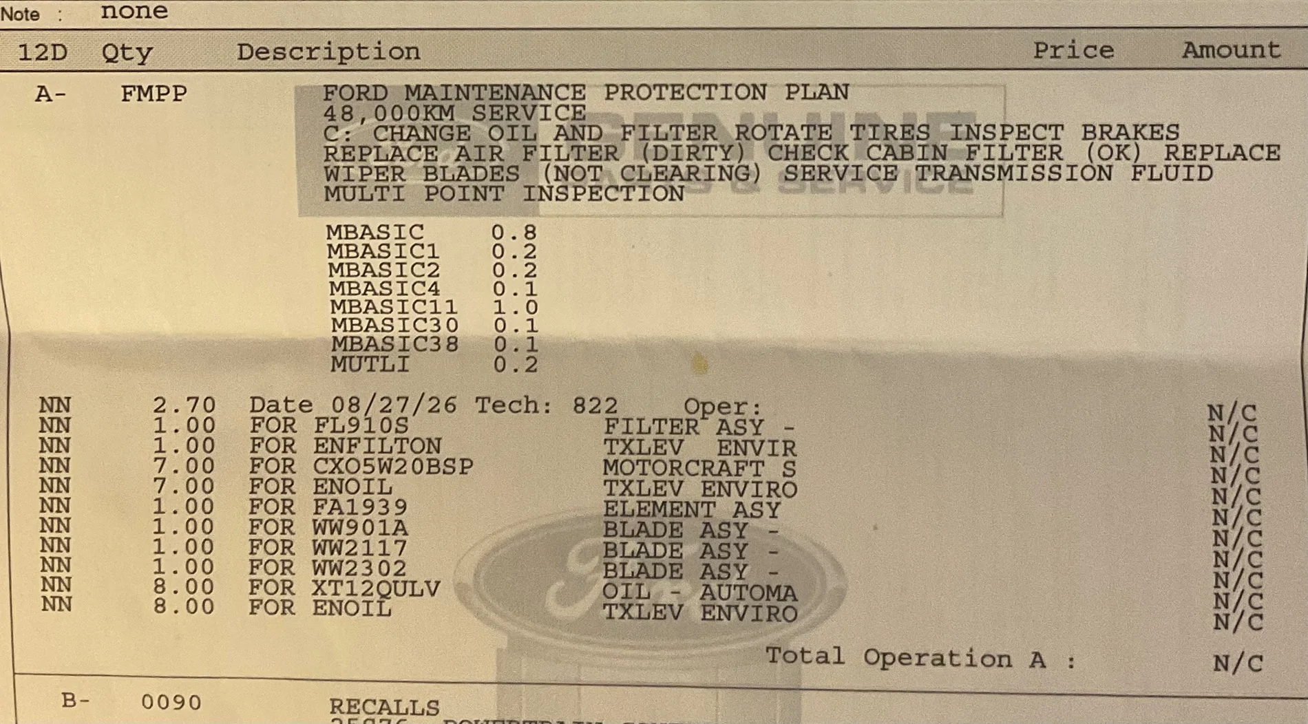

Yeah correct, the Work order describes it as a transmission fluid service. The advisor used the term “flush”. in checking back with the dealer it’s actually a drain and refill.
