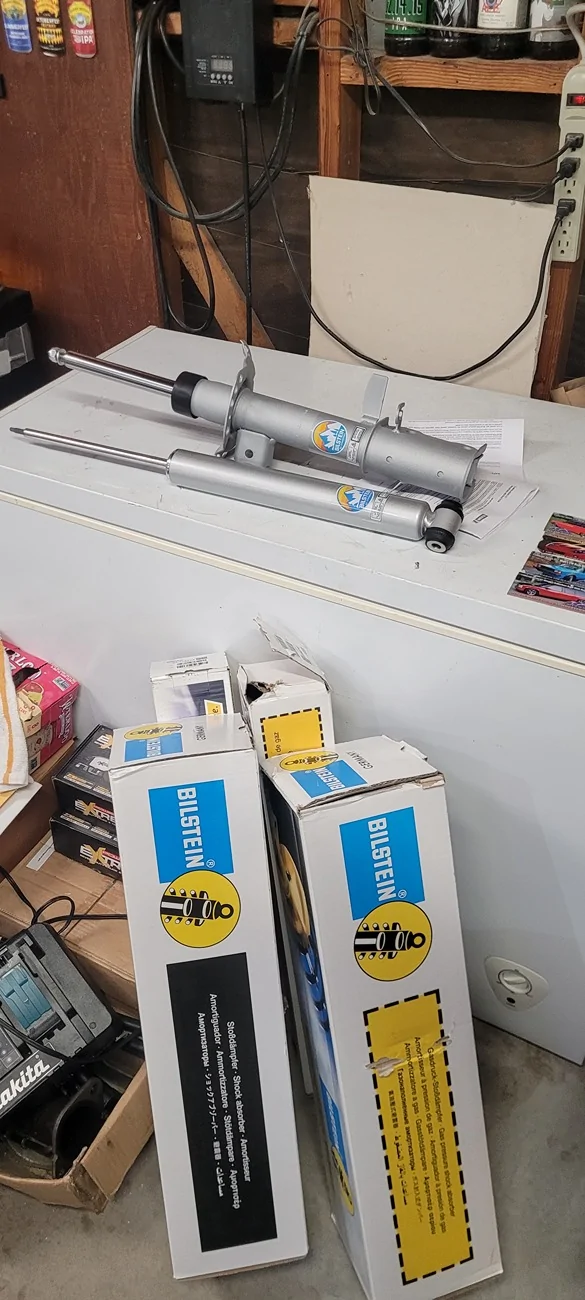

Fronts are in. Not a bad job, two hours start to finish, wish I had started sooner so I could do the rear tonight, but I’m doing them in the morning.
Did you take any measurements with just the front?

I honestly don't mind my current height, it is enough for my needs, but I just wanted the rake gone. The more I look at mine though, I am not sure my rake is enough to mess with it. I might change my mind later, but right now it's not bad. I do like the Bilstein kit though. I had them on my 2019 Ranger that had an adjustable collar for the coil over on the front. Very nice. The broken sway bar tab is a concern though. How much did it raise just the front for you guys that have them?
Originally I wanted to just get rid of the rake but I couldnt find the proper spacer at the time. These B8 terrasports arent too radical but definitely more expensive.
Between the lift and the tires the front is up around 2”
My fuel mileage has gotten worse but that is the only negative effect, I cant say what the exact cause is because the suspension and tires were done at the same time.
Before I got this BSBL I had looked at lifts and tires for all the other potential vehicles I was shopping for, most were more complicated even just to put spacers in and I was never planning to go over 2”. All so I wouldnt get stuck in winter lol, if I want to off road in the dirt I will need to drive a few hours to get there so this for one season and I still managed to get stuck.
Im not concerned about the swaybar tabs but now I cant help looking at them lol.
