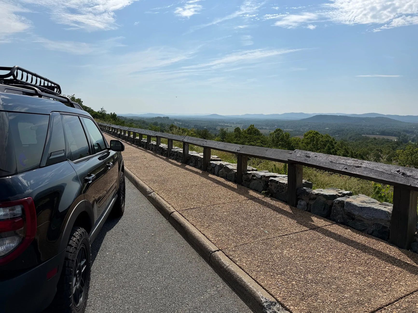

Hi…
I just finish the installation of the new Nomad Wheels on my Bronco.
I also paint the front grill satin black and gloss black letters..
Hope you like…
Cheers

Anyway, in the '70s I loved aftermarket wheels, but these days cars come pretty well equipped. Most aftermarket wheels are just copies of every other...but...these wheels actually look great.
Fantastic choice, well done.

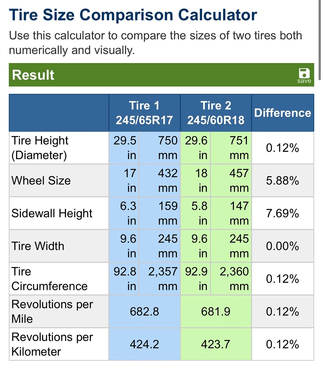

No…
Because the oem 225/65r17 and the new 245/60r18 has exactly the same sidewall. Thats why a choose this set up. My first bronco I use 245/65 on the oem wheel, and felt the car a bit numble since the setup increase too much the sidewall…
Actually, the 245/65/17 has 0.5” more sidewall on top and bottom as compared to a 245/60/18. It’s why they both share a VERY similar overall height. 29.5” vs 29.6” on the 18”

This is something that a lot of people don't get/realize. There is more to tire fitment than a single measurement.
