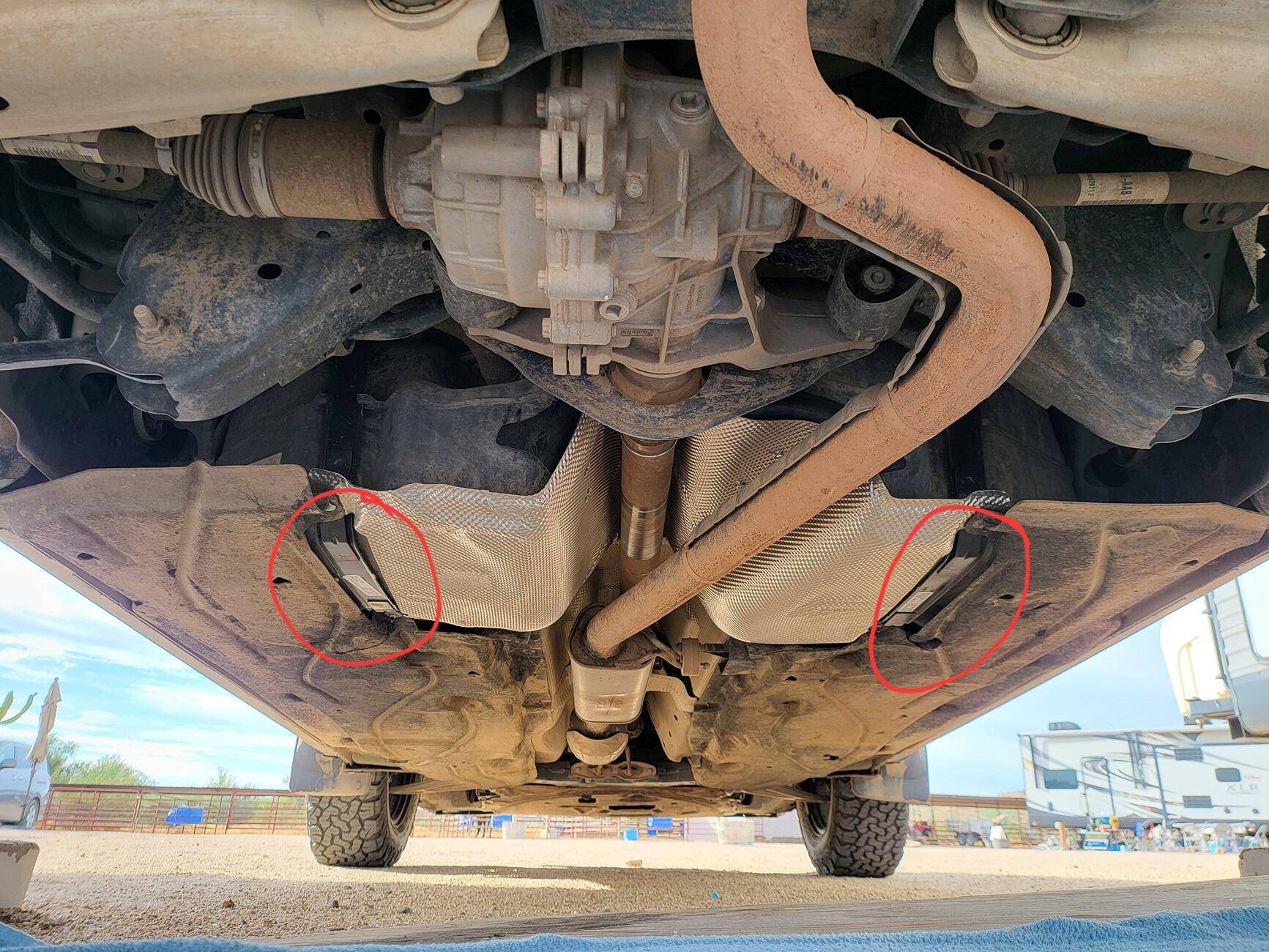

I had a grinding noise after offroading with no plates. Turns out I broke these mounts and the shielding was hanging down and griding against the driveshaft. Ford also told me that they changed the oil in the rear diff because of foreign contaminents before finally coming back and replacing these mounts. It's hard to tell if it's the same noise or not but check and see if there's any scratching on the driveshaft like you see in my pic. After breaking it yet again, because I never learn my lesson. I currently have the shielding held up with zipties and it's been fine for a few months that way.
