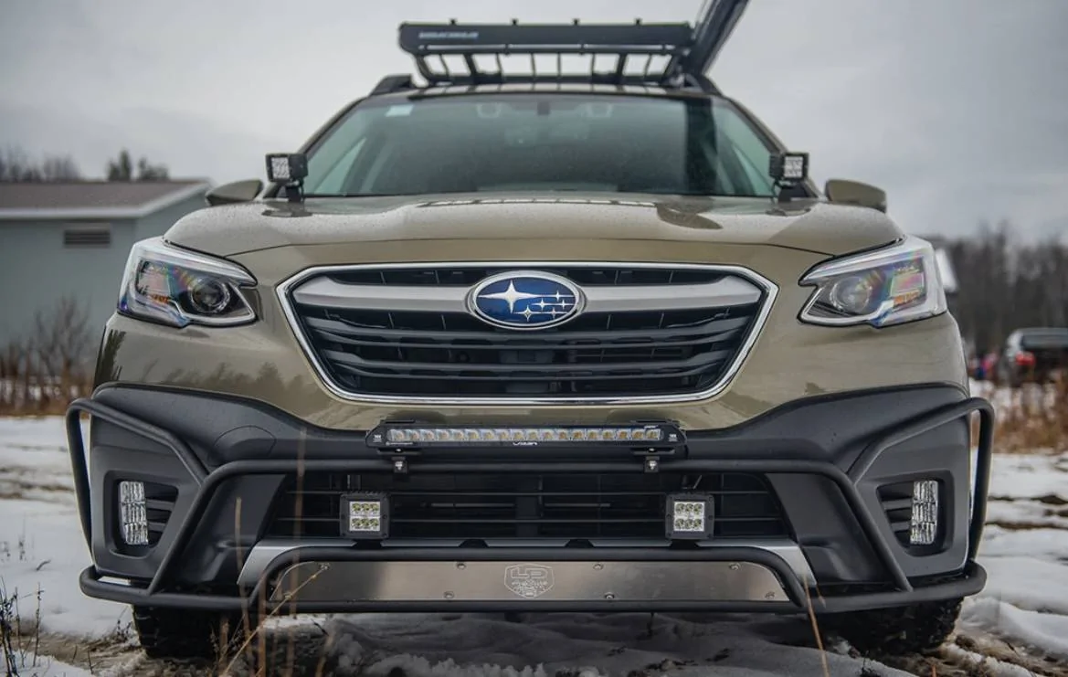

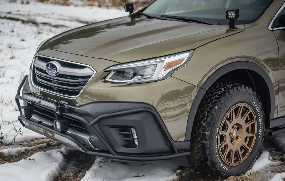

So primitive Racing( pretty much dedicated Subaru rally/overlanding company; i ordered a BS because my forester was totaled) has this apparatus, mounts behind the bumper and replaces the sacrificial crush piece with 3/16 steel(instead of 16 gauge) as well as removes the sacrificial Styrofoam crush pad. Primitive XV Winch & Mount - Primitive Racing (get-primitive.com)
Something utilizing both the recovery points AND the bumper crush pad mounts so you have 4 mount points. would allow a seriously strong mount (for pulling) and distribute a lower speed impact pretty well so it wouldn't cause engine damage. Put the mounting points for winch plate behind the bumper, then drill through the factory bumper to get the bolts through and mount the plate. Since it(in my mind) would be only a single piece of steel (channel iron powder coated that would be 2.5ish feet wide and 1.5ish tall with some mounting plates(all behind bumper), and then a winch plate(in front/visible), and optional extra holes for "deer mitigation devices" that are basically like those push bars on cop cars.
