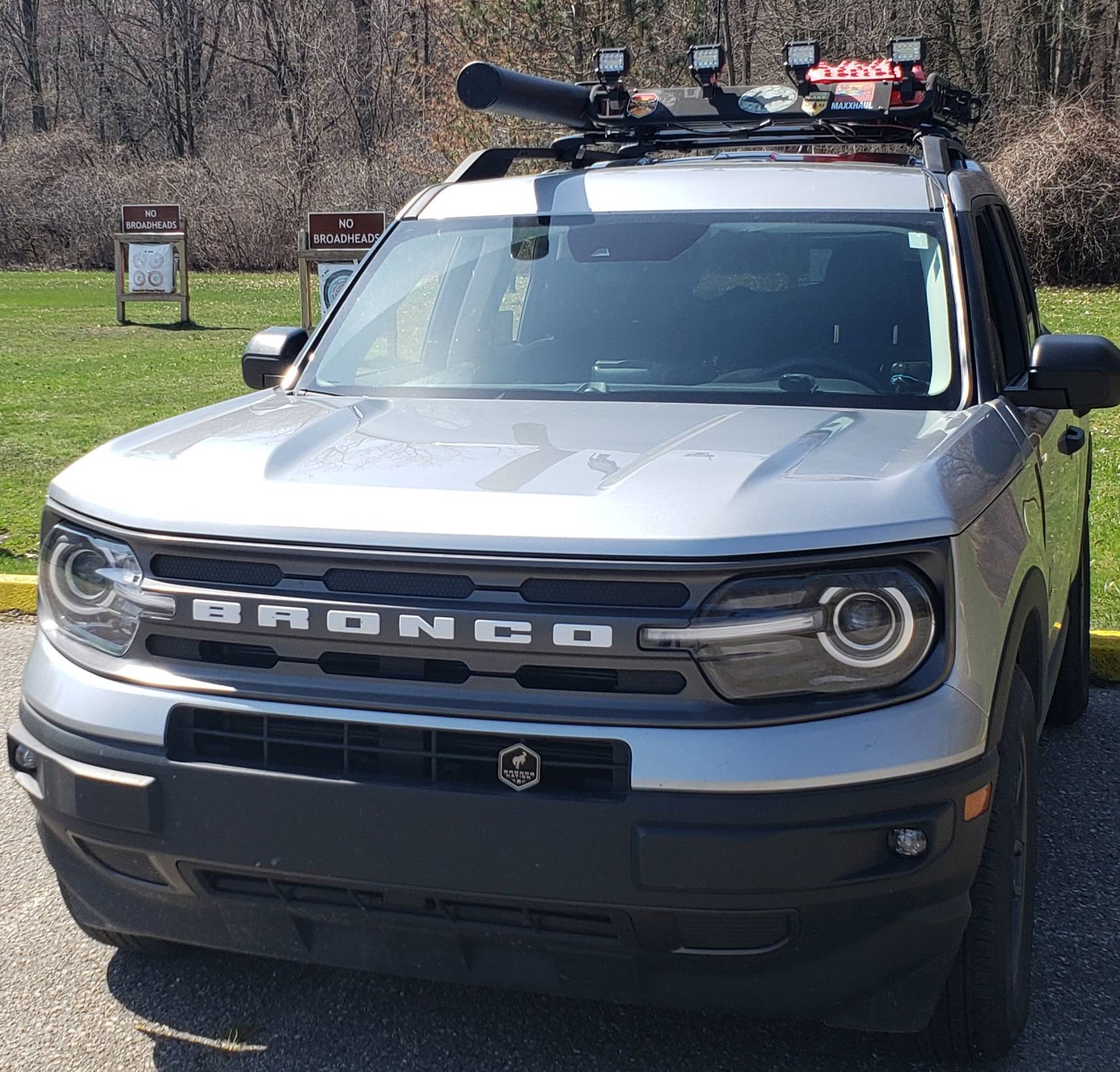

Here is an example.

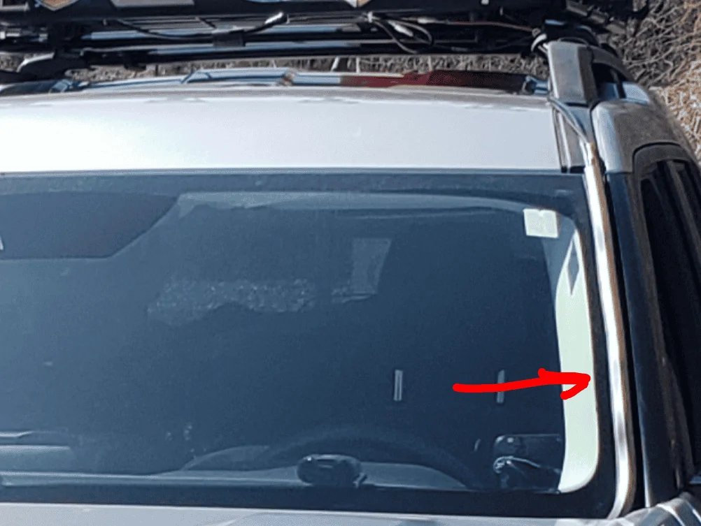

more interested in the exterior routing of roof wiring
very nice approach
eliminates roof penetration
eliminates excessive interior dismantle/re-install
has benefit of temporary use if needed to remove
Question CactusJk?
Did you post this on a previous thread that I missed?

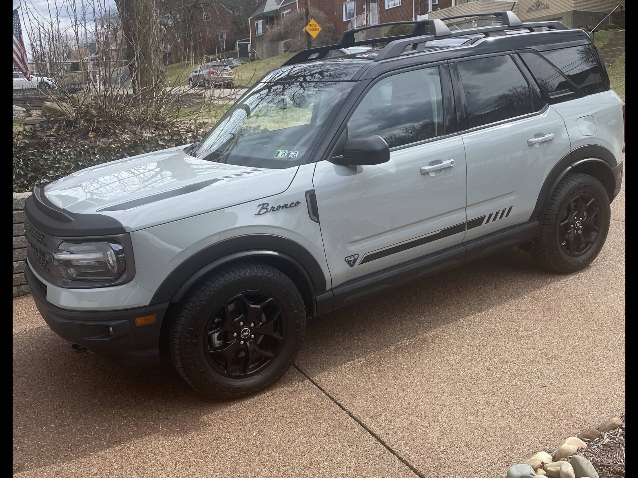

The top right where you have the wires crossed,that cap is removable to run wire down the A pillar , on the inside.

Kind suspected that was the case
but why the big deal on interior dismantle per Ford
"A" pillar route simplifies everything

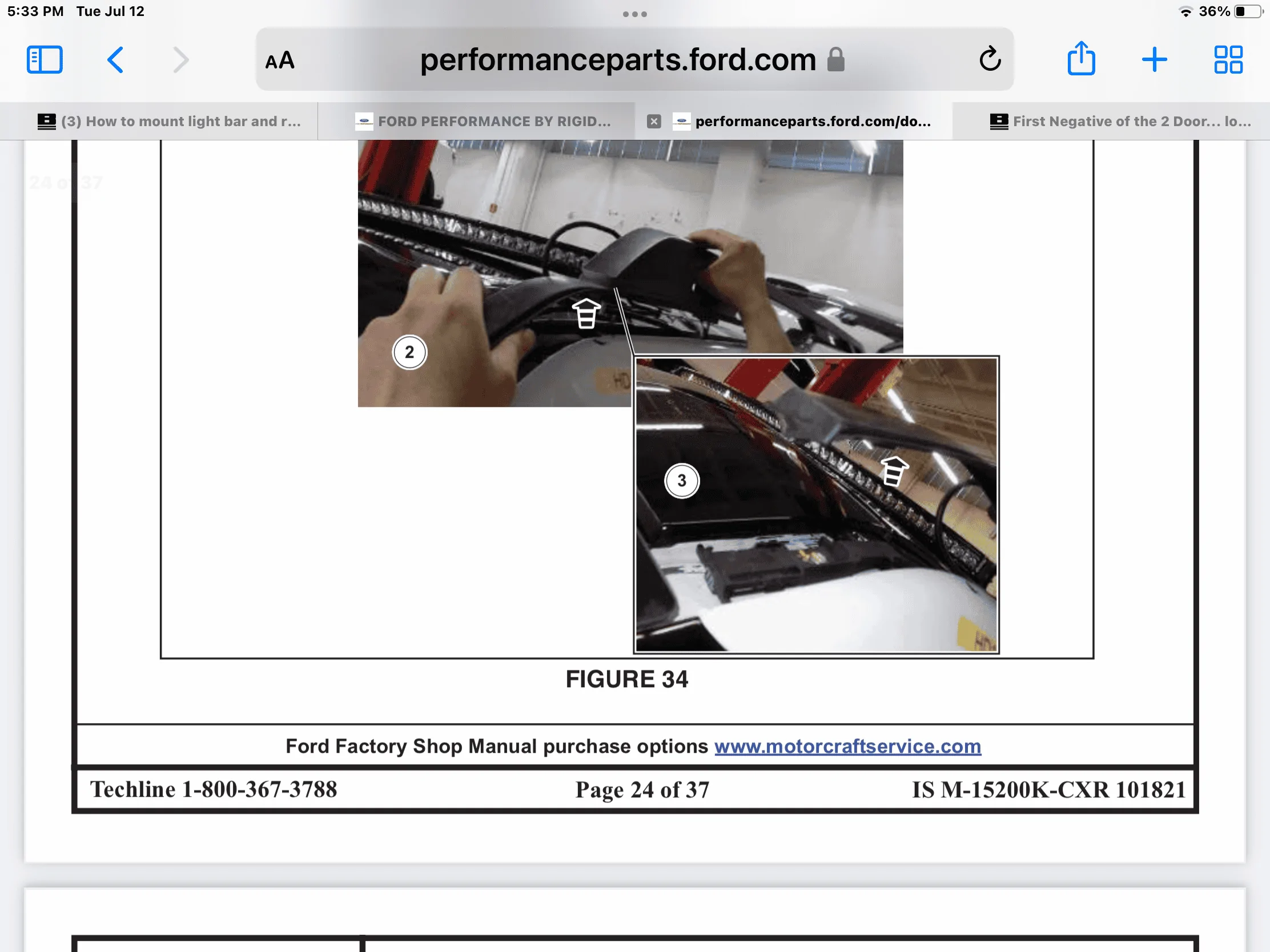

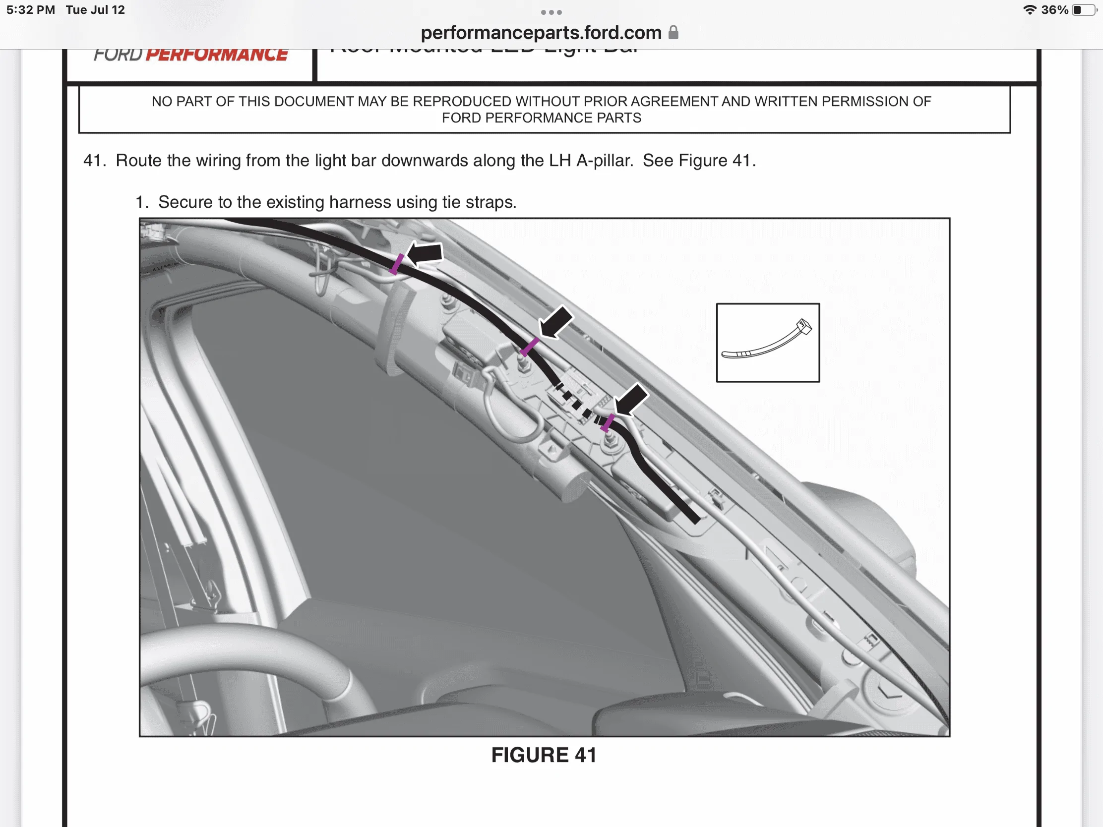

Did you find the instructions, do a search on a pillar light bar .

yep, that's it
https://performanceparts.ford.com/download/instructionsheets/IS_M-15200K-CXR.PDF
just all the steps prior to figure 34 seems a tad overkill
did manage to find the exterior run wire info
"I used the KC Wire Hiding Kit. It runs right along the A-Pillar and it disappears when the beveled edge is put against the window frame. No drilling and no forcing the window gasket or molding."
if I muster up the courage to pull interior trim that's preferred
option no.2 KC wire hide

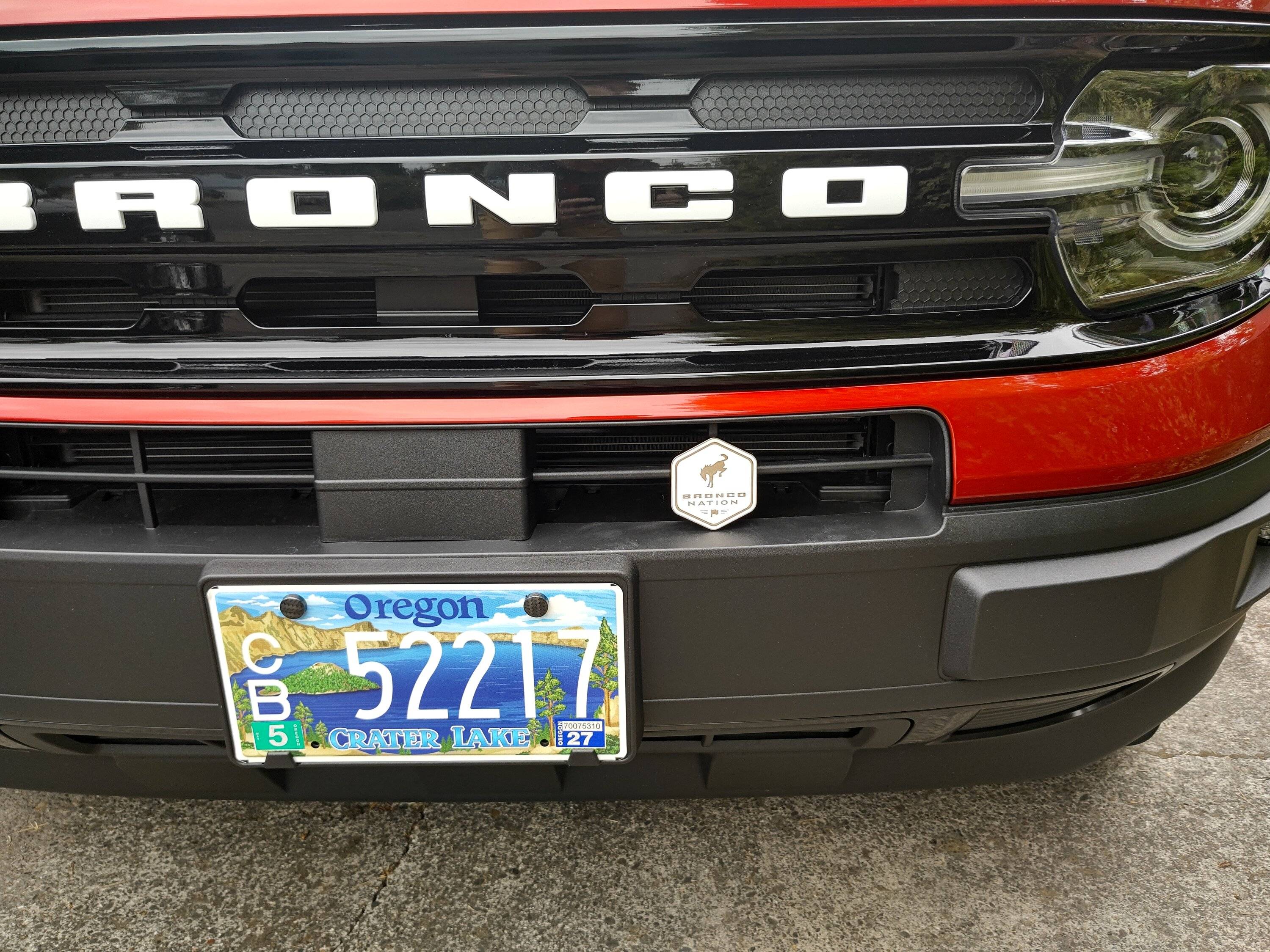

Just mounted this on my OBX:

How'd you get one?
