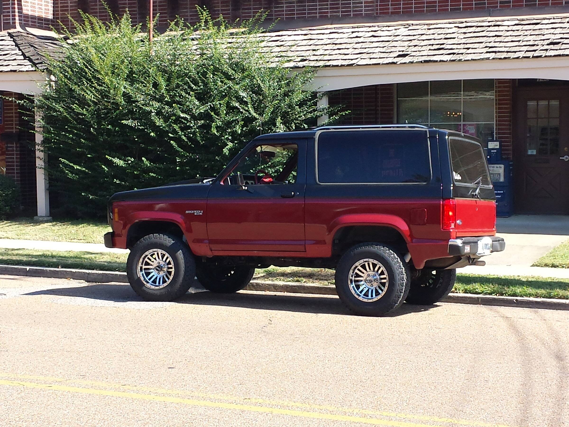

I think the BS technically has more ground clearance than a stock B2 if you measure the B2 at the pumpkins. If you measure at the frame rails of the B2 it will have much more.
I have both in my garage. The BS is of course the far better vehicle, it is about thirty five years newer in design. But the old BII has a soul and when you drive it you feel it.
