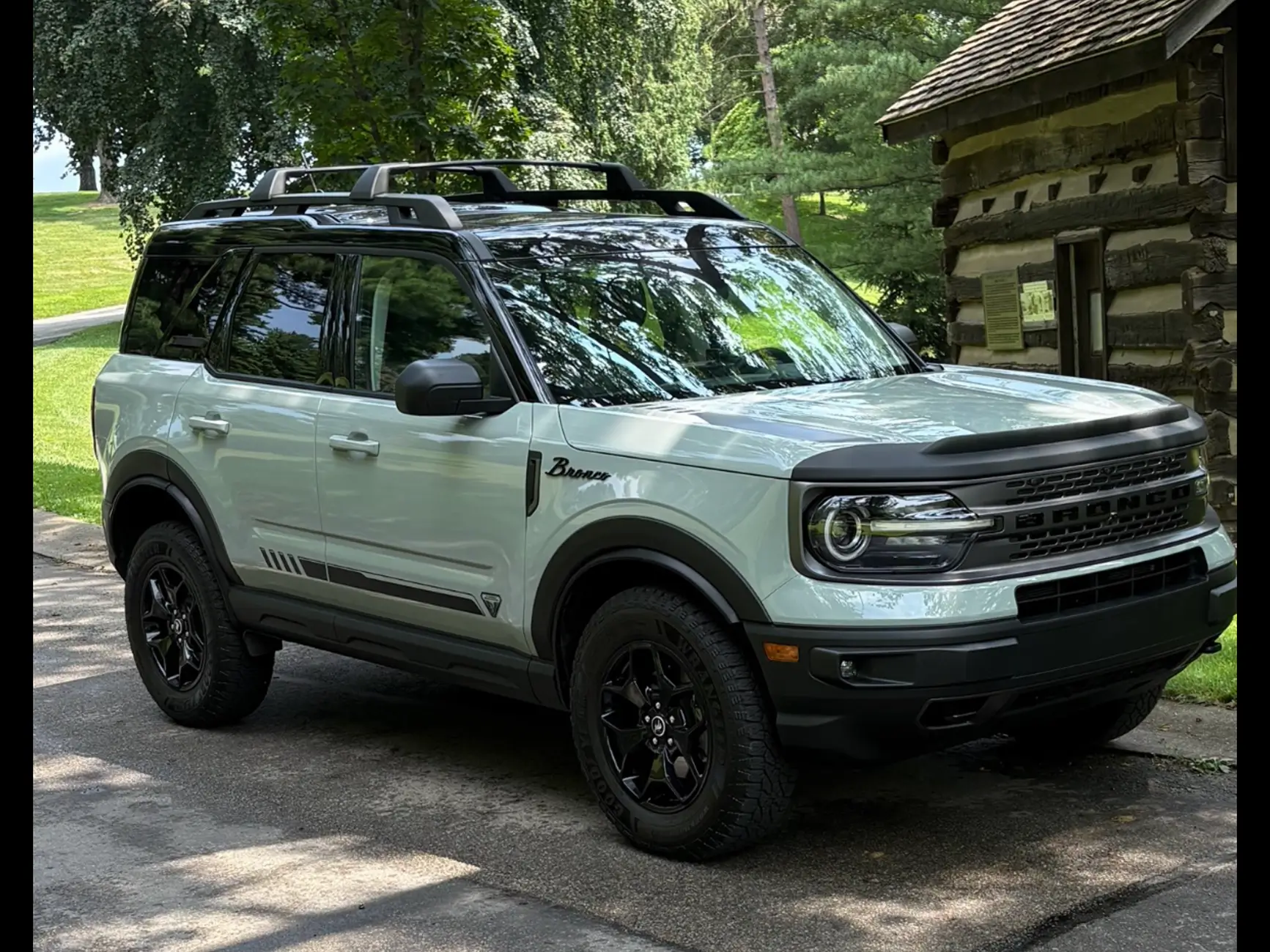

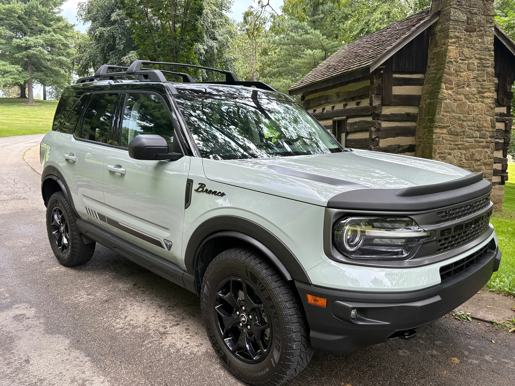

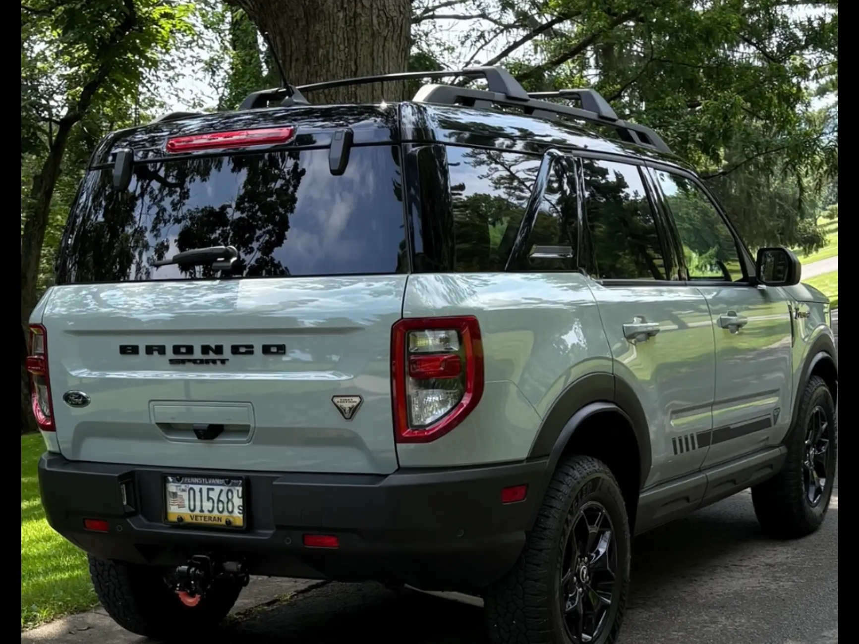

Go with 235/70/17 Goodyear no issues on first edition and badlands, rode them for about year and half with no issues and then I just went with a beltech lift last month.
