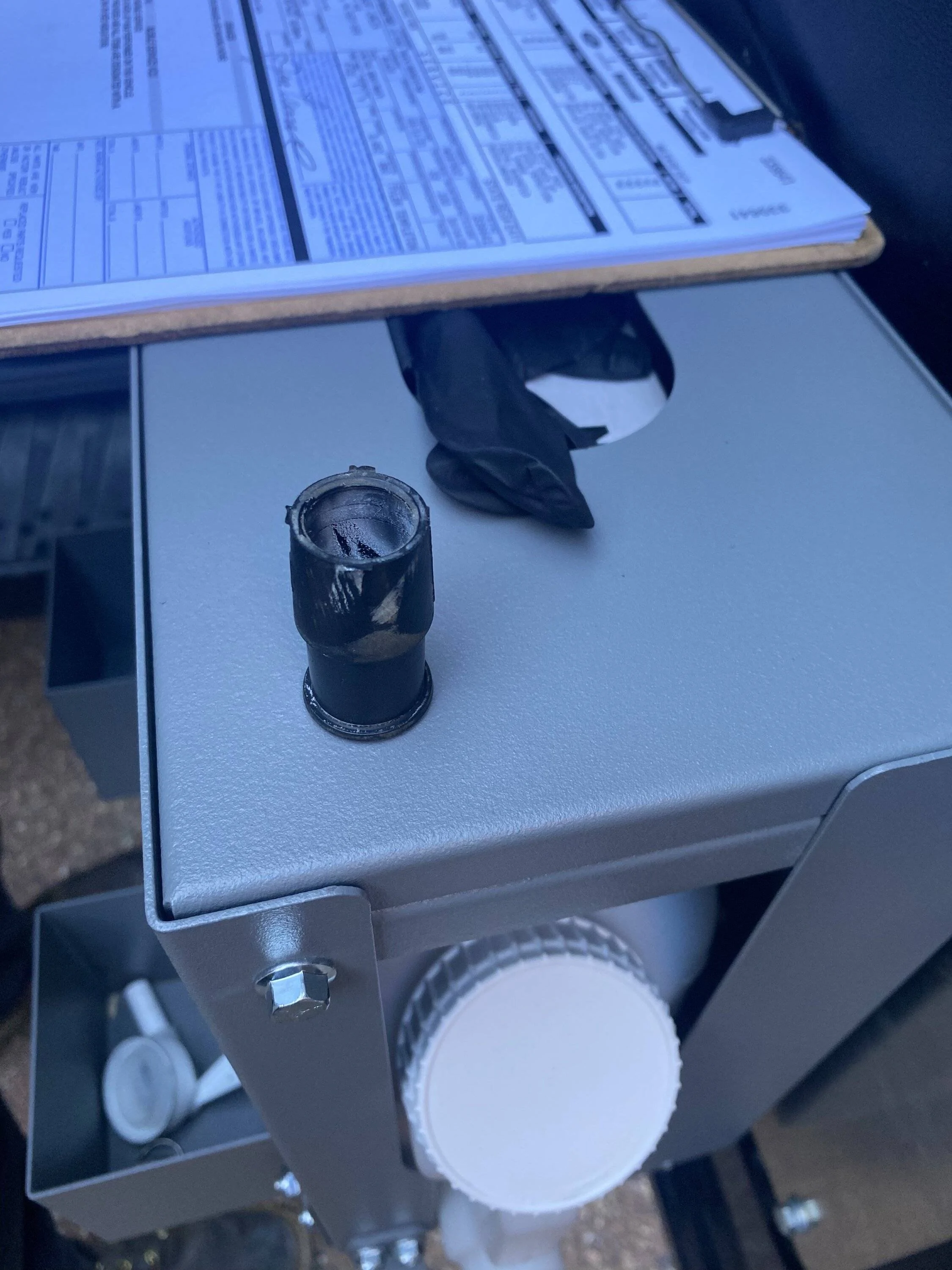

Happens every morning in foggy San Francisco. I’ve already contacted dealer, waiting for response.

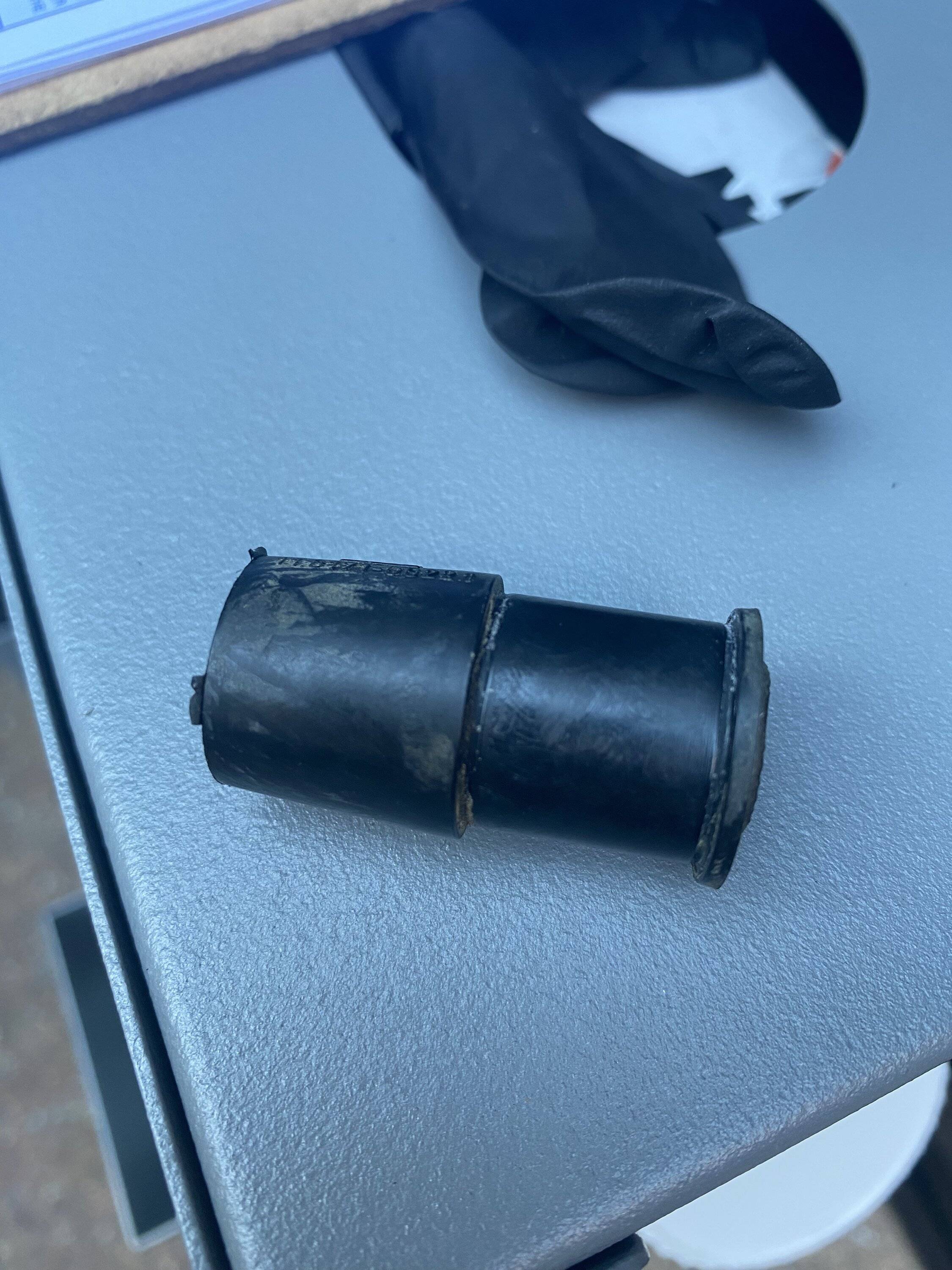

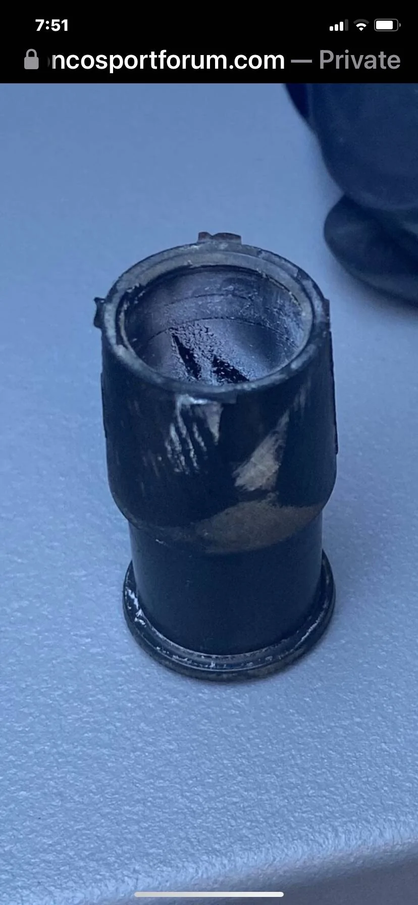

You get best award for sound . I don’t miss it , they came to my house and repaired it in my garage in like 20 min . Real easy . When they took mine apart there was no grease on or in the rubber bushing. I really am thinking they were not greased from factory. pics below

Thanks Jim. I did get a response from the dealer this morning and they did mention TSB, 22-2326. I am over an hour from the dealership, so I will ask for mobile repair.

Actually you can take your bronco to any Ford or Lincoln dealer and have it repaired , not necessarily have to go to selling dealershi . Good luck and enjoy your new ride .

Parts are on indefinite backorder. Like every thing else Ford.

It is a fog horn, which is needed in heavy fog. I kind of like that sound, but mine hasn't made it yet.

I made an appointment for the TSB on 12/1, but I just got a call back from the dealership parts are back ordered till 12/31, just as everyone has been posting. :((
