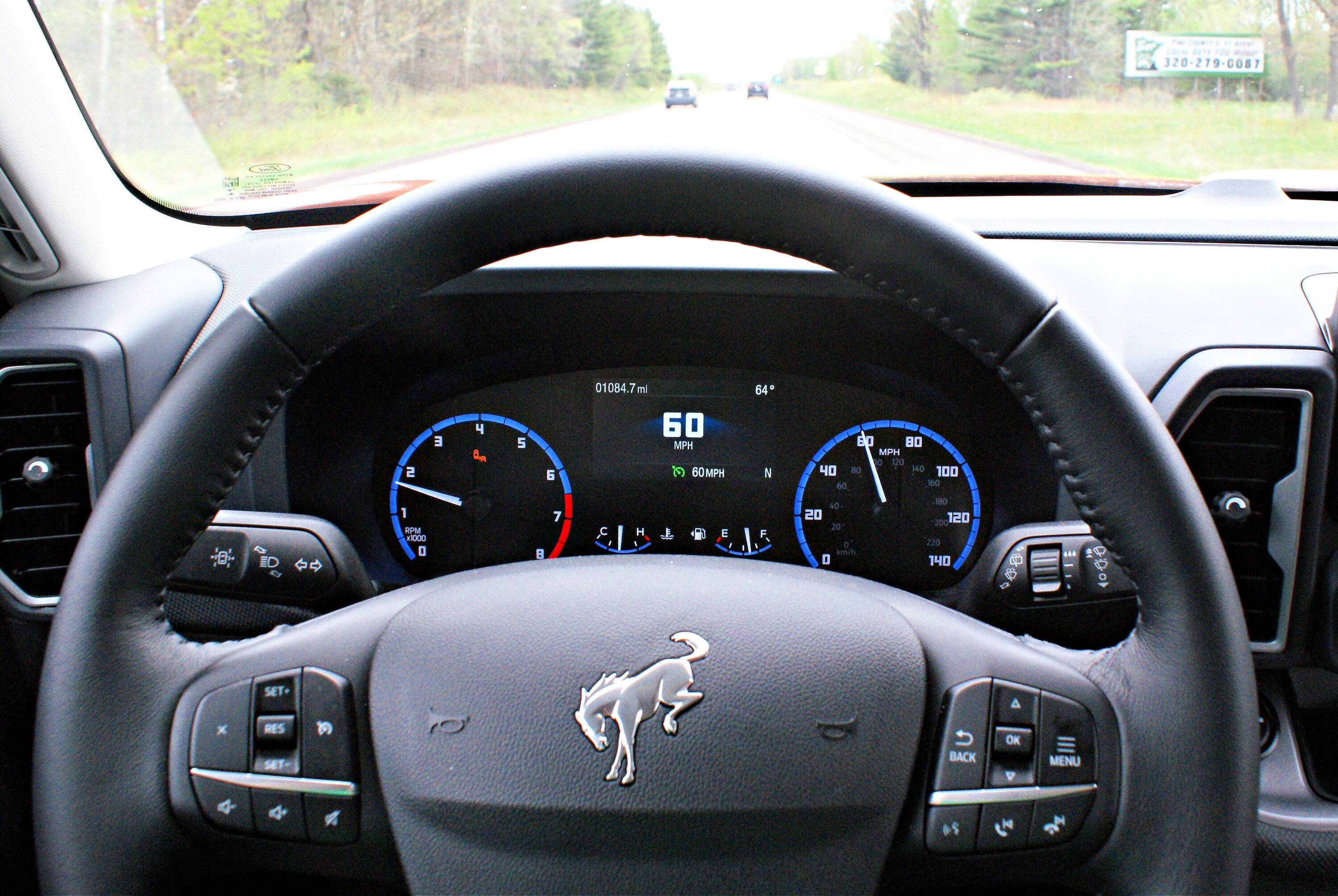

I've used the 'Big Bend' twice towing round trip 460 miles using 'Normal' mode. I was pulling max weight of 2000 pounds, 60 mph, and the tach stayed around 1700RPM on flat freeway. The big test was Duluth Minnesota with the long steep hill (south side) coming into and return leaving Duluth. I stayed in normal mode and the Bronco Sport handled fine. Think I lightly tapped brakes a couple times going downhill to stay under 50mph. Coming back up the hill I stayed just under 50mph too and transmission acted just like all my F150's I've owned the past 40 years taking on that 2 mile hill. It shifted when it should have and maintained 'normal' rpm I thought.
