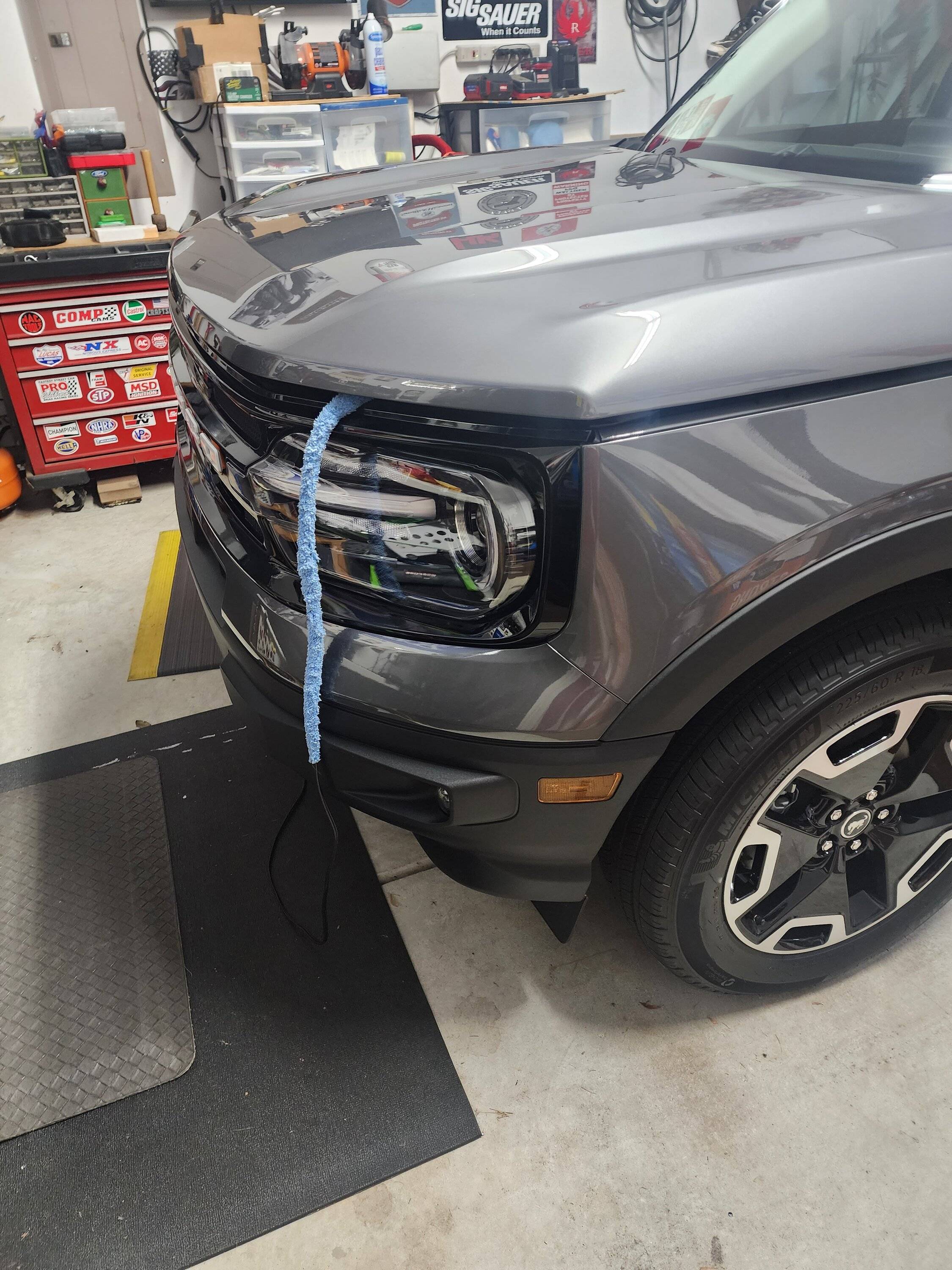

Deltran Battery Tender Plus brand battery maintainer for over 20 years. Used one on a show '69 Corvette for many years and use one now on the BS.
Ford Bronco Sport Battery Tender 20230811_152009

I’ve used multiple Battery Tender Jr’s on a multitude of vehicles for 20-25 years. Never an issue. Maybe I’m just lucky!
