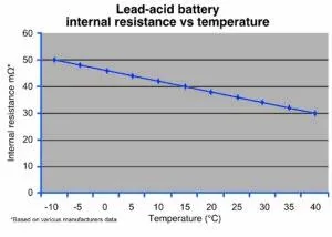

Also low temperatures correlate with lower resistance.

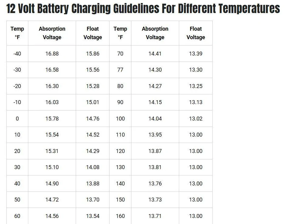

Ford Bronco Sport Battery charging voltage question in cold temperature? 1734217305761-n
That's why the lower the temp, the higher the charging voltage must be

Looking at the chart the charging voltage of 15.10 at 30 degrees means that my Bronco Sport is operating normally. Thank you everyone for your responses. :)
